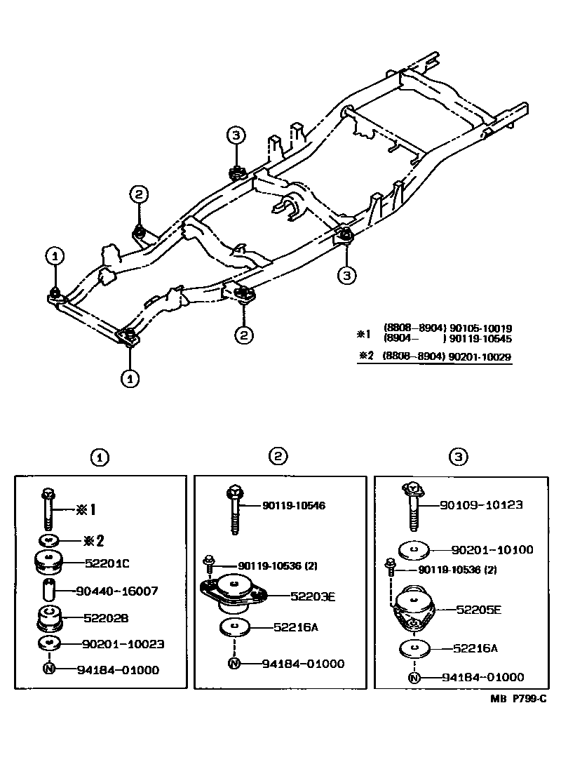

here's a parts diagram showing the body mounts and all the hardware. i assume you're looking for #1
The two actual rubber mounts( 52201C and 52202B) are 52202-35050 and 52201-35050
Both show discontinued. I dealt with a similar obstacle on my 1987 RN6#, but eventually found oem rubber mounts that worked. So you can get Toyota ones if you hunt around and order a similar one under a different part number. I had originally installed poly bushings and absolutely hated them, made the truck ride so hard i was afraid they'd crack the floorpan.
edit: If you Google the part number I listed you will find a few sources claiming they can get that part number. Sites like Carmarka, Yoshiparts, etc. They can't. They'll accept your order, then cancel and refund a few days later. Once Toyota in Japan marks something discontinued it's a dead part number. You'll need to either find one off another Toyota that's similar and still available, or aftermarket.
I imagine the bolt hole in most Toyota truck mounts are close to the same, And the outer dimension probably can handle some variance. The big deal would be the height, and one too tall can easily be shaved down.

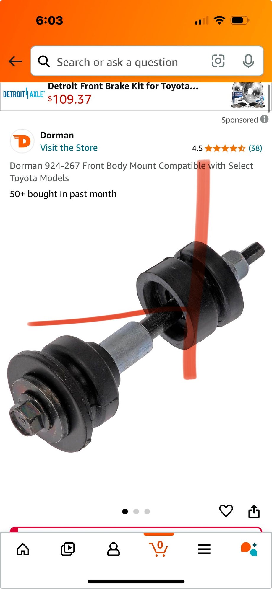

I see Dorman has some on Amazon that might work, and they appear to be rubber.
I spent ages looking and researching rubber mounts for mine, but that's because I was deadset on getting the poly ones off my 4R. I was really happy i spent the effort, the rubber really made a huge improvement in ride quality over the poly. But some people just don't care and think poly is the greatest.

As Jim said, these are on Amazon. 2WD vs 4WD ?, but rubber and I’d bet will work great. I may snag these for my 95 4WD. Poly are terrible. My CSF 3 core radiator was just slightly touching my frame there in the front, so I went to poly years back. It enabled the space I needed with my ARB bumper weight, but I hate them. You get new hardware here too, if desired. I’m currently searching for the four cab mounts for myself in hopes that I can keep poly at the core support and rubber/silicone at the cab mounts. IDK
