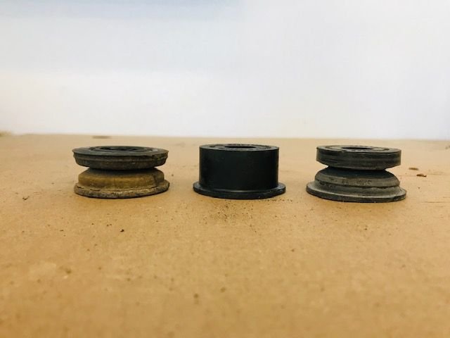

Hi all,
I have been wanting to replace the body bushings on my 4Runner for some time now. I replaced the bushings on a previous 4Runner with poly and I did not like the amount of noise and vibration they transmitted. I priced the bushings from Toyota and it was around $300 to $400 with shipping from multiple sources since no one had all of the bushings. That was outrageous. I happened to come across a post in the ih8mud forums and found a solution. Credit goes to liveoak on ih8mud for providing this information. Here is the thread post: https://forum.ih8mud.com/threads/hel...ounts.1127849/

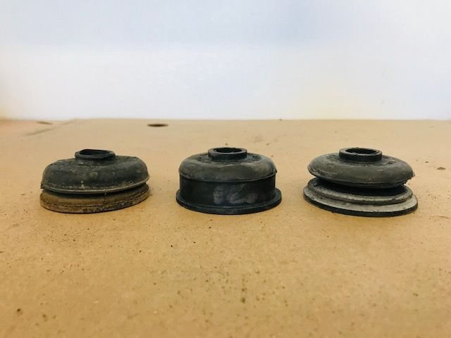

I contacted the seller and ordered the parts. It came out to around $80 including shipping from Thailand. The rubber durometer is definitely harder than the OEM bushings and they do not have the same profile. I put them in my drill press for a makeshift lathe and turned them to replicate the original profile.
Here are some photos of the bushings, from left to right; old OEM, new replacement, new replacement modified.
I do not know if the modification helped or not, but it made me feel better about the firmness of the new bushings. They installed just like the originals, but they did lift the body about a quarter inch. It may be from the old bushings being so compressed.
The driving impressions are pretty good. I thought it would reduce small vibrations, but it was about the same as the old bushings. There really has not been much change, good nor bad. Off road there has been a little less vibration. I think these are a good replacement even for the guys who would go to poly bushings, just use them without modifying them. The increased hardness and total lack of harshness would be a good alternative to the poly bushings.
I am glad that I finally replaced the bushings, my old ones were beginning to crack and split. The originals were about 33 years old, so they did their job. I think these are a good replacement for the price.
