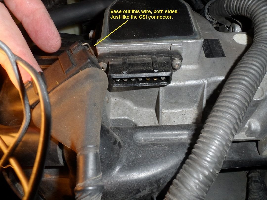

And just in case no one has mentioned this to you:
