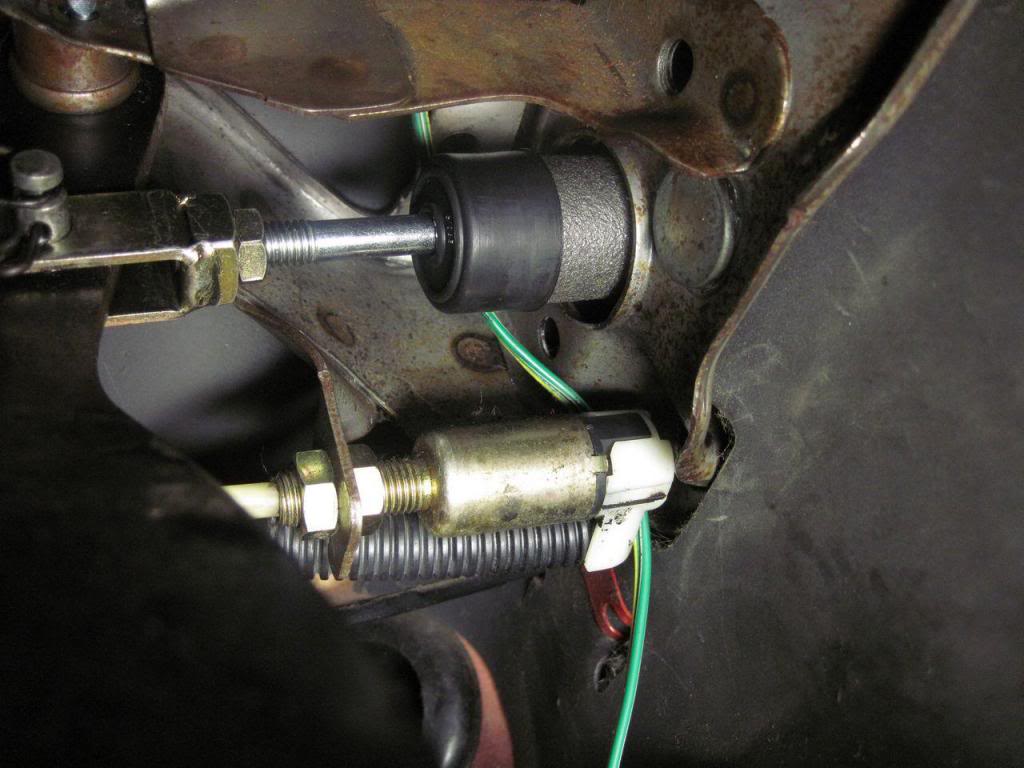

Pic of clutch safety switch... IGNORE GREEN WIRES (Those are my speaker wires - LOL!)
