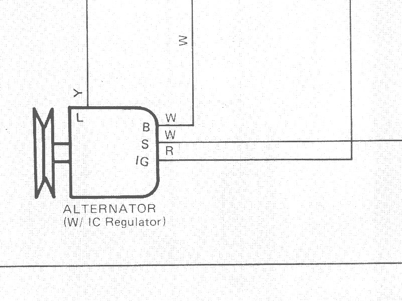

You need to be more detailed; We may be thousands of miles away from you.
Where did you measure 12V? Anyway, Exactly 12.0 Volts is too low. Got picture of that wire? There should be no "little wire" on that bolt on the alternator, only a thick white wire.
You need to measure voltages at the connector, too.
What do you measure at "L" at "IG" at "S".
