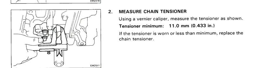

Pull your valve cover and inspect the valve timing, and distributor gear.. crank key way at twelve, and timing mark lines up at zero, cam dowel at twelve. While you're there look at the tensioner head and make sure it's still attached to the shaft at least, there is a wear limit which you won't be able to eyeball but having it detach will be an obvious sign it's time to change out the front side parts.

the head on the chain tensioner.. the pyramid shaped object measured in this diagram.
