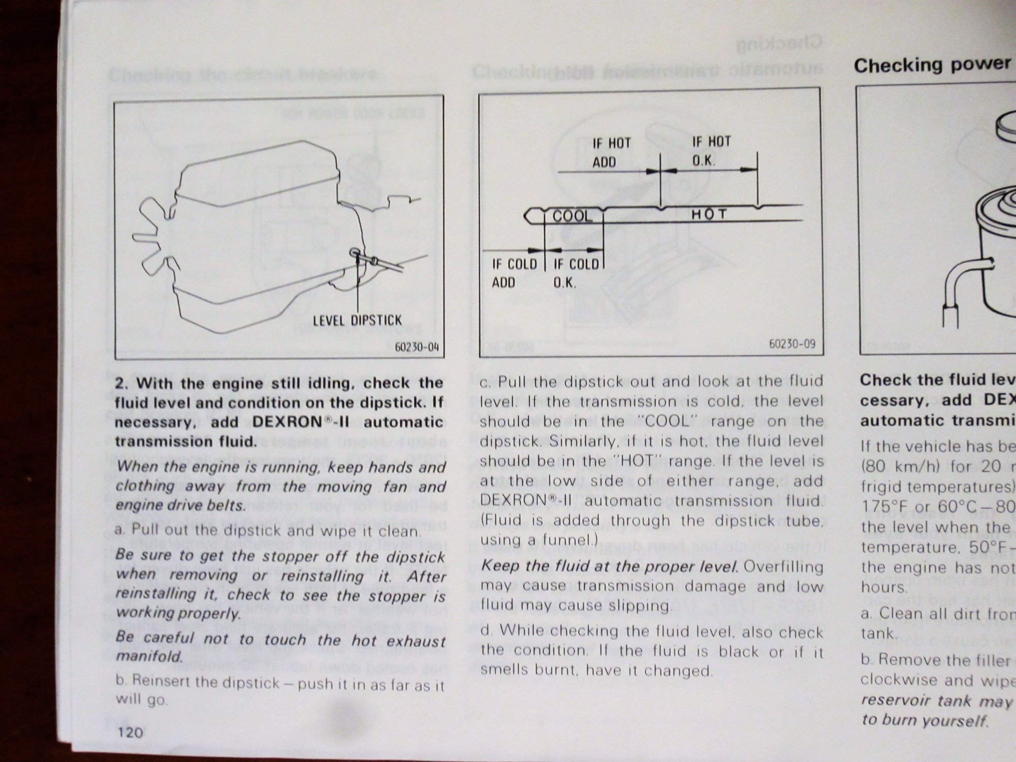

Should the engine be running or Not running when checking Auto Transmission fluid levels ?

running, and after having driven it enough to get the transmission warmed up.

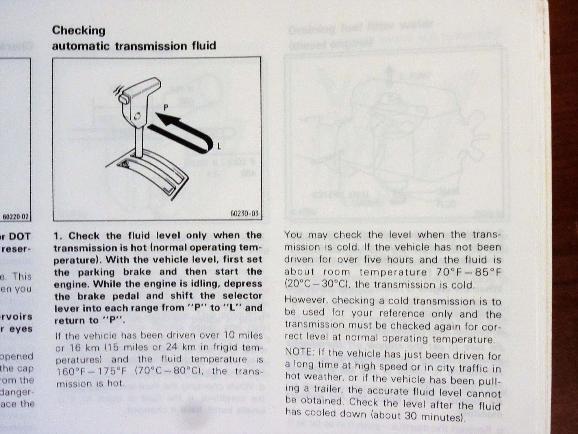

The engine should be running and the transmission should be hot, per my 1987 Toyota Truck Owner's Manual (2WD Version):
