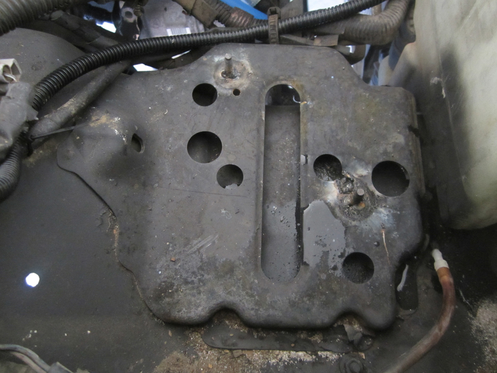

Obviously to mount the box you have to remove the battery and hopefully the tray is not corroded to nothing like mine was from years of acid leaking on it apparently. The one I am working on now is in good shape. To start, I welded a couple of bolts from underneath to serve as studs to accept the airbox and keep it secure. If you do not have a welder, you could leave the bolts in there loose and cinch them up when you tighten the box down. You can see on the one in the bottom of the picture I had to cut a slit in the metal to allow the bolt to slide in and to the hole and then weld it back up.

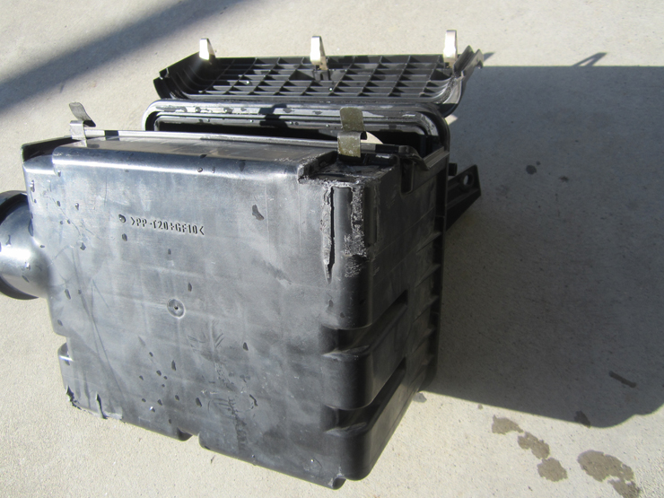

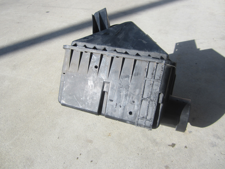

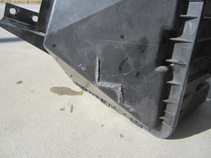

Then the box itself has to be modified a bit. The stock tabs will be cut off. You can use the front, lower tab as a mount if you want (I did on mine) but the other two I have cut off on both swaps that I have done. Be careful not to cut/grind through the box obviously. You can see here that the tabs have been removed by my trusty Harbor Freight body saw. Best $18 ever!! You will notice in the last picture that I also drilled two hole to receive the studs that I welded on earlier.
The box should flex a little so I remove the stock rubber grommets from the 3.4 airbox and put them on the studs before dropping the box on to provide for a little cushion and for it to flex a little.

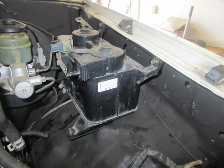

Mounting the EVAP Box:
This is nothing really special and I am nothing of a metal fabricator. This was made from a piece of angle iron that I had laying around probably from an old bed frame that someone was tossing and I grabbed one day. You can buy small pieces of angle iron at Lowes or Home Depot for a few bucks. I first cut the piece wrong and had to reweld it back in cause I didn't have anymore and didn't feel like making a run to the store so that's why there is a patch in these pictures. The piece will have to be cut out to fit around the bolts and holds the rubber bumper for the hood. Once you get that relief notched out just mark your piece and drill the holes for the flanges on the box the bolt into. Again, I welded nuts on the back but if you do not have a welder, you could just use nuts and bolts just as well. The only semi-tricky thing is that the ears on the top of the box to mount it at set at different angles to accommodate the Tacoma, or Runner's, inner fender. This means that you will have to bend each tab to match that angle. I just mounted the bracket and slipped a crescent wrench over the tabs and bent them a little until the box mated to it well. The bottom has to be supported or the ears on the box will break eventually. A simple bracket is used to support it. There is already a threaded hole in the inner fender to make it easy.

Installed and hooked up.

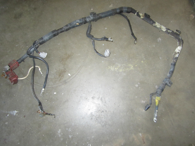

The Battery Harness:
The battery harness runs from the starter around the oil pan and up to the battery. In its stock form, we do not need everything contained in there so disassemble it to simplify it.
This is what it looks like stock.

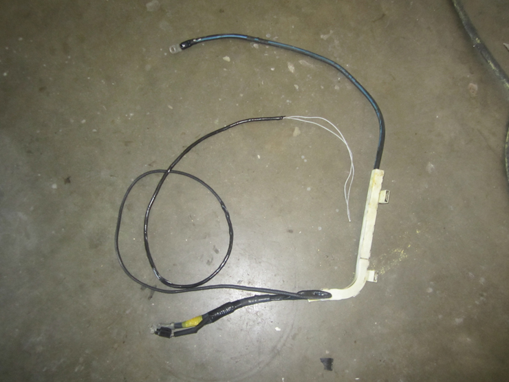

There isn't much that is going to get your hands more filthy that this harness and the process of taking it apart. There are years of old oil, road grime, and now taking apart wires covered in old black tape. I would suggest just slicing through the split loom with a razor knife and splitting it open like a fish and pulling everything out. Do not throw anything away but, all you really need is the large battery cable to the starter and the smaller starter trigger wire.
The large cable is what feeds the battery the power to crank the motor and the trigger wire engages the solenoid (kind of a large relay which I will get into later). The 3.4 harness has no starter wire in it so one has to be ran for the vehicle to start. It will run with the 3.4 harness into the cab so that it is protected in the same loom and ends in the passenger kick panel where it is needed.

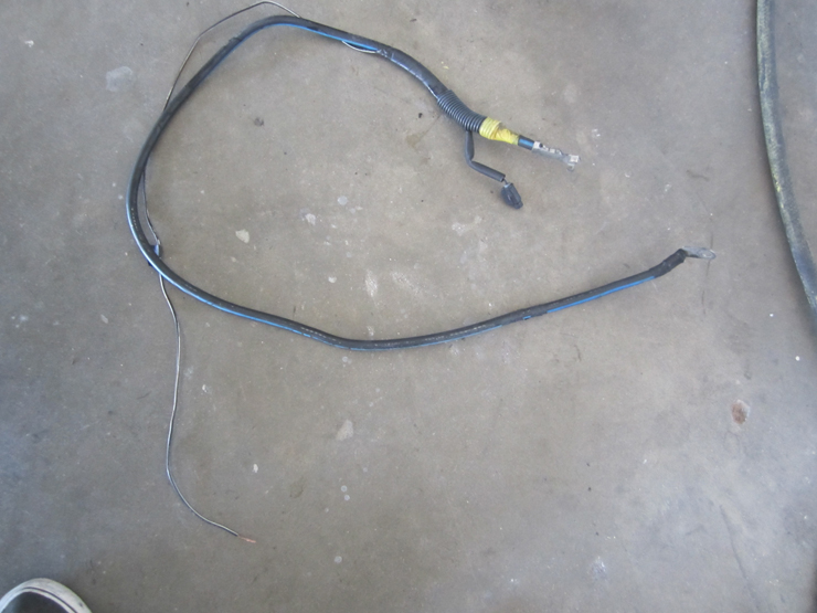

When everything else is stripped out of the battery harness, this is what is needed. Just the cable and the trigger wire.
The ground cable can be reused but an upgrade isn't a bad thing. The alternator plug will also be reused if you are running the 3.4 alternator and spliced onto the 3.0 alternator wiring. To wire the 3.4 alternator to the 3.0 harness in the vehicle, just match the three wire colors together and that is it.
The 3.4 motor harness does not have a provision for the starter wire. So for the starter to operate correctly when the key is turned, one needs to be ran into the cab from the starter. This should be setup now while you are working on the battery harness. To run the wire into the cab, it first needs to be extended about 4-5ft. 14ga. wire is enough, but you could also double up a smaller gauge wire if that is all you have, or if you are scavenging wire for your swap donor. If you are doubling up smaller wire, a trick is to put one end of each length in a vise or secured similarly, put the other ends both in your drill and start the drill to twist the wires together for a cleaner install. Tape everything up after that to protect the wire and keep the factory look.

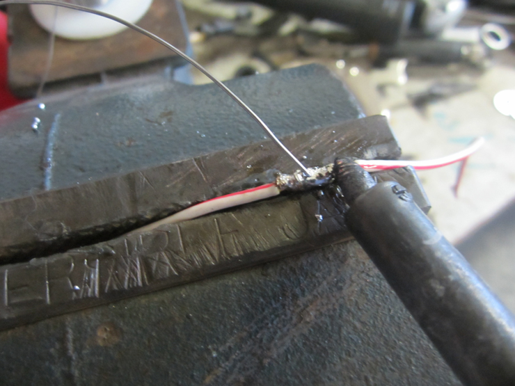

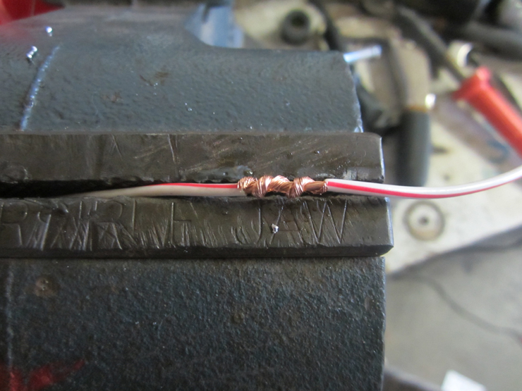

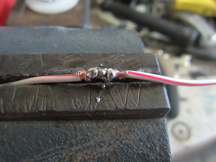

I'll go over how to CORRECTLY solder wires together.
First, you are going to need a decent soldering gun or pencil. Anything will work, but I prefer my Weller pencil tip. This will get any of the wires involved in the swap hot enough to solder correctly. Anything smaller and you may have a difficult time achieving sufficient penetration to ensure a solid connection. Another tip is that the tip will get a coating of oxide on it over time. Have a damp sponge handy and rub the tip on it after each use. the will endure a hot surface each time you need to apply heat. Alternatively, I often use a small wire wheel on my cordless drill and give the tip a few second with the wheel when it is not heating the wire effectively due to oxide buildup.
First, you want to strip about 1/4"-1/2" of the insulation back and join the wires together. If you are extending a wire, they should mate parallel to each like this.
Soldering is much like welding in that you have to have the solder penetrate the wire to make a good joint. This requires heat and a good flow to the wire. It is important to realize that anytime you solder something, you do NOT use the soldering iron to melt the solder; you use the gun to heat the wire to a point where the WIRE can melt the solder. This will allow the solder to flow through the stands of the wire and make a solid connection. Many people will put the tip on the wire and start applying the solder where the tip is meeting the wire. This will usually result in poor connections that will fail in time. This is what poor penetration looks like.
Again, the proper way is to heat the wire and allow that to be hot enough to melt the solder. To do this, the tip should be about 1/4" away from where you are applying the solder to the wire when using a pencil type gun.

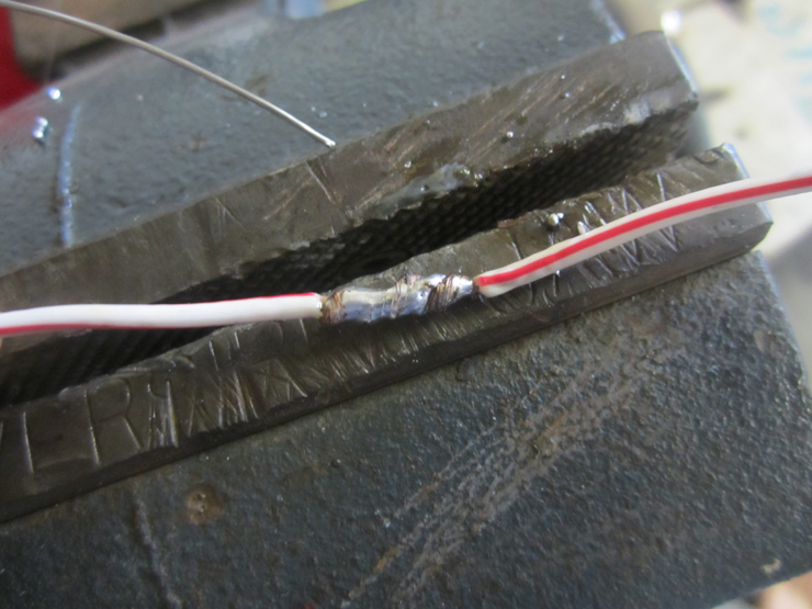

Apply the solder slowly, allowing it to melt and start to flow throughout the strands. A good joint will show good penetration on EVERY side. Not just the side you were working on like the picture that is two above this. Here is a well soldered joint ready to install that will last longer than the truck will. It will look like this on any side as I rotate it. Don't forget to add some heat shrink tubing over the joint.

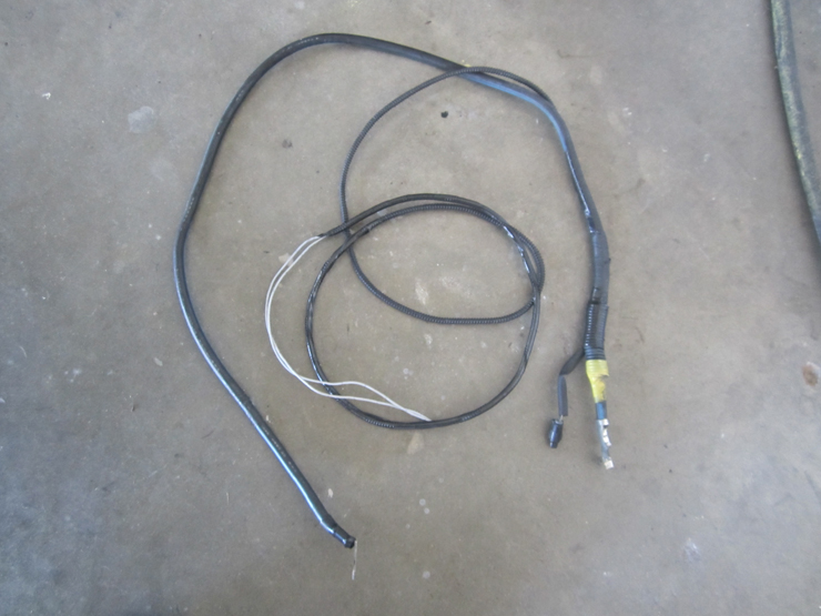

Going back to the starter harness, the only wires that are needed to make the vehicle start are the large battery cable that will run over to the battery, and the trigger wire that will eventually pass through the firewall with the 3.4 main harness. This is a shot all taped up and ready in go. Much simpler.

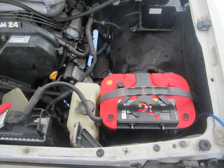

Battery Relocation and Wiring:

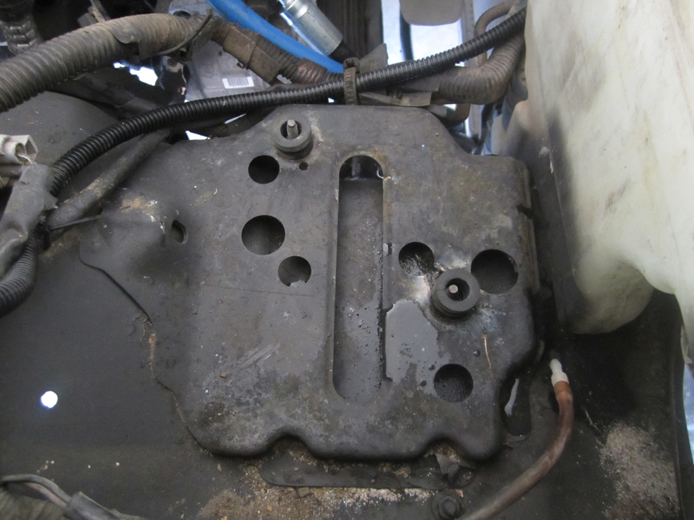

The battery will have to be moved to the driver's side to allow the airbox to be mounted. Again, there a many ways to do this. You could use a battery box that is mounted securely, or use something as simple as a tie strap or bungee cord. I recommend the box and mounting it securely. Do it right.
There are a variety of companies that sell premade boxes and some that are designed for specific batteries such as an Optima. Ballistic Fab and Trail Gear both make one. I have the Ballistic and just installed the Trail Gear one in another swap. the Ballistic is a much better piece. It was heavier, had more mounting options and fit the battery better. Both used Optima 34/78 batteries. Regardless, the principals are the same. Make the battery secure! A battery is a LOT of weight to be anything less.

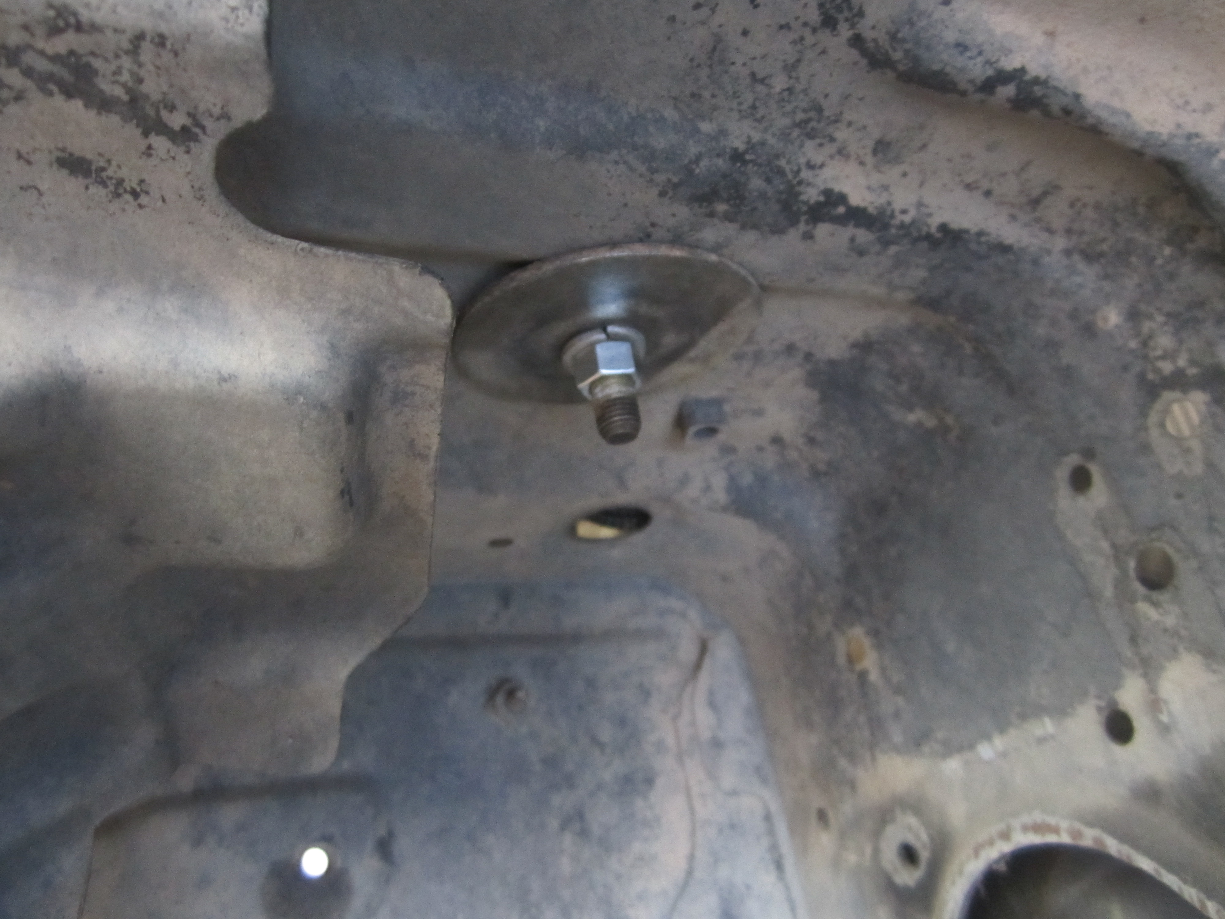

The inner fender shelf that it will locate too is fairly level as is but does have a slight slope towards the motor. Just enough to make things look "off" without some shimming on the motor side. A simple washer under the middle bolt in the picture was enough to achieve the battery sitting at level. The Optima has recesses in the bottom of it so the bolts have to be placed so the battery is not sitting on the bolts and instead, the bolts are in the recesses on the bottom of the battery. Just takes a few minutes or lining things up and making some marks.
Here is the battery with the bolts ran through the inner fender well.
Putting nuts on the bolts in the fender well would mean over time the metal of the fender would eventually rip or tear with stress. To distribute the weight, and keep this from happening, a large washer, or piece of metal should be used. This will keep everything solid. The other one is under the plastic in this picture but both bolts received large washers.

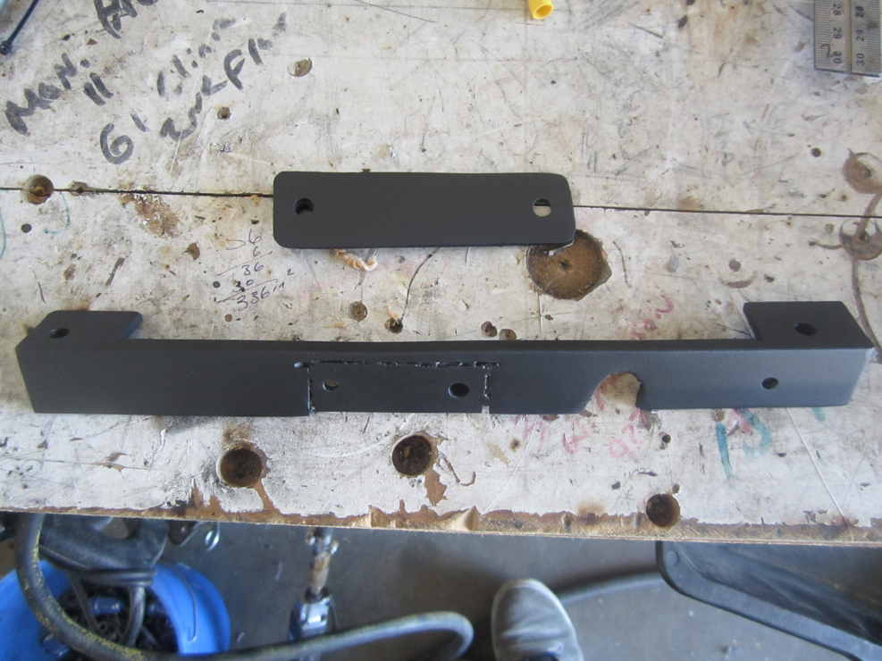

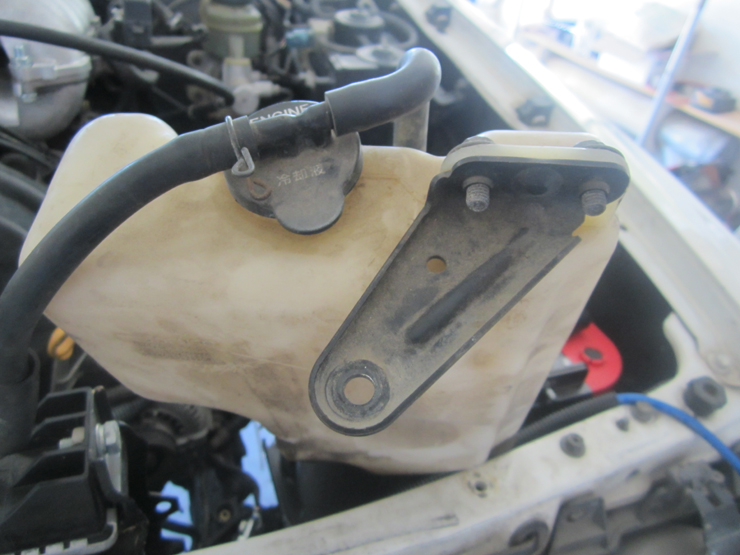

Now that the battery is in and solid, the coolant overflow will not fit. That will also have to be modified and everything will fit like it was designed that way. First, you need to remove the bracket and reinstall it on the other side.
Place the tank and bracket in the opening between the radiator and the battery and mark a spot to drill a hole in the core support. I welded a nut on the bottom of the bracket but again, you could use a bolt by hand. The lip on the edges of the bracket will not allow the bottle to sit flush so use some washers between the top of the bracket and the bottom of the core support as a shim or spacer to make sure you can tighten it enough and the bottom doesn't want to start to tilt.
I also used my body saw to slice a groove in the metal to sit in the lip on the bottom of the core support. This keeps the tank from wanting to swivel from side to side since there is only one bolt holding it in. You can barely see it in the picture.
Completed and ready to move on to the wiring.

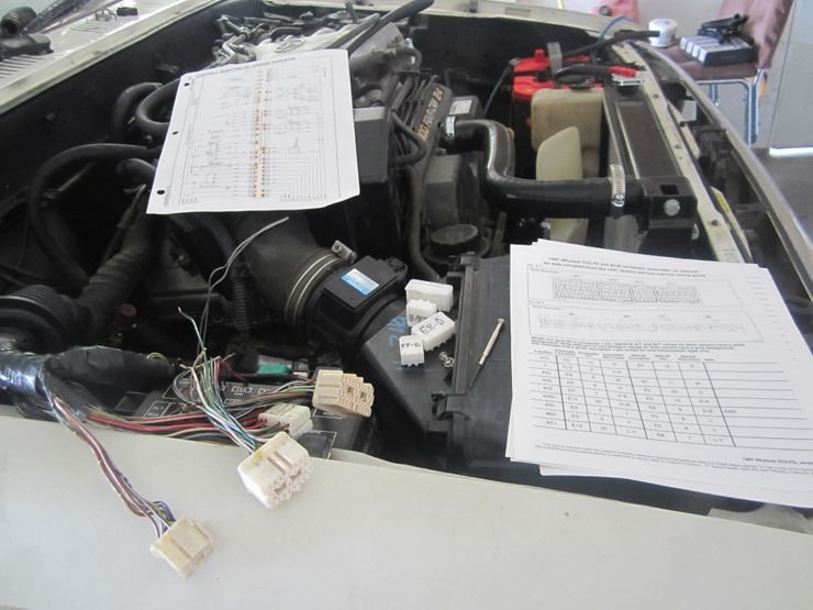

Taking some time up front to label the plugs really helps when you actually start to make the transfer of all the wires from the auto plugs over to the manual ones. I use a FINE tip Sharpie. This keeps me from getting confused when moving so many wires because it does become redundant, tedious and a mistake is simple to make. Also, there are TINY numbers, usually above the corner holes, to serve as reference point when labeling everything. With these new plugs, the numbers were almost impossible to see, even with a magnifying glass. I rubbed a little dirt on the plug and that helped. A little oily grime worked best as I could now see the numbers. Also, most of the EWD's have the pinouts listed somewhere on them. Just make sure you are looking at the plug from the correct side. This is where seeing the numbers on the plugs helps.
These are the different plugs. The top row is manual plugs and the bottom is auto. Always look at the plug as if it's going to plug into your eyeball. The plugs are labeled as if your eye is the receptacle for reference so again, look at them from the correct side.
A set of new manual plugs labeled and ready to go.
Auto plugs ready to be cannibalized.
Last time I did this in the cab, and there is no slack in the harness to allow for any wiggle room and made the job difficult, but doable. This time I did everything outside so I not cramping myself into the kick panel area, laying on my side, and I have plenty of room to be comfortable because I want to be focused.
Everything is here. Auto plugs labeled, manual plugs, my conversion chart, a small screwdriver to unlock the plugs, and a push pin to release the pins from the plugs.
It is very important that you DO NOT pull all the wires from the auto plugs and then try to match them up to the manual plugs. It must be done one at a time!!! There are more than one instance of the same wire colors and if you pull them all out of the auto plugs, you will not know what function a particular wire color is for and therefore, not know where it needs to go into manual plugs. You could always trace everything down with a meter, but that is a lot of unneeded time. The key is patience.
This is another great example of why taking it ONE wire at a time is important. If you look at the screen capture of the EWD for a 1997 4Runner will notice that there are two pink wires listed. One for the O2 sensor and one for the crankshaft positioning sensor. THIS IS WRONG! The actual wire for the O2 sensor is Pink with a blue stripe (P-L). If I pulled all the wires out I would have two pink wires on my diagram with only one in the harness and a pink/blue wire that I had no idea where it went because it is NOT on the diagram. Slow and steady wins the race!!!!
To get started, first you need to unlock the plugs. Pins will not come out unless the plug is unlocked. The pins will also not go in very well either if they are still locked. So ALL the plugs, donor and receiving, need to be unlocked. To do that, you need a small screwdriver to unlock the plug and something small and sharp to actually unlock the pin.
Here is a plug that is still locked. Notice the small tab is pushed in, and the plug is flat across here.
The tab needs to open so using a small screwdriver, it can be pried open with little effort.
The take a small, sharp object (I use a push pin cause it has a handle on it) and push it in to release the tab inside the plug.
When the tab is released, the wire will slide out with minimal effort. If you are having to pull on it, you are probably missing the release lever. Do not yank hard on it. That is not needed.
Follow your conversion chart and pull the first wire and then relocate it to correct hole in the manual plug that the EWD called for.
Here is a shot of my conversion chart for reference. This is not a conversion chart for every 3.4 swap out there so please don't think that you can take this and do your conversion from it. This is for the specific vehicle and ECM that I was working with. Not the one that you have.
As you can see in the first row, plug E9(E) pin 10 controls the #10 function and the wire is red. For the manual, the ECM has this function on E5(A) pin 12 and the wire is also red (all the wires are the same color when crossing over). So I will pull the red wire from E9 and move it to the E5 plug in pin 12. Easy enough and I have one completed. Double check everything and make sure its in the correct spot and then move to the next one. The is no particular order you need to go in; just as long as everything gets moved that needs to be.
You will notice that the second wire is E-12(H) pin #2 and is a V-R (violet with a red stripe)has nothing on the manual columns. This is because the manual does not need this function because it is related to the auto transmission. This wire will not be used in the manual plugs.
Here is a shot with the transfer completed. The wires coming from the manual plugs that are going to tie into the 3.0 harness for oil pressure, temp sender, tach, etc. The wires that are still in the auto plugs are all functions that are for the auto transmission and will not be used. These do not need to be taken out of the plugs and they have no purpose anymore. However, there is little room in the kick panel for all the plugs and the ECM to fit when you finish everything up and having an extra four plugs to hide away in there may prove very difficult, or maybe even impossible. I recommend removing the wires and capping them off with some heat shrink to save much-needed space later.
As with many things, the key to doing this is the homework. Making a clear, and ACCURATE conversion sheet is where most of the time will be spent doing this. I worked on mine one night UNDISTRACTED and got everything entered into Excel. Then I went over it two more times and double and then triple checked it before every touching anything on the truck. I did find a few fat finger mistakes on my initial chart I had made that would have caused me hours of grief when a CEL (Check engine light) came on. All told, I spent about 3 hours total on the chart and about an hour to move all the pins. Take your time and its a pretty easy task to save a couple hundred dollars and you are going to learn a lot about how the electronics work for the motor for future issues that you may have. Thanks and credit given to Mosk the first time I did this and the idea!!

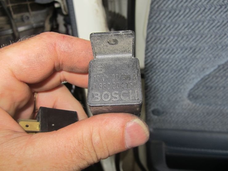

In a Tacoma or 4Runner, the factory COR is located on the bottom of the fuse panel that is on the bottom of the dash on the driver's side. It is significantly smaller that the 3.0 COR as well.
It looks like this.
It is a very simple setup like the relay pictured above in the diagram except even more streamlined as it doesn't have a 5th terminal that is "normally closed" (87a). It is effectively power in, power out. Also, because this relay has no input from the starter and only ignition, the pump will run with the key only turned to the ON position and not have to wait till the crank position is engaged. Toyota obviously changed this for a reason but I of course have no idea why. Possibly the pump engaging at ON rather than waiting until crank allows the pump a small amount of time to build pressure before crank to provide faster starting? I have no idea.

#3 - Using a Bosch Style Relay:
If you have neither relay available, or you have a failure away from a parts store for Toyota replacement relays, a standard Bosch style relay can also be used. These are available at any stereo shop, auto parts store, etc. for about $5. I usually always carry a couple just in case.
Since all the relays are essentially doing the same thing, (switching power) we can use this easily as well.
First though, the relay is providing power to your fuel pump. Therefore it is obviously VERY important that it works. As with anything, there are quality products and cheap imitations. Quality relays are Bosch and Potter and Brumfield (P&B). Anything else should be avoided unless you are in a bind and that's all that is available.
A genuine Bosch will clearly have a label as will a P&B but I don't have one here to picture.
A cheap imitation will have no label.
Wiring the relay is simple as well for this option of wiring your fuel pump.
Here is the diagram again to follow along.

Using Adobe Acrobat to Decipher EWD's:
I could type 30 pages about how to use Acrobat to get through EWD's more efficiently but I had to do some screen records for work related stuff so I thought that I would make one for this as well.
I am not really good at this but for some reason, the quality sucks at either YouTube or Vimeo. You may have to right-click it and choose "go to Vimeo to watch in HD" to actually go to Vimeo and then right-click and enter full screen and make sure the scaling is off otherwise the resolution is terrible.
And I know that I referred to the OBD2 as the CEL in the video : oops:but I am not going to do it over.

I have one suggestion though, on your soldering technique, this is not the correct way to solder two wires together. The wires must be tinned first and then soldered together. I am in no way an expert but grew up with an electronics tech and this is how I was taught. Not trying to stir the pot, just don't want peoples solder joints to fail. (that resistance thing)
This may help:
http://www.teamnovak.com/tech_info/h...-SPLICING-3800
Old Aug 17, 2012 | 05:34 AM
dntsdad's Avatar
Joined: Jan 2009
Posts: 1,908
Likes: 5
From: Fresno, Ca.
Originally Posted by dave_dj1
Great write up, thank you for taking the time to do it.
This may help:
I get what you are saying and I understand the process of tinning the wires. However, for me, when joining two wires to run parallel it is difficult to tin the wires and then twist them to ensure a tight fit BEFORE making the final melt. I use to do it the way as shown in the link in figure 10 in my car audio/alarm day. After some failures due to stress as the author points out I switch to the method I outlined without a failure that I recall.
Either should work but I like the idea of a physical bond (twisting) and then "cementing" the together with the solder.
Old Aug 17, 2012 | 03:07 PM
dave_dj1's Avatar
Joined: May 2012
Posts: 26
I understand your concern on the stress, I usually use heat shrink tubing, I think that helps.
I notice that you are not a fan of crimp connectors, I would like to point out that every single pin connector on those plugs you installed the wires are crimped from the factory. The engineers must know something. I also use crimps with heat shrink built on them.
As I said, I'm no expert but I know what works for me.
Along the lines of protecting the connection (no matter what method you use) I always use dielectric grease on all connections , crimped and soldered. It will keep the oxygen out and prevent corrosion.
An aside, I used some LED clearance lights for tail lights on my Kawasaki Teryx and had to solder in some resistors (they have a solid strand wire) so I could have tail and brake lights. I doubled heat shrinked them and never had an issue and that thing got rode hard.
