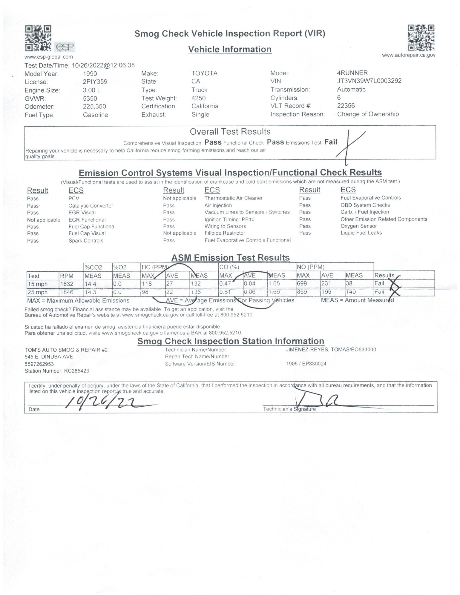

My 4Runner just failed CA emissions and I have no idea what to look for. It passed every other area, just running a little rich but not enough to be a gross polluter. I'm going to post the printout in hopes someone here can give me a direction to go with this thing.
The engine was rebuilt in 2015 and I have had minor problems with it since then. I replaced all the vacuum lines with silicon and appear to have no leaks. The smog guy couldn't find any problems or leaks. I've recently replaced the TPS. I don't know if that needs to be adjusted.
I don't know if this richness can be caused by an air filter problem, but I'm planning to replace that again. Those things can't be too new, I reckon. I just don't know what else to do with it or what to test or diagnose.

Well, the good news is you passed NOx. (Those can be harder to control.)
This article might help: http://www.cygnusx1.net/Media/Supra/...taTech/h56.pdf High HC and high CO point to too rich, but your CO2 says you're "close."
The first thing I would look for is "missing." A "cylinder efficiency test" could help. (pull the plug wires one at a time; the one that produces no change is doing no work and dumping fuel into the exhaust). Or use your ear. Next, I would go ahead and replace the O2 sensor. Once you do that, in the spirit of checking the easy stuff, assure that you're getting the VF1 "flop" about 8 times in 10 seconds. http://web.archive.org/web/201003261...01heatedox.pdf
Remember that the O2 sensor (via Learned fuel trim) is the final arbiter of mixture. If your VAF is way off, the O2 sensor will compensate, unless you're so far off that you throw a code. At this point, I wouldn't horse around with the TPS or the VAF.

I have a 95 4Runner that has the same drivetrain as yours. I bought it from a charity auction. Someone had donated it because they could not get it to pass smog. When I tested it I got a fail very similar to yours. With an EGT probe I worked out the catalytic converter was not getting hot enough for the test. I took it on the freeway at 70 with the OD turned off for about 10 miles and drove it right into he smog shop. It helped the shop knew what I was going to do and was waiting for me. They hooked it up and it passed easily.
So maybe your just not getting the cat up to temp.
