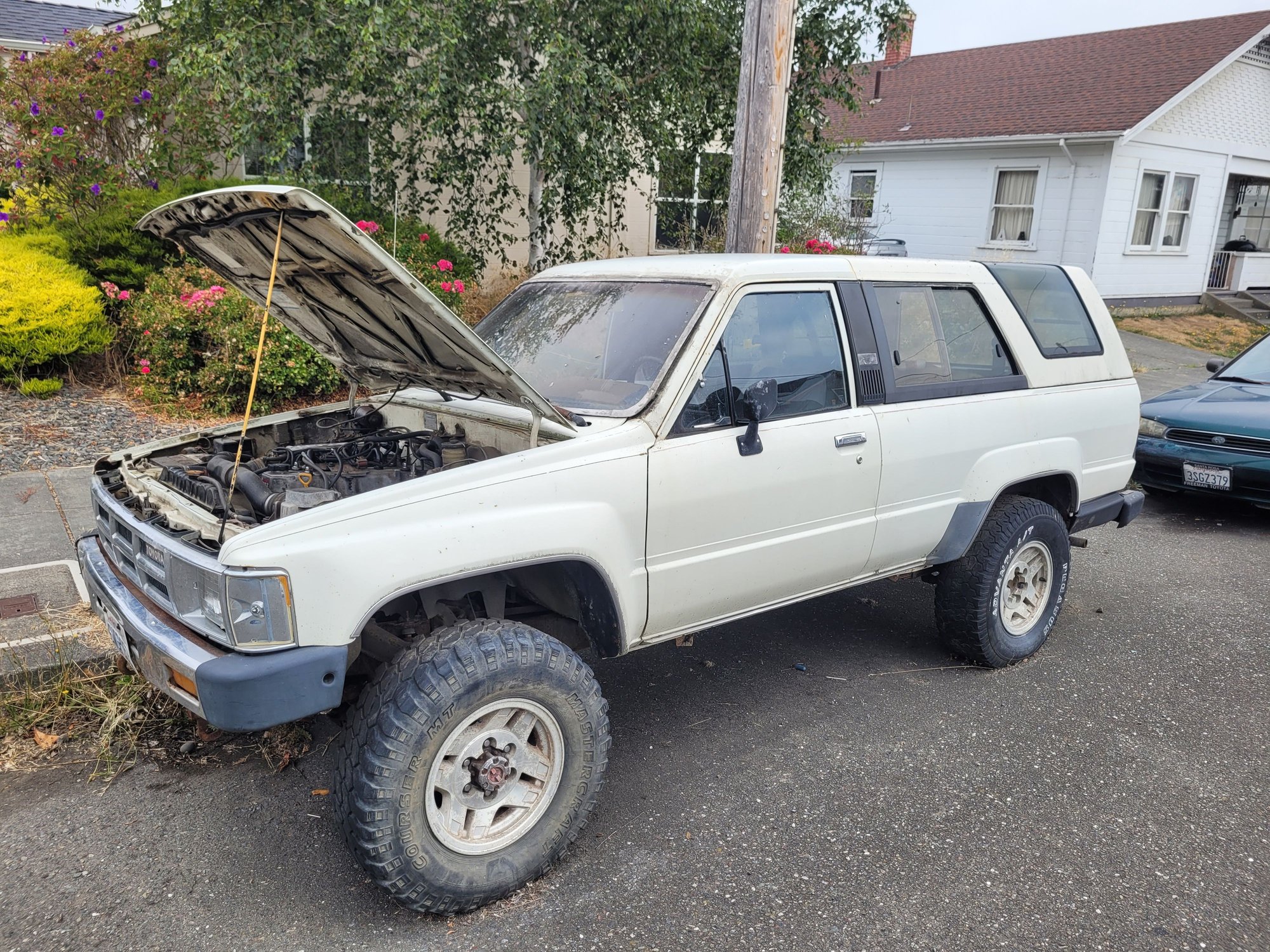

Recently picked up 2 new to me 86 4Runners 22RE manual. The red one (Rosa) has a cracked exhaust pipe and a leaking timing chain cover. I'll fix them soon enough. She's got over 400K on her with a rebuilt 22re with 70K. Great interior, terrible exterior. The white one (Blanca) has a little over 200K. She has a better exterior with a lot less miles on the body. But her issues are far worse. Drives fine on flat but as soon as I try to drive it uphill it loses power and will eventually die. I have to keep downshifting to the point where I'm in 1st gear going 10mph. If it gets too steep it totally dies. I've gone through and done the following to no avail:
- valve adjust
- timing
- new vacuum lines
- adjusted and tested TPS and replaced connector
- new O2 sensor
- new fuel filter
- serviced injectors and replaced connectors
- new dip stick
- new hoses
- new PCV
- compression test ok
- new plugs gapped
- new wires
- cold start injector serviced and connector replaced
- new bvsv
- cleaned throttle body and plenum
- new fuel pressure regulator
- tested air flow meter
- found air valve disconnected and repaired that.
The list goes on. I'm at a loss. I even tried driving with the gas cap off. Pulled the fuel pump and checked the screen. It was all clean. Ran sea foam through it along with fresh gas. Still no change. Any suggestions on where to go from here? Any help is appreciated!

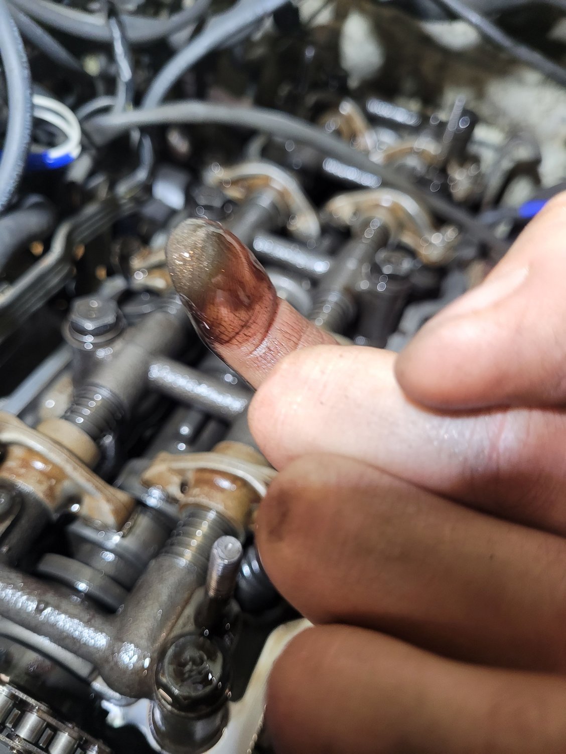

I just adjusted the valves again. Dipped my finger into the oil sitting by the rockers and this is what I found.
This is going from bad to worse I think.

TPS has been checked, rechecked and then checked again. Haha! I did a vacuum check on the cat and it's normal. Cat looks new actually. Tank was clean inside and sock is clear. Pump actually looks like it was replaced by PO. Didn't check all the lines though. The two things that have me most concerned are the silver in the oil and a knock that has developed at RPMs over 1500. Seems to be coming from around the union of the transmission to engine. Sigh... I'll check the fuel lines next and swap the fuel pump from Rosa and see if that does anything. Thanks!

Silver oil and a knock is going to be a rod bearing. Hold idle at 1500 or so and remove spark plug wires to see which cylinder. You can maybe replace the bearing, it’s a lot of work, i just went through it. But mine has another problem so will still have to pull the engine out.
Old Mar 23, 2023 | 06:42 PM
HSHSURF's Avatar
Joined: Jan 2023
Posts: 73
Likes: 30
From: CA
Yeah I was thinking it was a spun bearing. It's on the number 4 cylinder. Would the spun bearing account for the total loss of power going uphill? I'm seriously considering pulling the motor out of Rosa and putting it in Blanca. Then I can do a full tear down of Blanca's.
Yes, it sure would.
