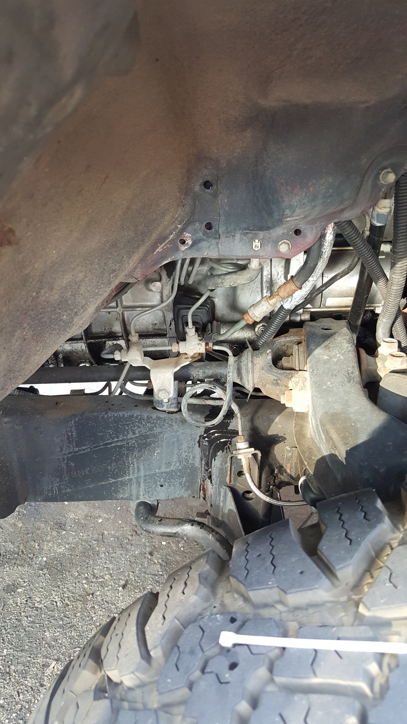

I figured I'd bump an old thread rather than start a new one, but I was having a similar problem with water dripping on the passenger floorboard whenever the A/C was running. With my 91 4runner still having R12, I really didn't want to open up the system like is suggested in this thread and I just hadn't gotten around to trying to clear out the evaporator drain, until a couple of days ago, and to be honest, it really couldn't be easier.

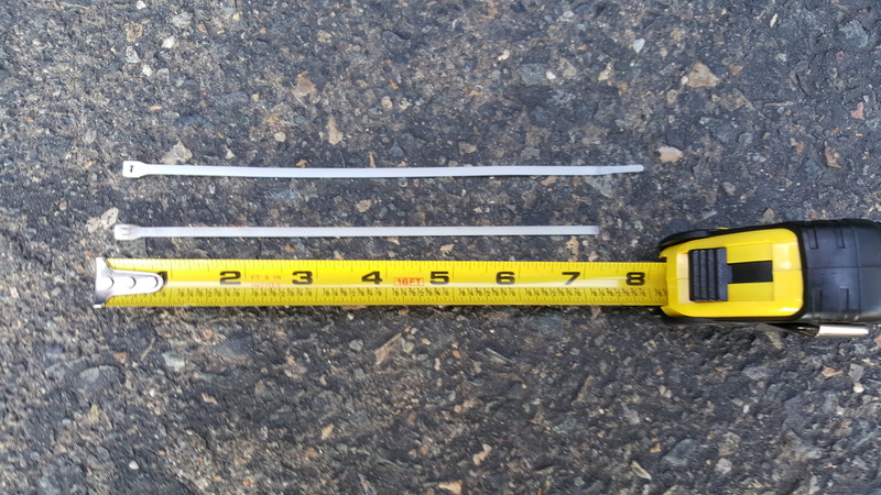

I used an 8" zip tie and cut off the flimsy tip:

Then carefully "snaked" it up the drain tube in the passenger fender well (I don't have the rubber "skirt" or starter access plate attached), you can see the buckle end of the zip tie sticking out:

After that water started dripping out so I removed the zip tie and it slowly drained out a lot more water than I would have thought. Here's a shot showing it dripping, I didn't get a shot of all the water on the ground:
It has continued to drain for the last couple of days, and so far it hasn't leaked any more on the floorboard.
