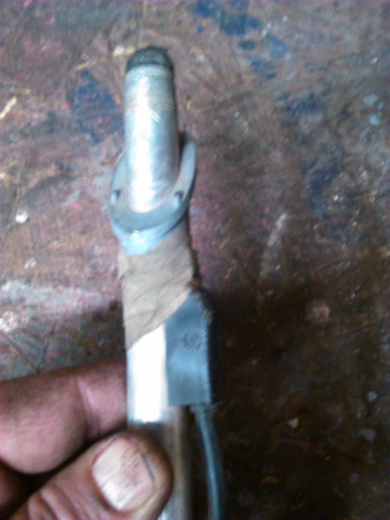

Here is an electric antenna but same principal, not sure where the ground actually connects to but maybe the picture will help.

Got it fixed using the bolt trick, I just left the small (ground?) wire off and the radio works fine.
