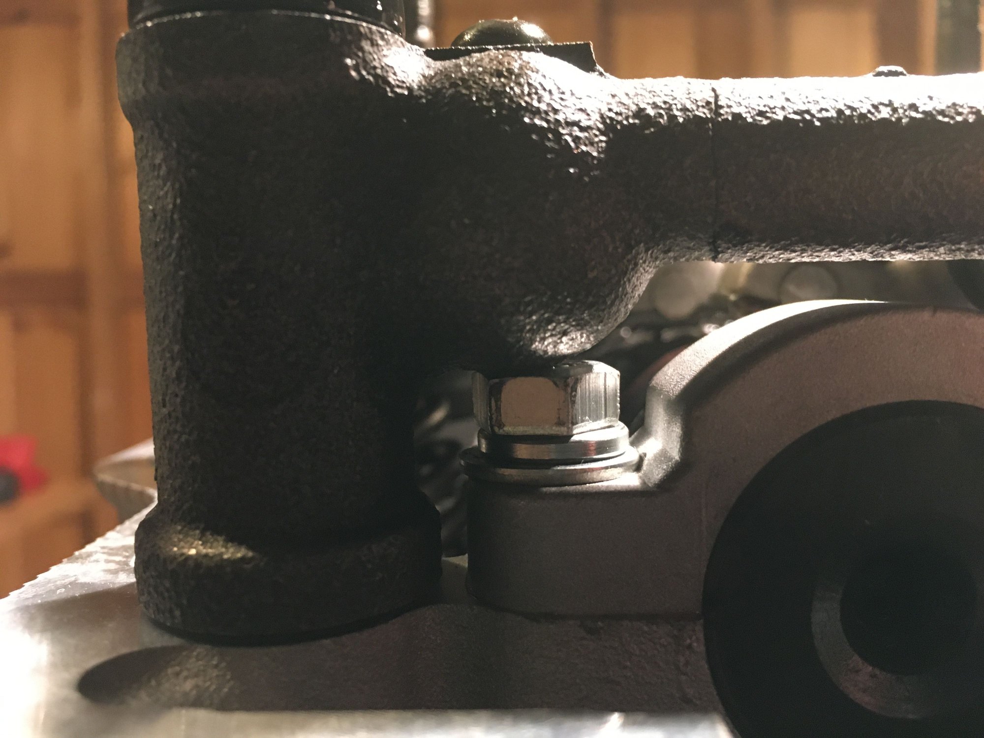

I found the cause of the break. The new head I purchased with cam had bearing caps and bolts with a flat washer AND a lock washer also. I assumed (I know) that that was the way it should be so I plastigauged everything an torqued them down with both washers installed. After breaking the tower I took a closer look at things and the tower made contact with the nut on the cap. I looked at my old head and there was just the lock washer so more clearance was provided.

Not to add to your concerns, but that bolt/washer/washer clearly does not belong there. I don't know much about the 22re, but my 3VZE uses 8mm J.I.S. flange bolts to hold the cam bearing caps. No washers.
For that matter, pretty much every bolt on my truck is a J.I.S. flange bolt. What size wrench does your bolt take? 13mm? That's a dead giveaway -- J.I.S. bolts have 8, 10,12, 17mm heads.
That head may be new-to-you, but it's not a new head. Rebuilt maybe. On some guy's front porch.
But at least you figured out why the tower broke, so it won't happen to your replacement.

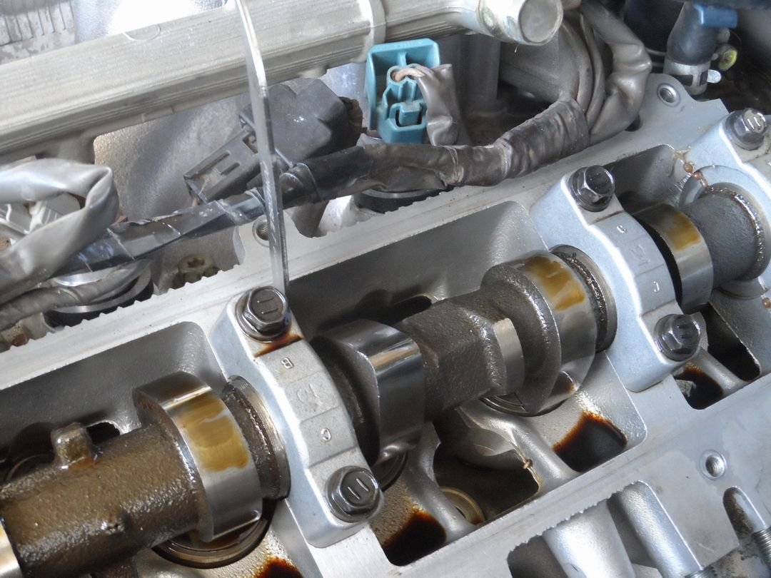

Yes, its a brand new dnj head an cam from redline cranks and cams (the guy that used to grind cranks for engbldr). The bolt is a 12mm. I called them to warn them to let folks know that the extra washer should not be there so if other people buy one of their heads they wont end up like me. H
ere is a pic of the same bolt on my OEM factory head. Toyota used lock washers under 12mm bolts to hold down the bearing caps on my 1986 22re. I would prefer the flange bolt set up since it would gaul the bearing cap holder less.
