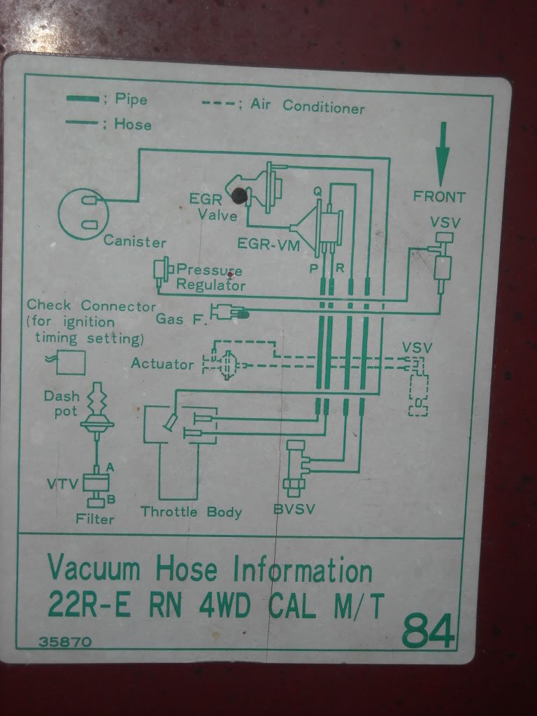

In the photo of the valve cover, there are four sensors visable, a blue plug and a brown plug, then more towards the front of the engine is a brown and a gray plug. What are the brown and gray plugs for? and will the engine run if those are missing? In my truck those two plugs are not plugged in and the truck does not run. The sensors are missing. Hate to sound stupid but the engine was received in peices and it appears some stuff was missing.

all of those are vacuum valves for various emissions systems. every truck is different, so your's probably needs those to run correctly. look though a haynes manual to see if you can trace the vacuum lines and valves
What year 22RE is it?
Here is a diagram for an 87 22RE w\AC (Mine)....
It lists both VSV's on my year.. But my 87 does NOT Have an EGR VSV nor others that later model rigs have. VERY important to know what year, because you might not be missing anything, depending on the year(If I missed you posting the year..... forgive me, I'll shut up now! hahaha)
Sorry Ian... just going through this right now, so thought I'd throw it up there..... Don't throw that wrench at me, k? hahaha
