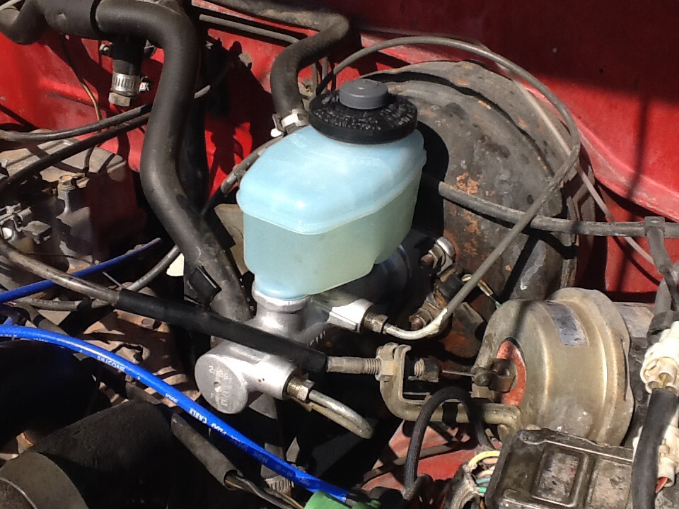

Talking She did it to me too.
i had the same thing going on in my 87 4runner. Mines was leaking alilo but i put in ah new 1" bore MC and now its no longer touching the floor, and braking better then before. I still gotta get the v6 brake calipers then it should be better i wanna say its your MC.

Munkymag: What year MC did you get? And did you replace the booster? And was it an external or internal leak you had?
Old Jul 1, 2014 | 05:41 PM
Munkymag's Avatar
Joined: Mar 2014
Posts: 130
From: South Cali.
Got mines off off lowrangeoffroad.com. The junk paid me nothing on ah good unit so i bought one from them (lowrange). Cost me like 120$. If you can get ah used one i guess but i didn't want too deal with a no good unit too so i got ah new one (i wanna say if i'm right 96 4runner or truck and down) you should be able too use the MC from. Look it up too be sure. my unit was leaking from under the plastic bottle that held the fluids. The part were it connected too the pump for the MC if you know what i'm talking about. Not too sure what year they give me but it should of been from one of those model v6's. The booster i did not have too change.
