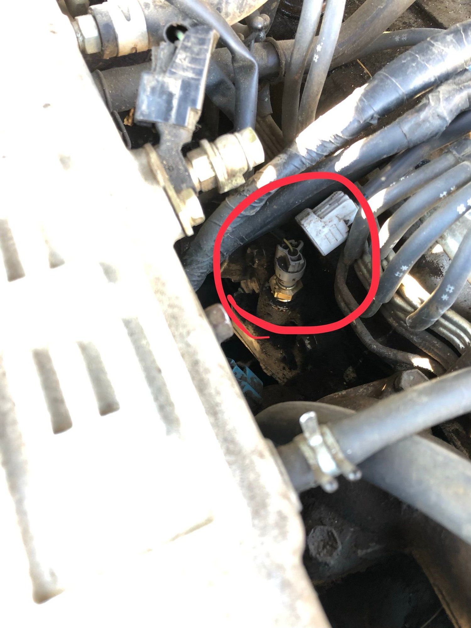

Exactly which water temp sender did you replace? Also a good idea to eliminate doubt on connectivity and cleanliness issue. Manual does not say this but ALL temp senders, their connections, mounting threads and where they mount on the block need to be cleaned to bare, shiny metal every 25 or so years . Some of them need electrical connection to block for ground.
The circled one.

Originally Posted by idyota
The shiny brass one.

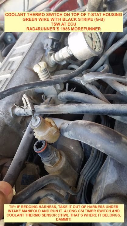

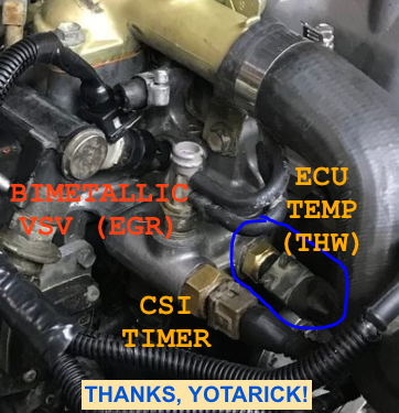

Not very clear but that seems the temperature GAGE sender - Will not affect running. Here are other temp sensors, including BVSV mentioned above:

Replaced the fuel filter and thermostat today and that did t help the issue at all. Looking for parts to be able to test fuel pressure also.
I’ll look at those other sensors that RAD showed me pictures of. Sorry my picture wasn’t more clear.
The green Temp sensor had a crack in the plastic, allowing it to move, disrupting the connection. When I checked voltage everything was good, but couldn’t tell that it was broke until I moved everything out of the way to pull it out. For now she is running like normal.

I edited my post above to use yotatech photo hosting, instead of google photos.
I think the one with green connector is the Sender for the ECU, so yes, that would affect running.
