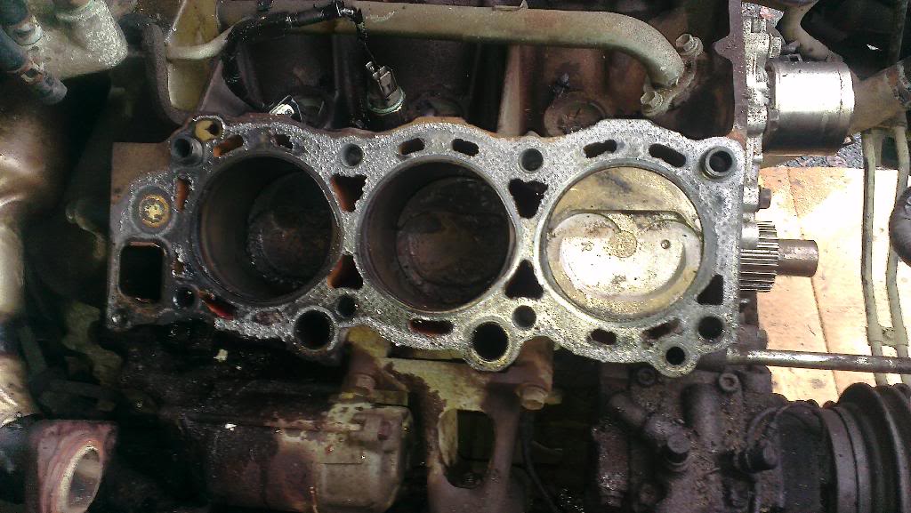

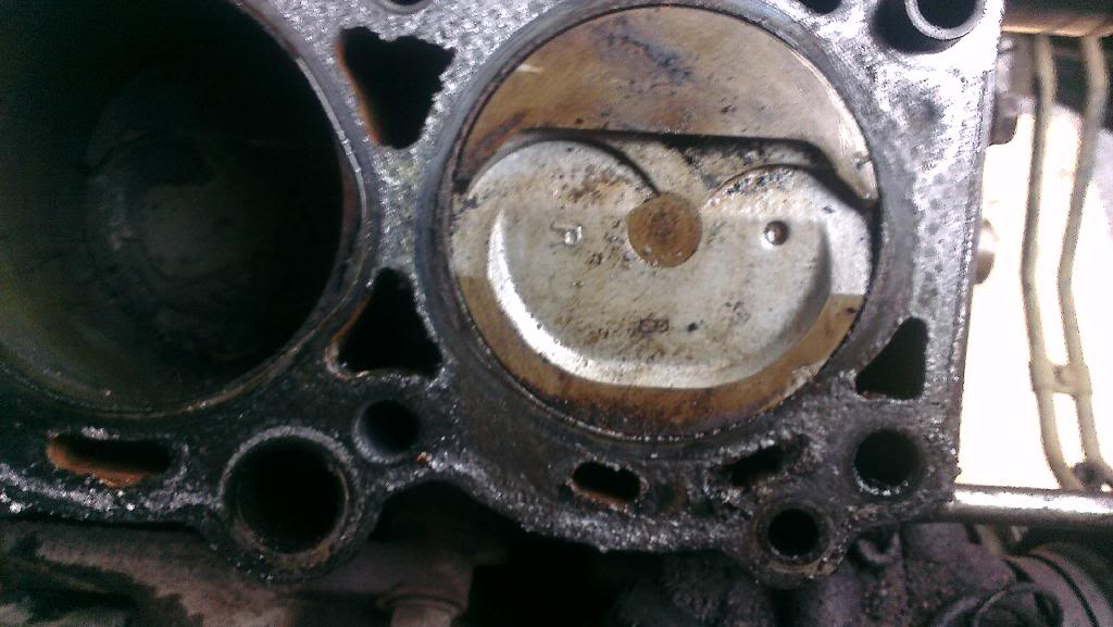

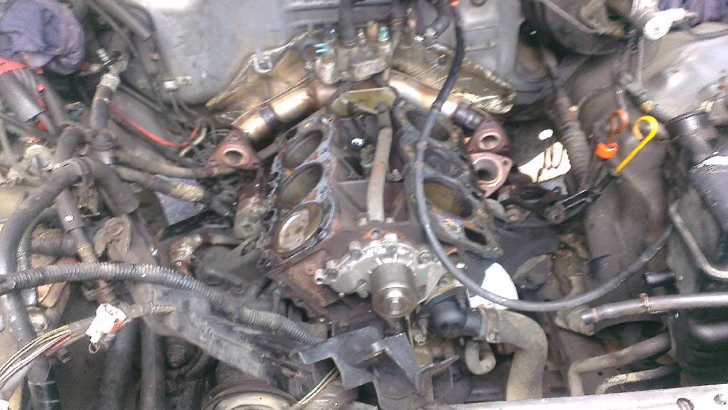

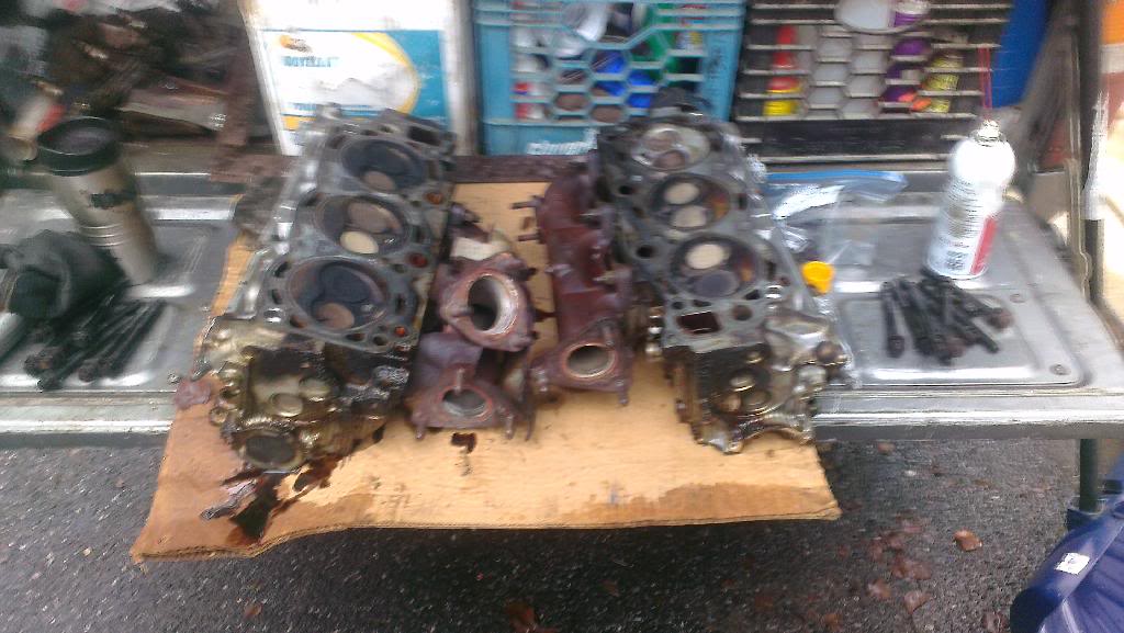

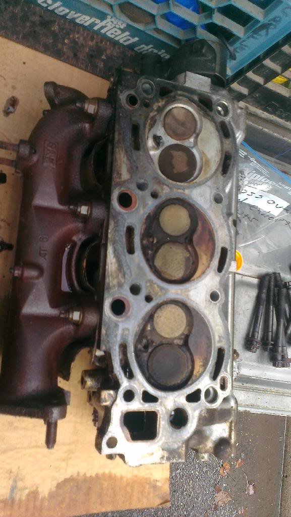

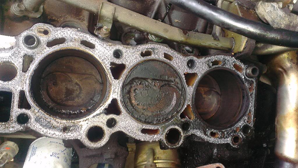

Well between work, family, other commitments not to mention battling the weather the past few weekends.
The heads are finally off!!!!!!!!!!!!!!!!!!!!!

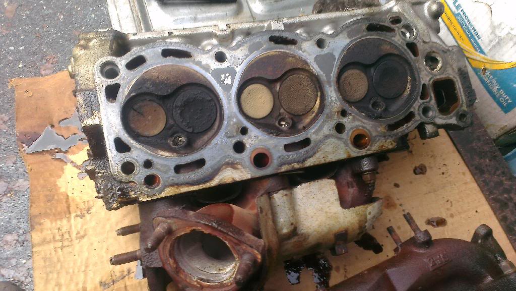

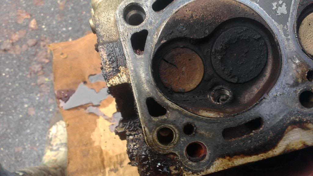

The block seems to be in good shape and so do the heads. The gasket blew at the number one cylinder but I couldn't see any major problems there besides some gunk in some of the ports . I did find that the exhaust valve on the number 6 cylinder was cracked. I plan on dropping them at a machine shop this week to have them surfaced and the valve fixed. Hopefully I can start getting them back together next weekend.
Heres a few more pics
Right side head and block.

Left side head and block

A close up of the # 6 cracked valve.

Close up of the # 1 cylinder

Any sugestions for cleaning the pistons? Or is there anything I'm missing in the pics?

Be very careful not to scratch or score the piston heads. You can clean off carbon with a paint scraper or a smooth flat edge.
