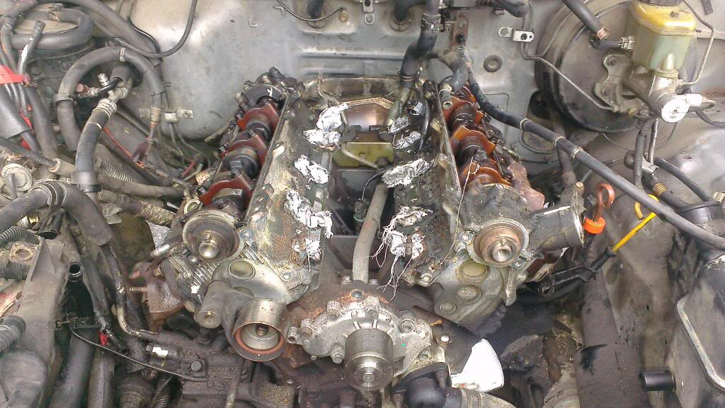

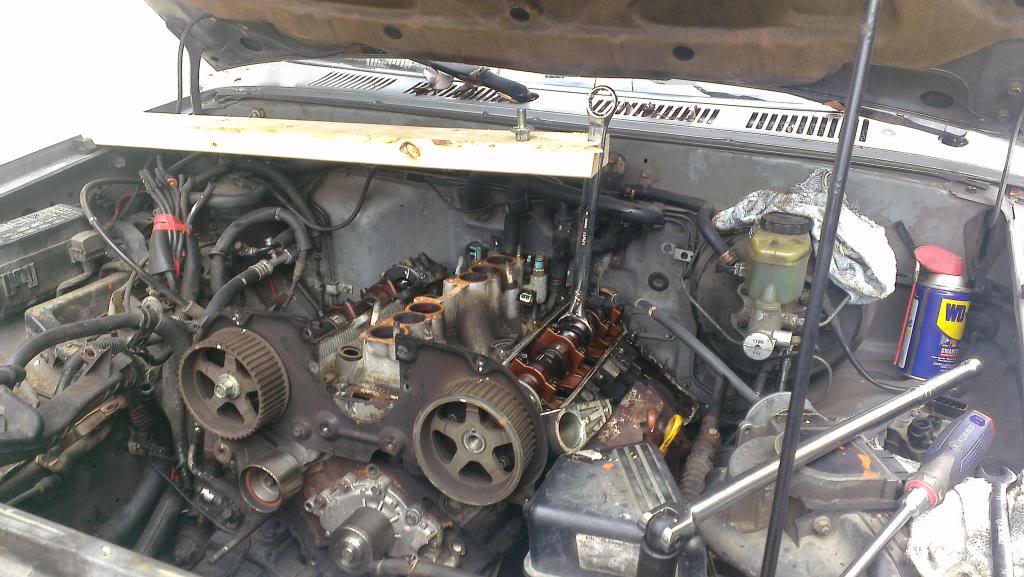

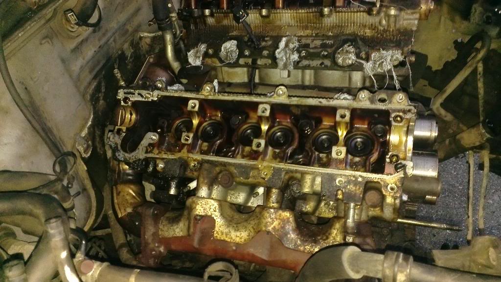

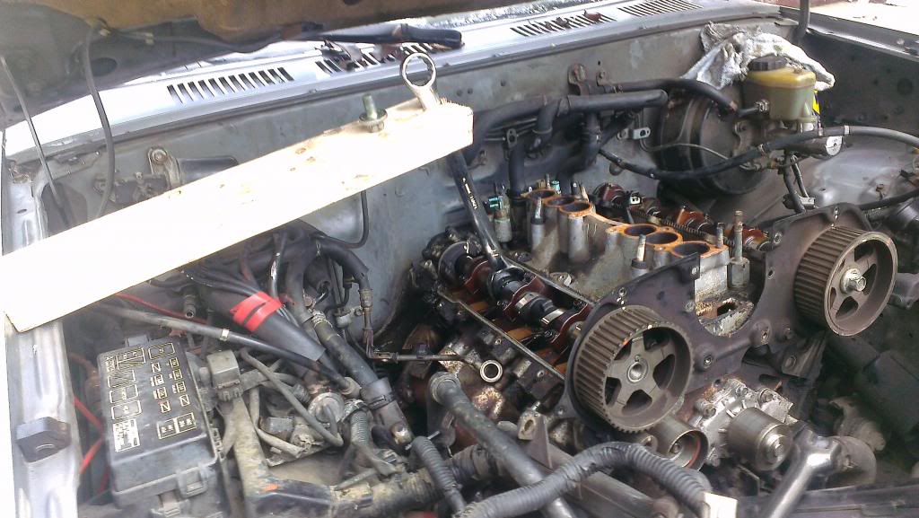

Project is coming along slowly but surely. lol Heads are almost out Haven't had a whole lot of spare time lately and seems to be a Sunday afternoon project. Almost there and with the temps supposed to be mild this week I may try burning the midnight oil after work if I have the energy.
A few pics of where I'm at
The cam sprockets weren't bad at all to get off I used a 2x4 to brace a 27mm wrench and a 18" breaker bar and off they came. I tried a dewalt cordless impact gun but that wouldn't budge the bolts.
