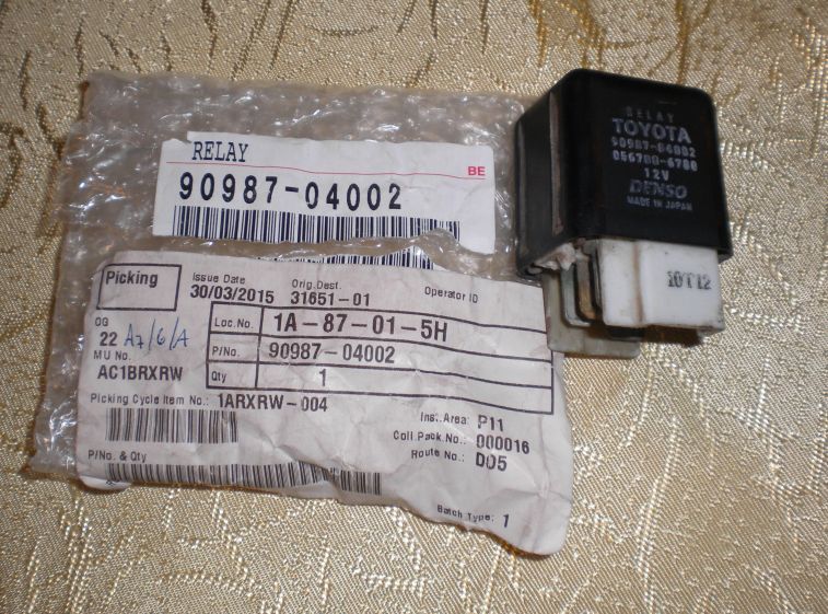

Hello, I had the same issue, in the end the part to blame was this little relay. I started like yours and then it stopped working at all, the relay was busted in the inside all loose
http://s196.photobucket.com/user/wil...g.jpg.html?o=1

That would make sense regarding my intermittent problem. I was waiting for the blower to stop functioning permenantly so I could localize the fault, but it has been working without interruption for about a week now. Still confused as to why when it stops working the low speed is still functional.
