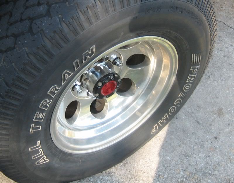

I found a little side project for you while you are waiting for the clutch! Remove/Clean/Paint/Lube/Re-Install your Aisin Hubs.You may have already done this but I just did and it was worth the time. Plus you get to pick any color you want for the dial!! I only suggest this because your attention to detail is more intense than mine!!
DSC00145-1.jpg?t=1246313166
Mine aren't flawless(and they are kinda dirty in the pic), but I am sure you could get yours perfect with from what I have seen of your painting skills
EDIT: Sorry Bleeder, I just ran into the write up you did on your hubs when you painted them. LOL And I was right. They did come out much nicer than mine!!
https://www.yotatech.com/forums/f116...ry-day-156896/

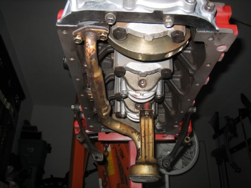

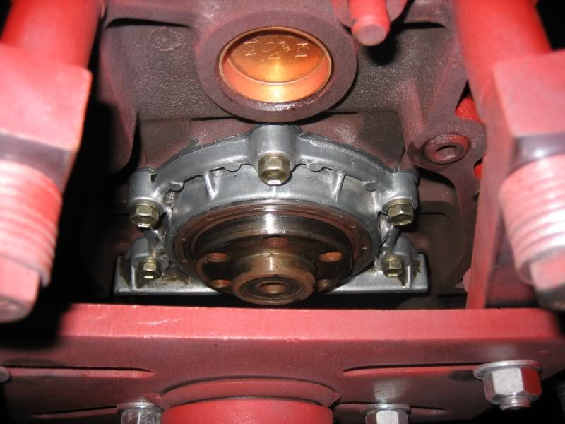

BUT I did do a little more cleaning today, as well as bolting on a couple things, like the rear main seal:
and the oil pickp tube:

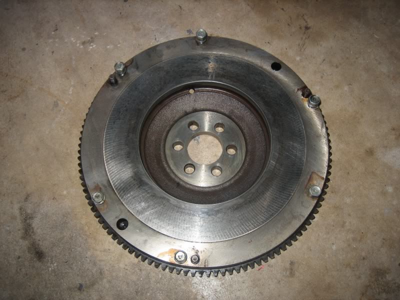

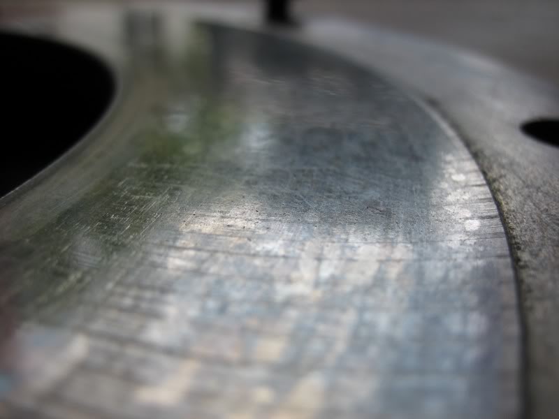

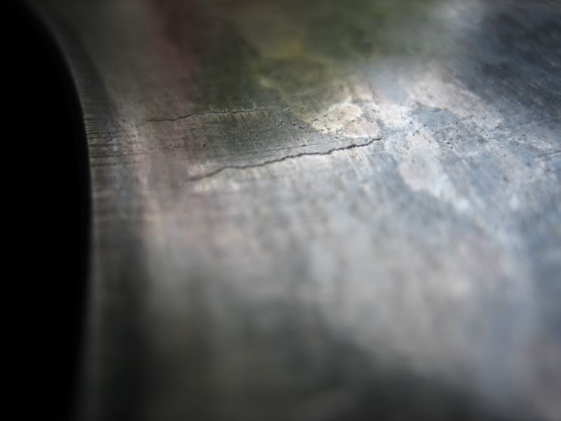

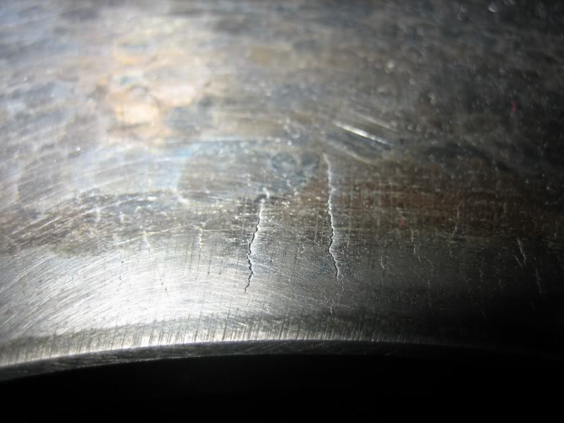

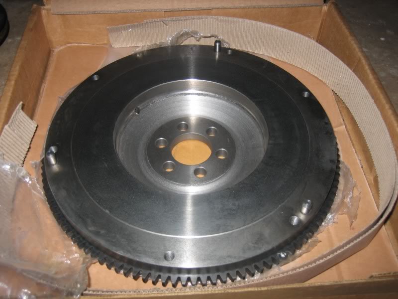

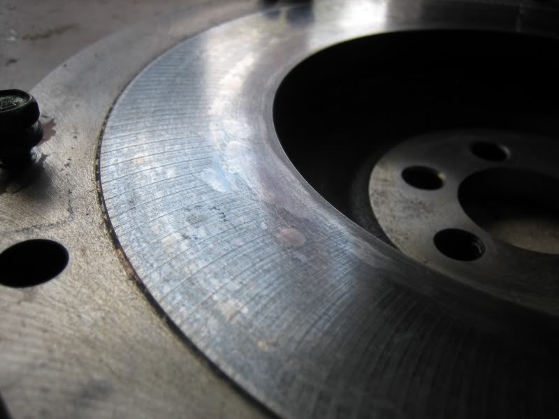

I got to cleaning up the flywheel cause I was going to take it tomorrow and get it turned, but after cleaning, here's what I found:

after 296k miles, I figured I retire the original flywheel

yeah I just didn't want to risk it; I would hate to have to replace a bellhousing cause the flywheel exploded at 5k RPMs

hey bleeder...my flywheel looked EXACTLY the same..it had dozens of those little "cracks"..took it to the machine shop..he said those are just surface cracks..and he machined em right out in a matter of minutes...so if you havent already bought a new one..take yer old one to the machine shop and ask them first!!!!!
Old Jun 29, 2009 | 08:49 PM
  #534
iamsuperbleeder's Avatar
Joined: Feb 2008
Posts: 12,248
Likes: 33
From: Lake City, Fl
well, I've already bought the new one
I've always been told that if there's cracks, it's junk...
I'll bring the old one along tomorrow and see if they can maybe machine it out; I can always return this new one
The new one only cost $60! If the resurface is half that or more, I'm just going to keep the new one, lol

that old flywheel does'nt look old at all. if i didnt know any better i'd think it was new...
do you run a cleaning service?
Old Jun 30, 2009 | 04:42 PM
  #537
Joined: Feb 2008
Posts: 12,248
Likes: 33
From: Lake City, Fl
lol, if you're talking about the flywheel in the last pic, that's because it's the new one
I didn't get a chance to bring the old one by a shop today to have it looked at btw
