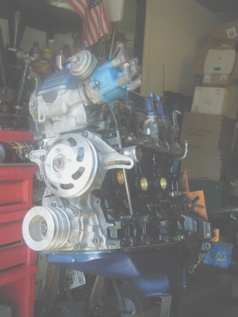

I used purple power on my engine rebuild I sprayed everything down let it soak for a few minutes then hit it with the pressure washer a few times seemed to get every thing looking almost new took off 30 years of oil build up on my old dirty motor parts
Here is a pic of my recent motor build
Thats a 30 year old timing cover it was oily dirty black before the purple power
I did not get my stuff hot tanked, machine shoped and shined up purdy like yours just used purple power and my handy electric power washer before I built her up on my work bench at home

dang, looks good!
I'm dig'n the LCE underdrive pully kit

Thanks,
I am liking yours better your doing a lot of stuff I wished I would of.
You will dig that street RV head and cam I just sold off my old one next time I am going for his all out HO head.
