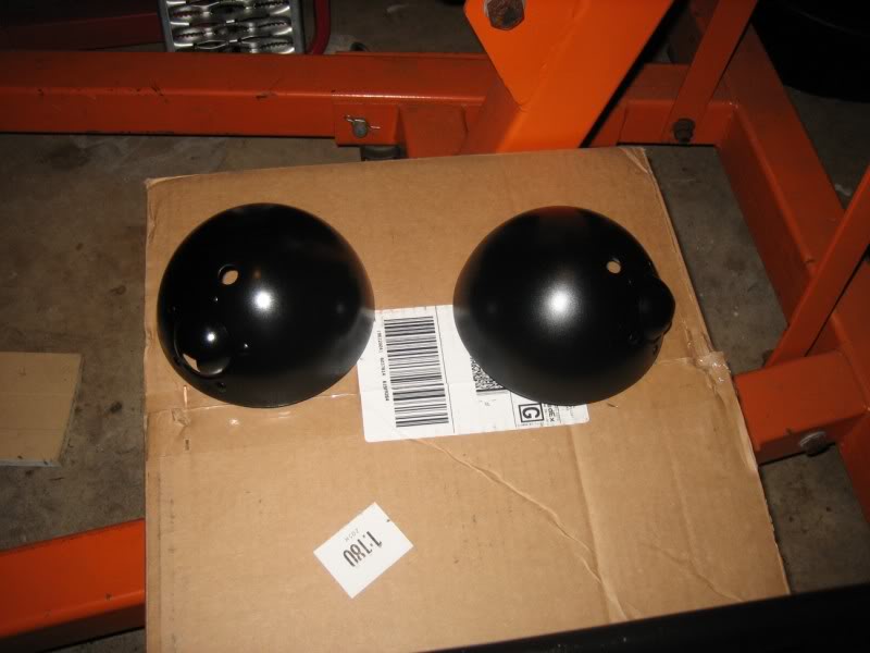

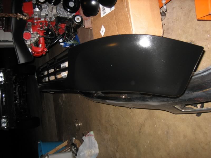

Well, I took the day to do something I've been wanting to do for along time, and that's punch out some dings and repaint the lower front valance I also sanded and painted the rusting fog lights, cause they were starting to look pretty bad, lol

Pssst, Throw the plastic away
Haha jk, Lookin good man !!

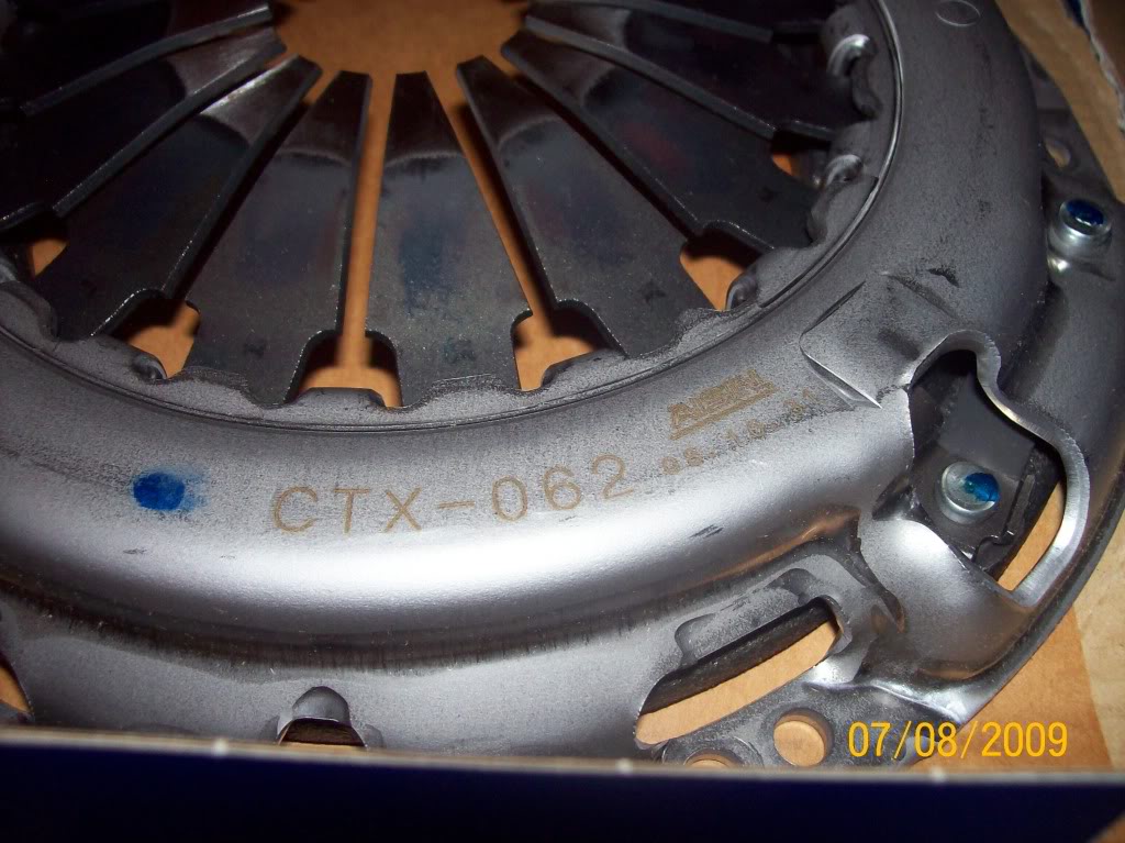

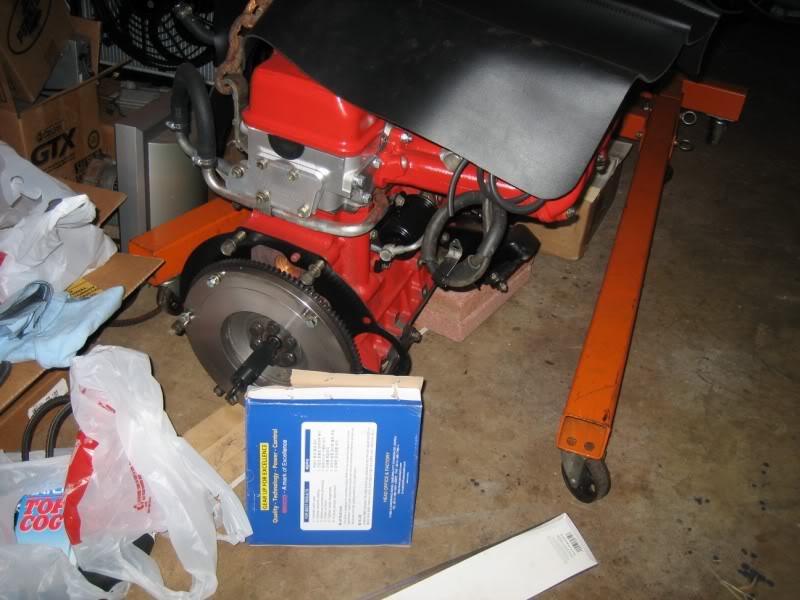

Hey bleeder is this the same Pressure plate you got, the wrong one?
This was the one I got from Marlin W/My 1200 LB 22re kit. I have yet to install it as the motor isnt quite done yet. So i have no idea if it's the correct one or not.

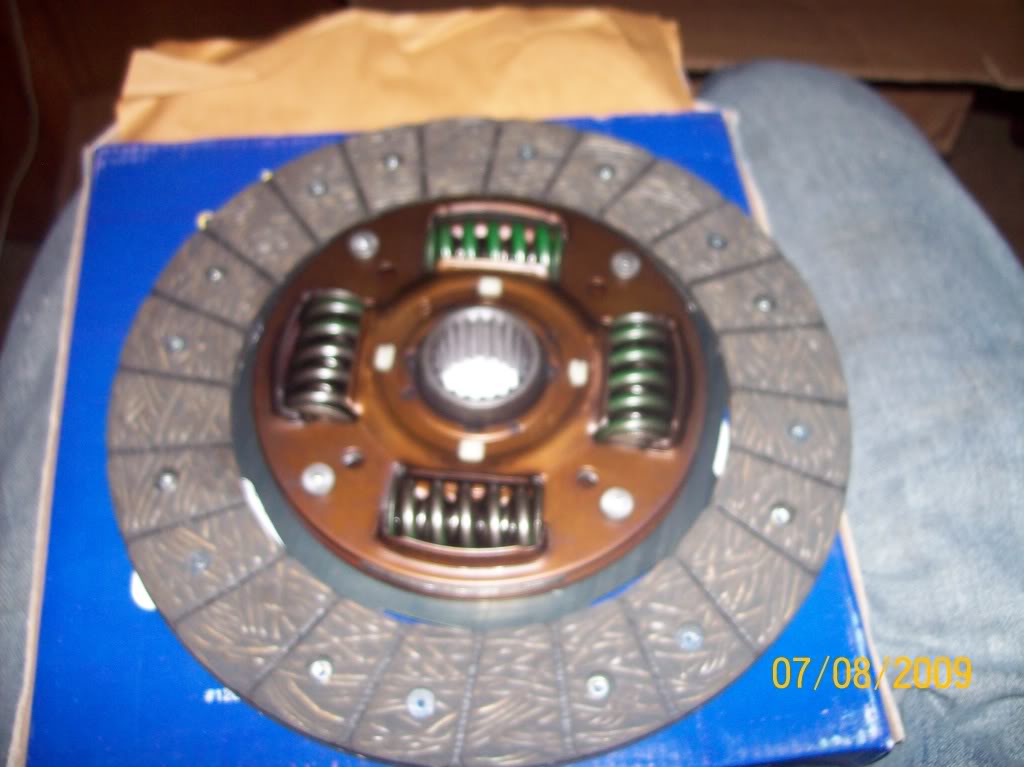

Here is my clutch disk, it looks the same as yours does now..
And a FREE goodie just for you....

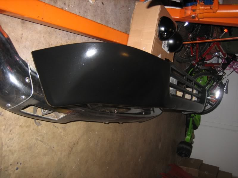

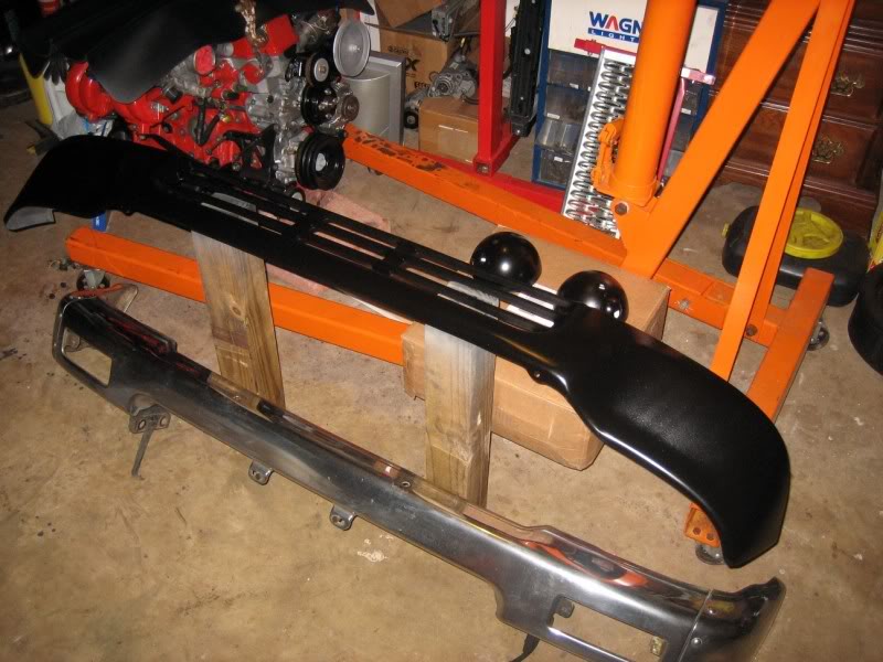

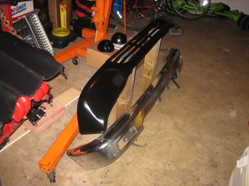

ya know I held the bumper up to the truck to see what it would look like without the valance to see qhat it would look like, and it just looked like it was missing something
I really wish I had a MC or an Adicted Offroad bumper to bolt back on there, lol
I got it all bolted back on today; looks a lot better IMO with the black bottom peice

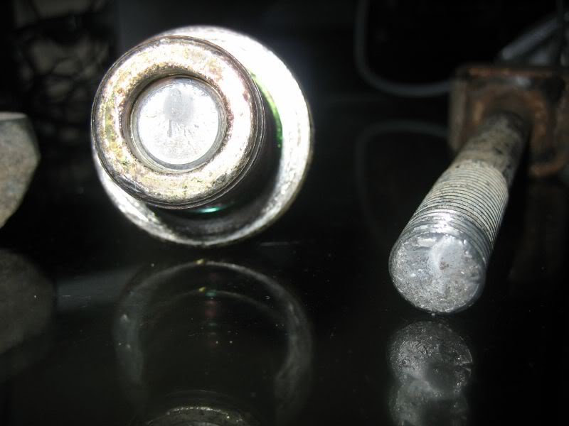

Geez, you that bored? LOL!!
Sounds like you've got a plan, which is good 'cause some people just give up. Of course, without pics of this "said" event this could all be some clever fabrication of a dream of something you wish you could do and you actually have the motor in and tested and you're simply plugging your post numbers prolonging our anticipation of such a beautiful creation...
...I'm just sayin'

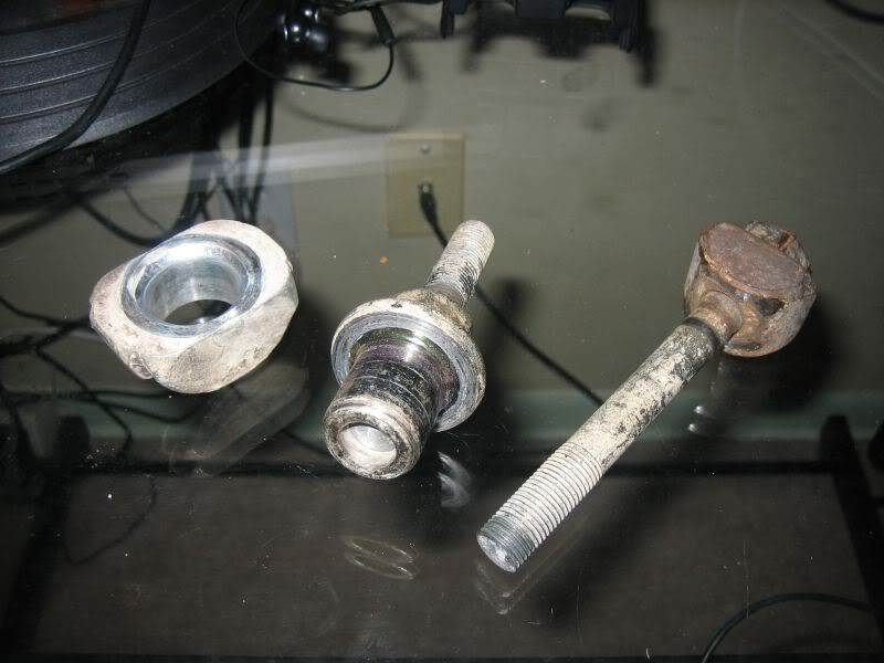

how bout some pics of the broken adjuster bolt? lol
it's sitting here on my computer desk cause I'm taking it with me tomorrow as I leave for work, and might just stop by the dealership; who know's, they might have it in stock!

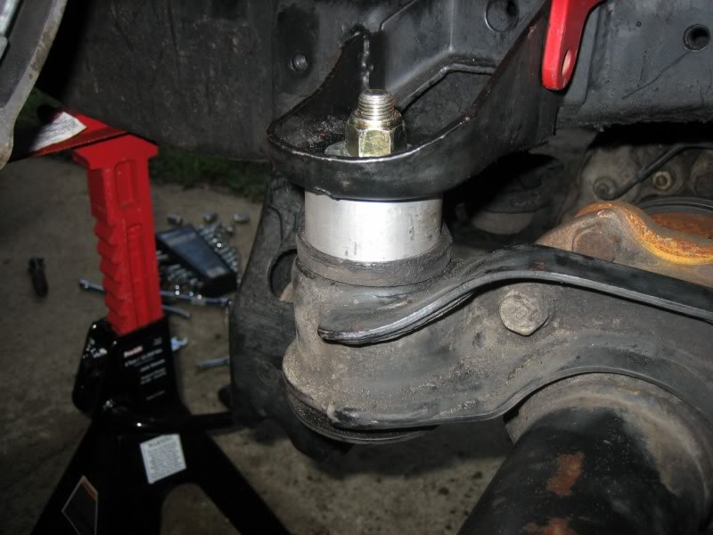

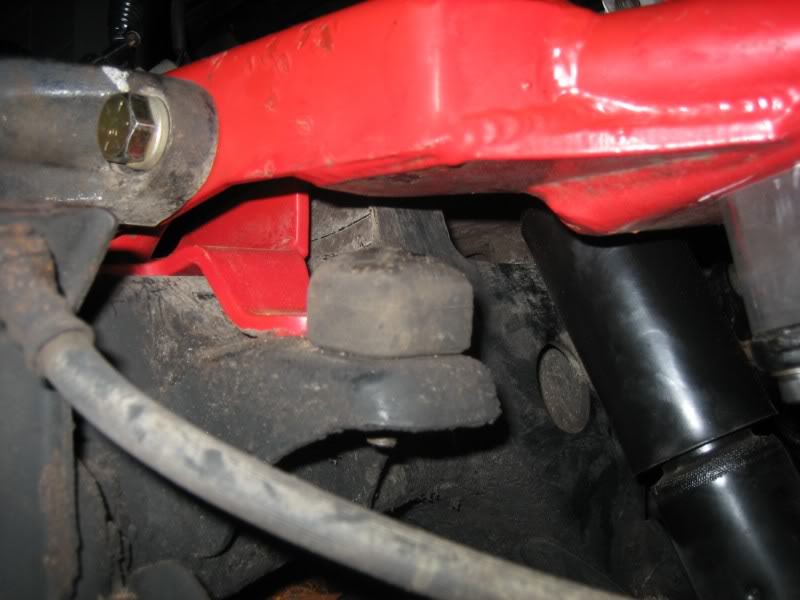

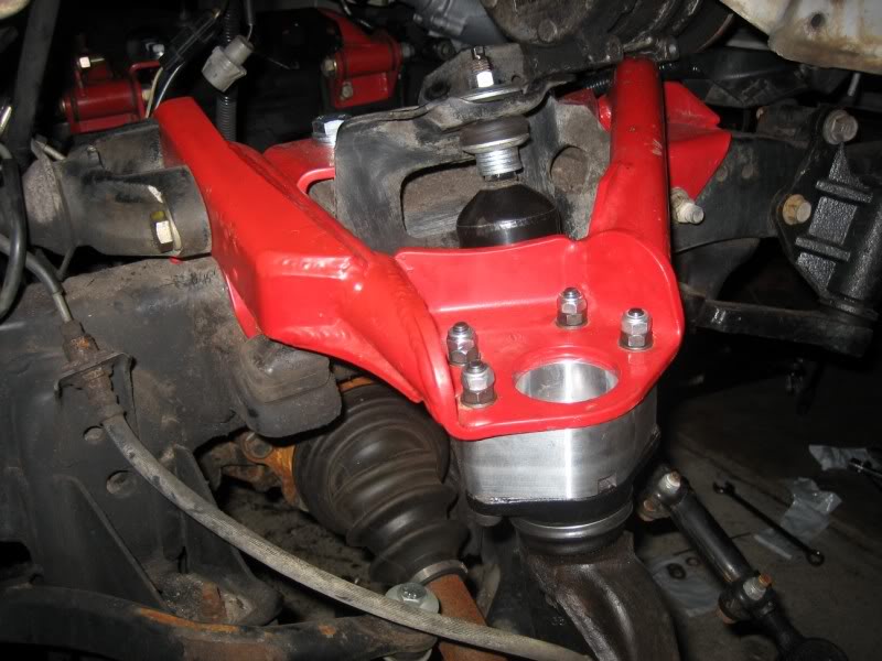

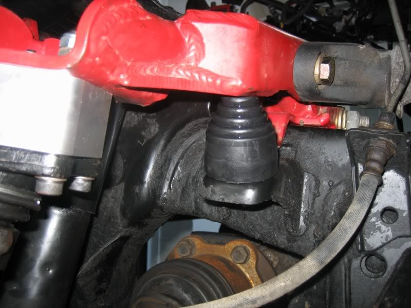

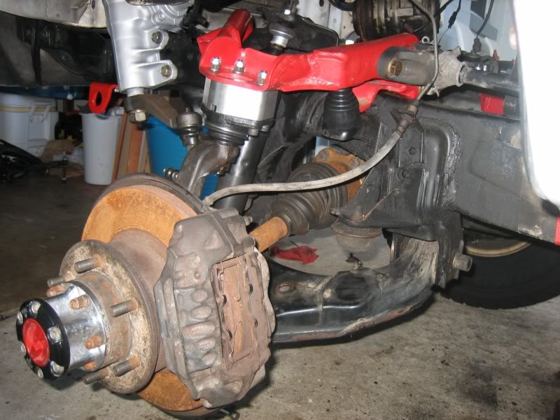

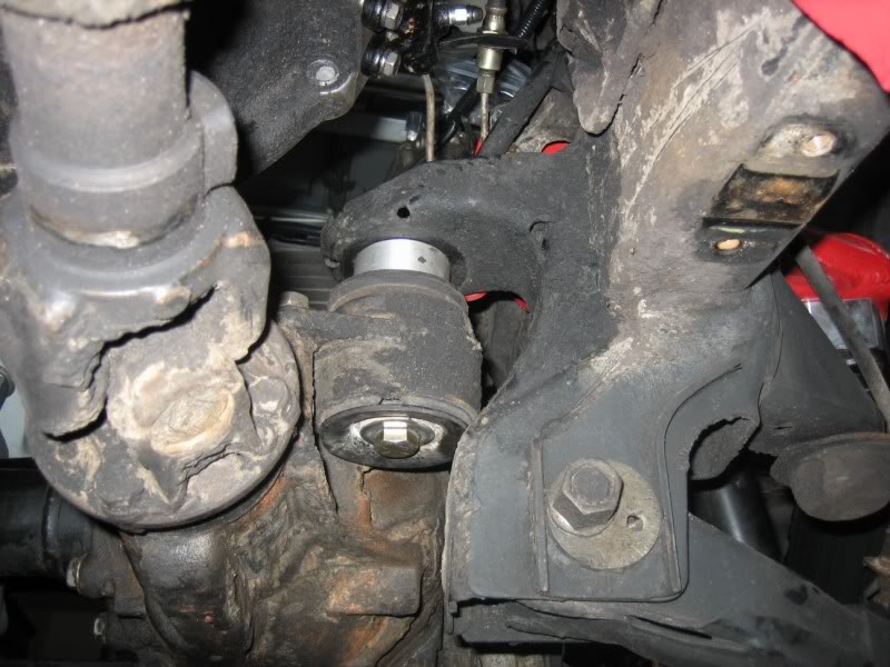

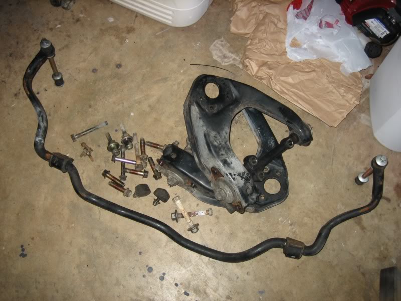

well, I may have taken this little project a little too far now, lol
I got into installing these UCA's and managed to break all but 2 of the ball joint mounting bolts
before torquing them down:
well, after snapping them, I remembered about the other ball joint bolts I had, the ony thing is that they are 1 1/2" longer than the originals, beacause they come with BJ spacers
SOOOOO... we're going to try something
so, I've got some major enginuity to do here...

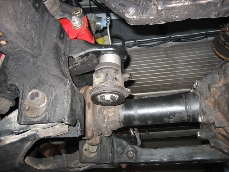

I'm installing the diff drop tomorrow, and and I've got to shim the heck out of the droop bump stops so the stock shocks are not the droop limiter for now untill I can put some longer shocks on it on second thought, I'll probably have to replace them with some taller urithane stops from the parts store, cause I might not be able to shim them enough, lol
the dealership will have my t-bar bolts on Wednesday, and then at least I can set the truck back on it's wheels. and the clutch should come in that day too, but I'll probably wait untill the weekend to drop the motor in
I'm going to have a hay-day with the alignment when this is all done though, lol

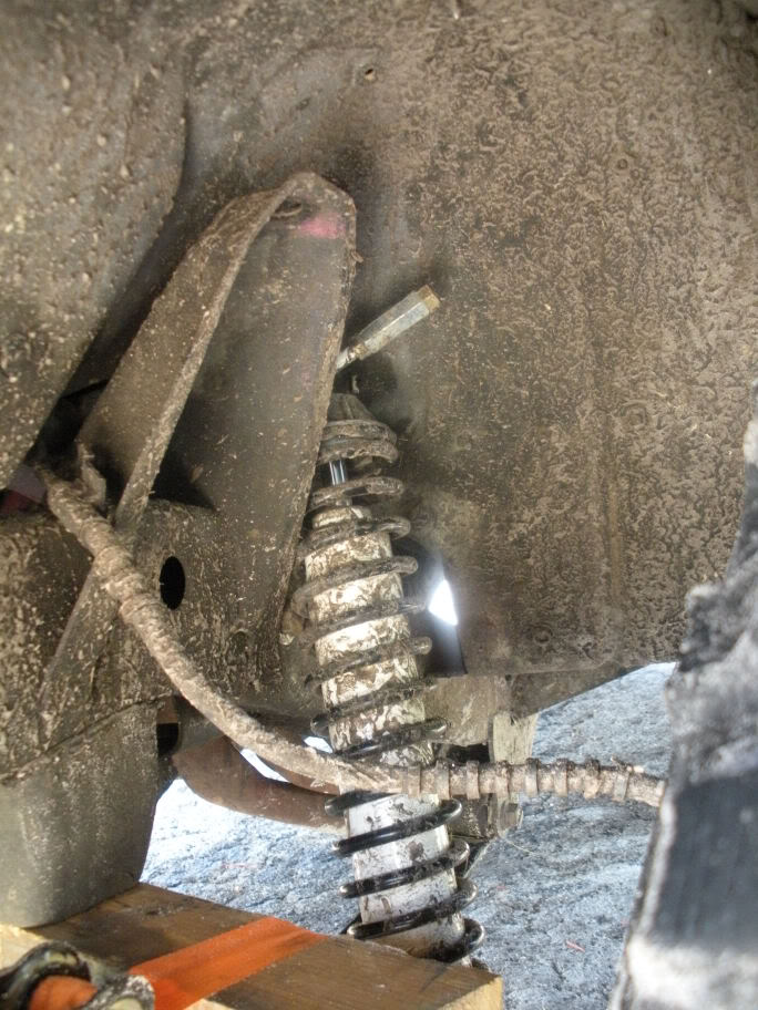

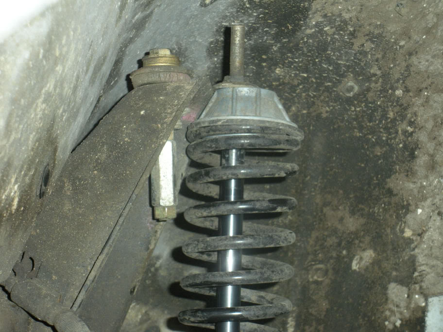

whatever you do, don't use those "shock extenders." a buddy of mine had them on his truck and broke 1 shock and bent 2 more because of that crap....
let me tell you that wasn't a very fun trail fix either.
here's a pic of the shock we replaced in the woods that bent and broke 10 minutes later.

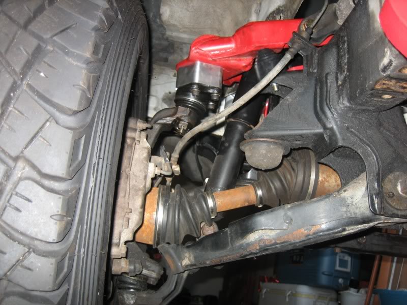

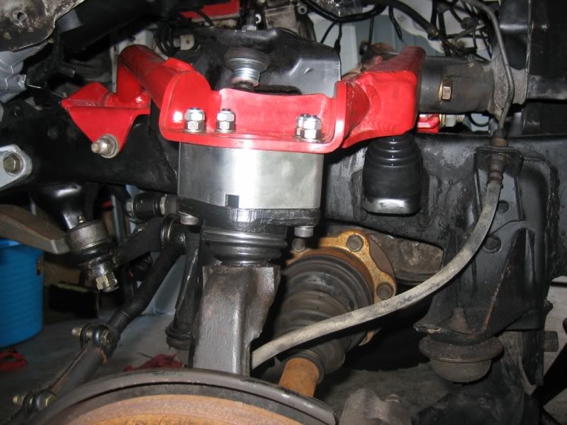

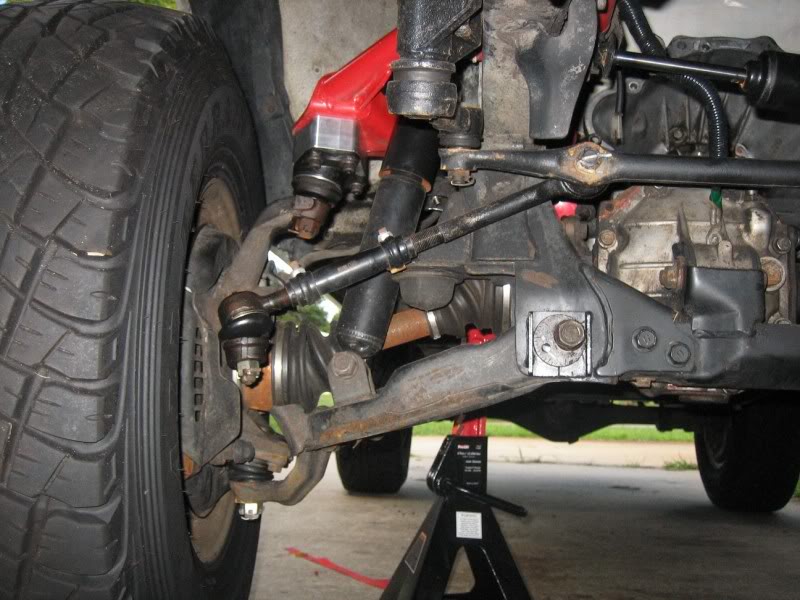

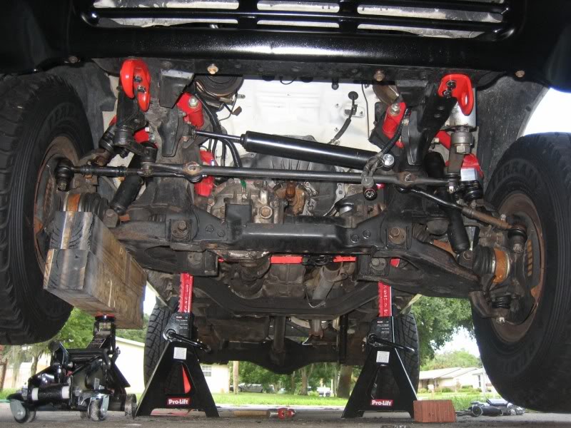

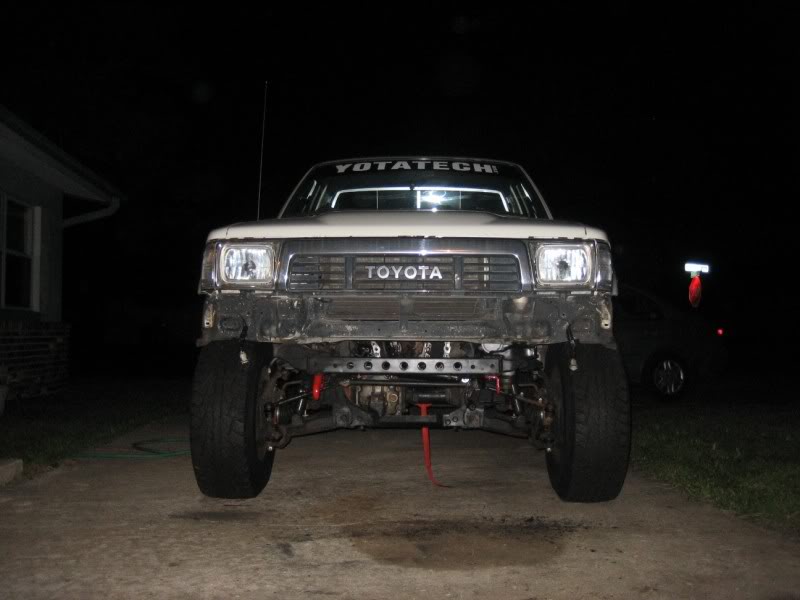

Originally Posted by mattaway
i like the color combo, but damn dude you didn't have to paint the jackstands too!
lmao, the stands came that way man
and holy crap on the shock extender!!!
no I didn't use any of those, I just used a handful of washers to lengthen the shocks about .5"; enough to still let the suspention still go to full compression it'll work fine for now

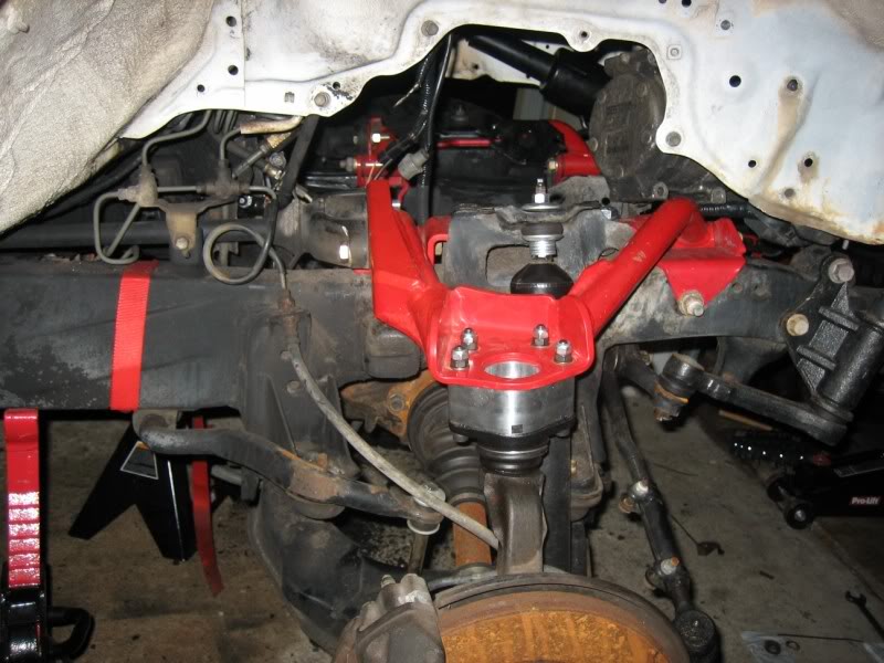

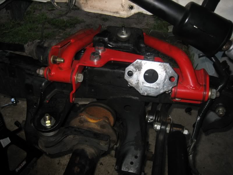

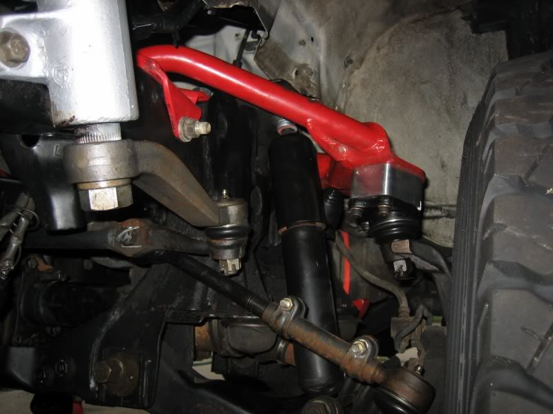

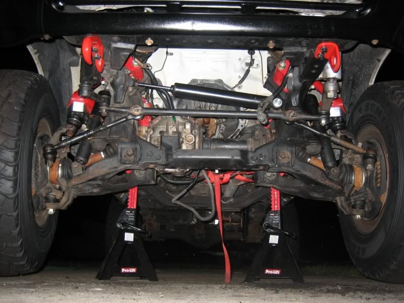

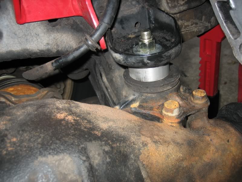

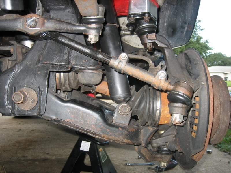

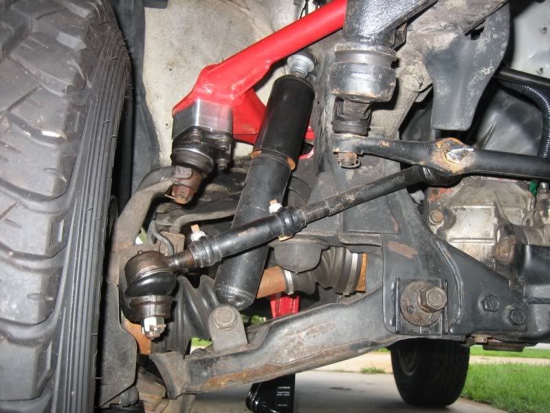

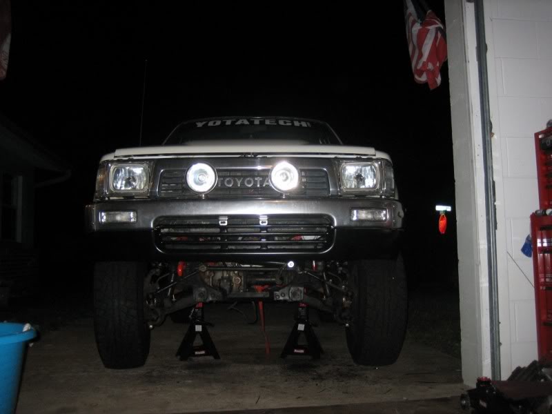

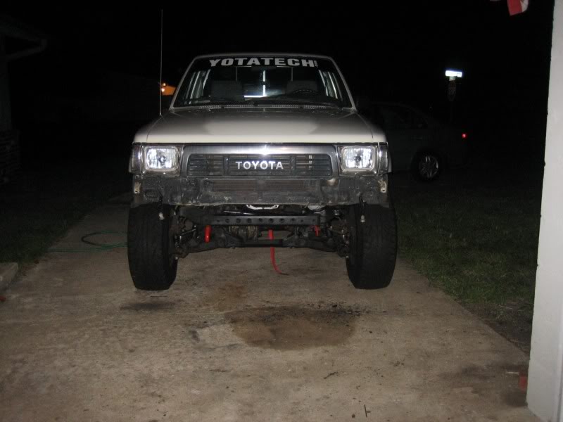

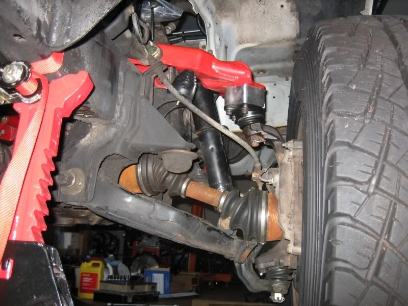

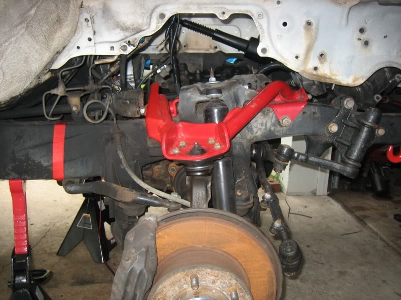

SO, I finished the rest of that little project today, aside from picking up and installing the tortion bar bolts from Toyota, which I will do tomorrow afternoon
and I know already that I'm going to need an idler arm brace very soon, cause I see this arm turning into a pretzle the first time I even hit a pothole in the road, with that crazy angle on the tie-rod, lol
she goes bump-stop to bump-stop with no CV binding; roughly 6" of travel not a whole lot, but it is IFS and with the t-bars WAY relaxed, it'll flex like a sum-b1ch
One thing you will notice is that I had to remove the sway bar, because my stupid self didn't order the 1" drops for it too when I order the diff drop a long time ago, lol. So I just added it to the "old parts" for now; it'll go back on after I order and get in the extentions
