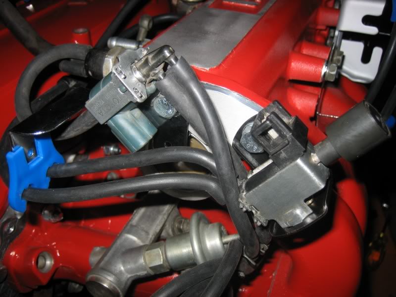

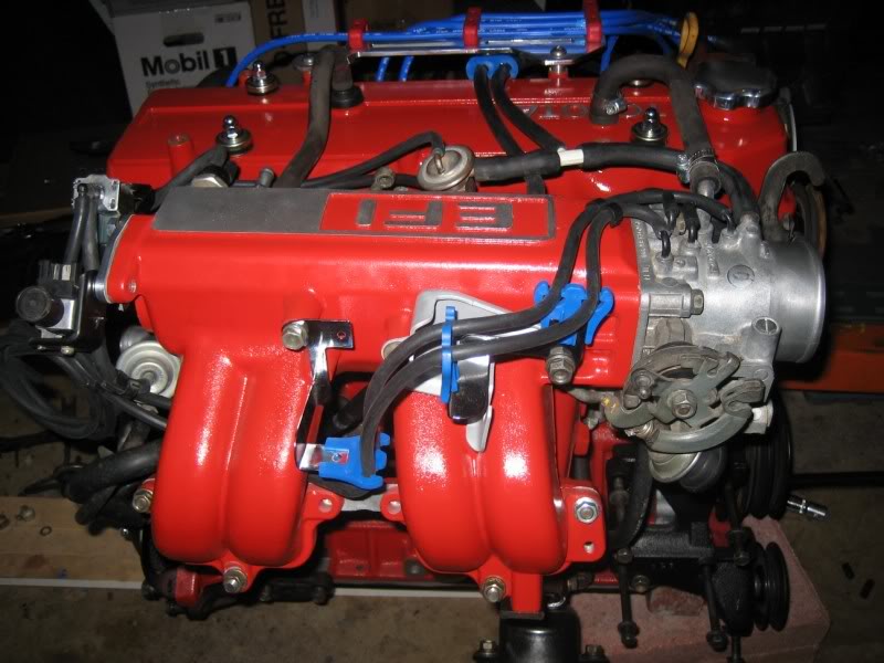

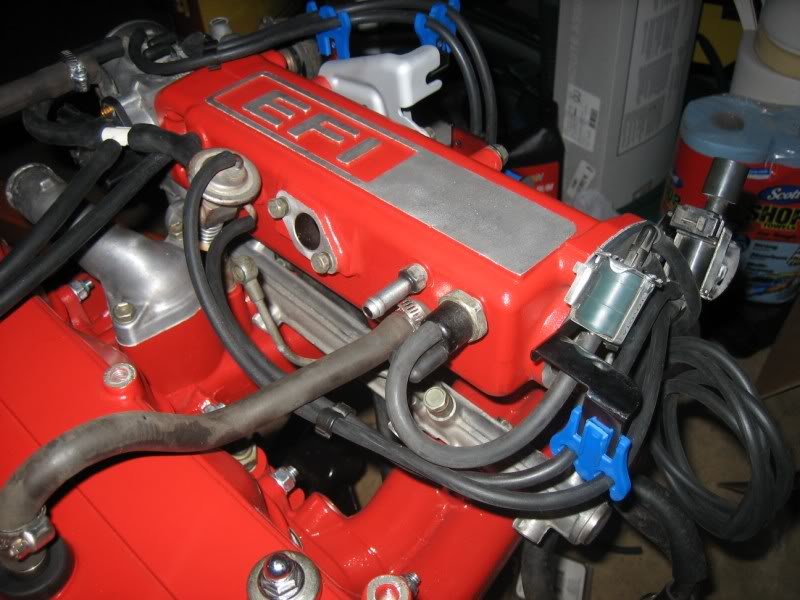

Bleeder if i may, where did you get the bracketry that allowed you to clear up the mess thats atop the valve cover, Thanks and great pics and build info you have there.
Old Nov 5, 2009 | 08:22 PM
  #924
iamsuperbleeder's Avatar
Joined: Feb 2008
Posts: 12,248
Likes: 33
From: Lake City, Fl

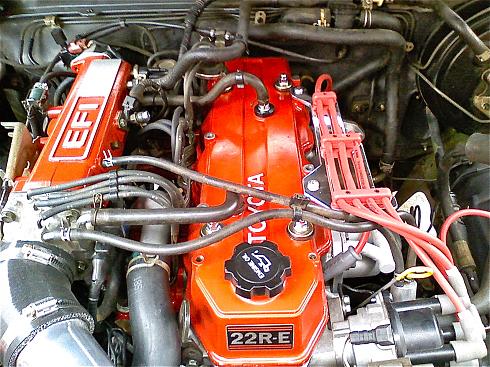

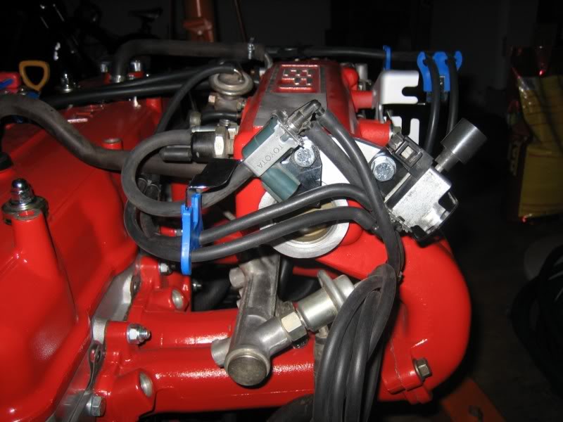

actually, there's no braketry involved, unless you're referring to the ones holding the vacuum lines to the side of the upper intake
I lost a lot of the mess when I got rid of the EGR valve; that removed one VCV, and the little plastic disc-shaped thingy that clipped into the metal bracket bolted onto the top-rear of the valve cover. The only other two things up there, the VCV for the AC idle up and the one for the fuel pressure regulator, I just rerouted the new vacuum lines to the back of the upper intake manifold, and mounted them using the same bolts that hold the EGR block-off plate to the back of the upper intake.
As far as those brackets holding the vacuum lines in place on the side of the upper intake, those are actually spark plug wire holders, for a small block chevy, that I just had lying around in my tool box

And know the question is, is the EGR / VCV expendable? And thanks for the clip selection link and pics.
Old Nov 5, 2009 | 08:51 PM
  #926
Joined: Feb 2008
Posts: 12,248
Likes: 33
From: Lake City, Fl
Well, I can't say of any gains or losses from it really I did so much to the motor at the time, that it's really hard to say if it did anything positive for the motor, lol, accept for cleaning up under the hood a little maybe. But in the past, I have tried to bypass it by pulling and blocking off the vacuum lines, and that actually caused the motor to run hotter than normal (which is not uncommon), so I hooked the lines back up and made the EGR valve functional again, and the temps went back to normal. With this electric fan setup I have now though, that hasn't been an issue.

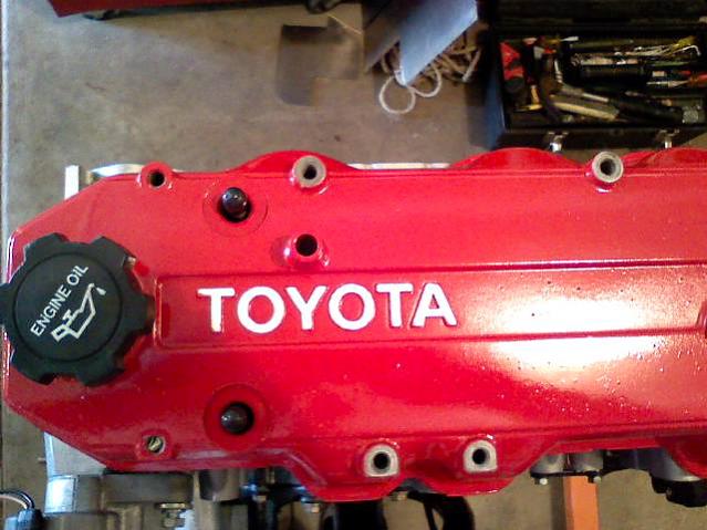

Hi, Bleeder
I bought a truck back in may of 2009 and I rebuilt my engine but I took the looks of yours and did my engine.
Attached Thumbnails Bleeder-Dude's Official 22re Engine Rebuild Thread - TONS OF PICTURES!!!-0812092053-00.jpg   Bleeder-Dude's Official 22re Engine Rebuild Thread - TONS OF PICTURES!!!-1225091501-00.jpg   Bleeder-Dude's Official 22re Engine Rebuild Thread - TONS OF PICTURES!!!-1225091501-01.jpg

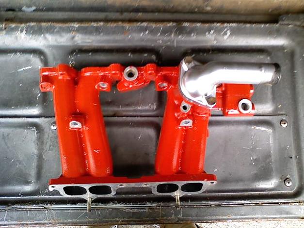

Here is some more pictures!
Attached Thumbnails Bleeder-Dude's Official 22re Engine Rebuild Thread - TONS OF PICTURES!!!-0805091100-00.jpg   Bleeder-Dude's Official 22re Engine Rebuild Thread - TONS OF PICTURES!!!-0805091109-00.jpg   Bleeder-Dude's Official 22re Engine Rebuild Thread - TONS OF PICTURES!!!-0805091405-01.jpg

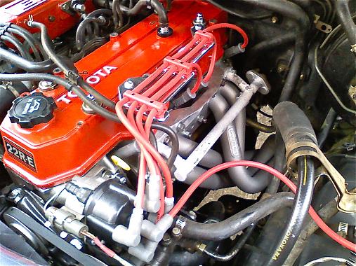

From: B.C. Canada
hey bleeder i have a question lol i just got a pacesetter header on mt 22re and i have some really loud exhaust leak sounds? like i know i had an exhaust leak between the down pipe and manifold and i thought with the header it would delete the exhaust ting sound? nope it's worse. my dad had a shop put it on and it looks like they did everything right but all i get is a hell of a ruckes from my header???? lol oyah and just like yours the paint is already pealing lol. so i guess im asking you if i should question the shop or is this header just super loud? sounds good coming out the tail pipe though and i noticed some power gains
Old Mar 11, 2010 | 02:15 PM
  #933
Joined: Feb 2008
Posts: 12,248
Likes: 33
From: Lake City, Fl
honestly, the PaceSetter header is exactly as it costs... cheap...
I mean, it serves its purpsoe I guess, but mine leaks like crazy right now, and I've gone though 4 or 5 head-mounting gaskets now...
I'm going to replace it with a thorley tri-Y shortly
awesome ... i was supposed to get the LC stainless header but my dad ordered the pacesetter. didnt complain because i got it for christmas lol so no complaining there but, i didnt expect it to leak worse than before, so i guess i should leave my dad out of things involving my yota lol.
Old Mar 11, 2010 | 04:15 PM
  #940
Junkers88's Avatar
Joined: Mar 2008
Posts: 4,371
Likes: 6
From: Texas
No worries on the Pacesetter. The LCE header that I have needed some..... trimming to get rid of the leaks. What you might have to do is grind a little off of the bottom edge of the mating surface where the header meets the head. Just trim a very small amount at a time. When I did my LCE I finally ended up running two gasket sets and coating them in Copper Coat. It still leaks a little but I've been too lazy (and cheap) to buy four more gaskets and re-trim the header.
