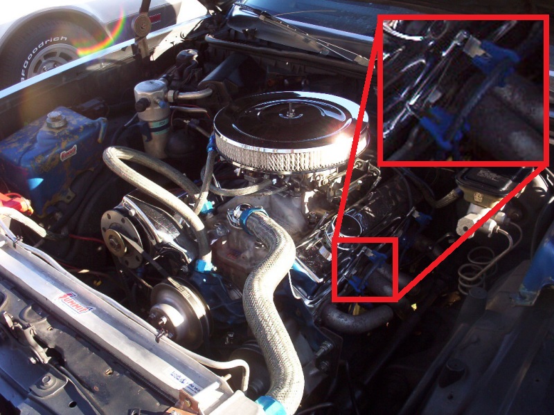

Although I don't agree with Chevy parts on a Yota that looks freaking AWESOME!!!! Did they all just bolt up or did you have to drill and tap anything??
Oh and next time you do this (300,000 miles from now) go with blue vac hose. It'll look flat crazy!
nope, no modifications required; just bolted right on they're pretty universal, although they're most commonly used on small block Chevy motors, and secure with the valve cover bolts to hold the spark plug wires up and away from the headers; I had them on the motor in my Monte Carlo I had before this truck

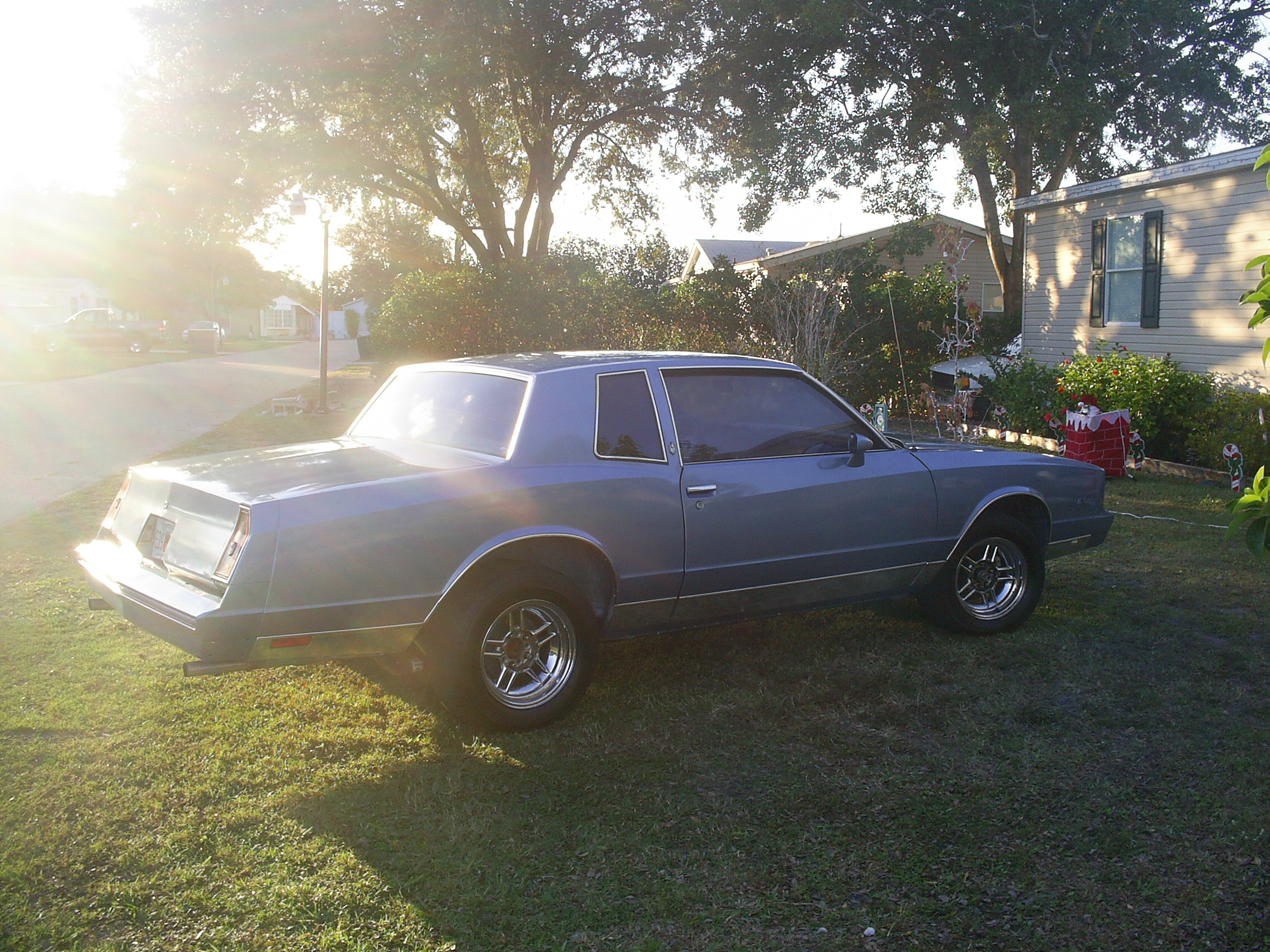

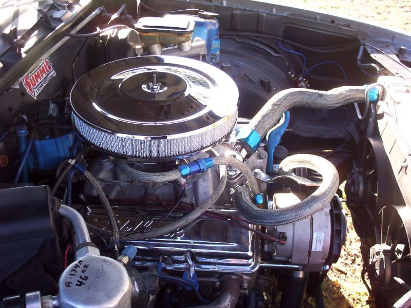

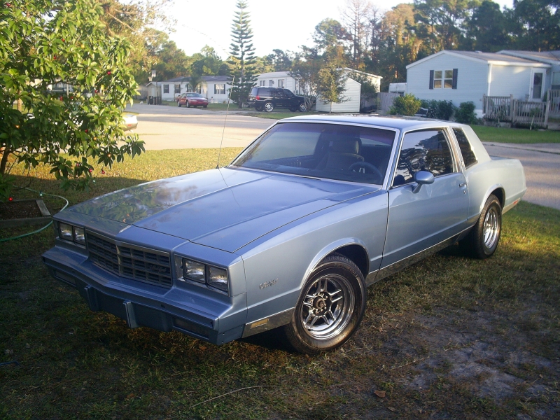

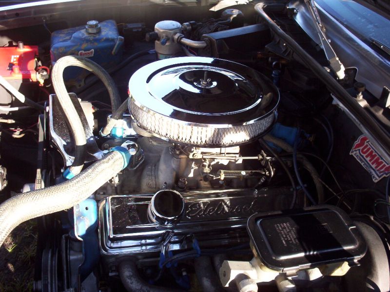

and yes, that car was a daily driver; an absolute BLAST to drive but expensive at the gas pump, lol
