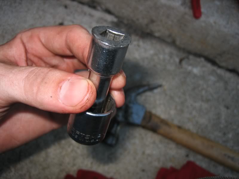

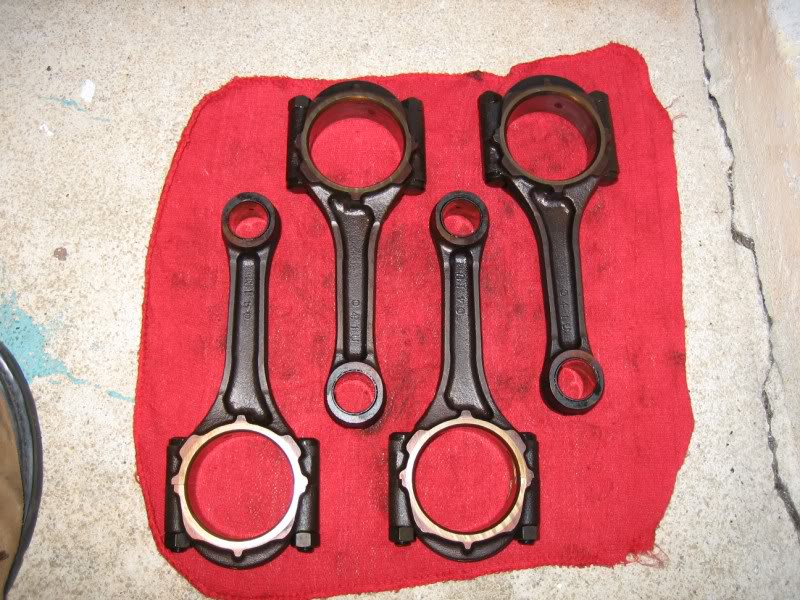

So it turns out that the old pistons and rods were quite easy to separate
AND, with a little coaxing (with the help of the perfectly sized socket and a hammer) the wrist pin bushings come out too
Kinda ruins the extention used with it though
but that's ok; I'll just set it beside the one I ruined using as a "brass drift" to pop the cone washers out of my hubs, lmao

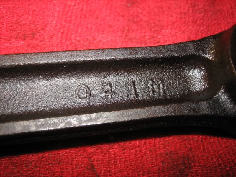

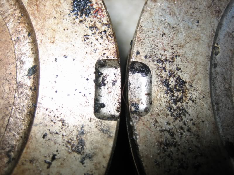

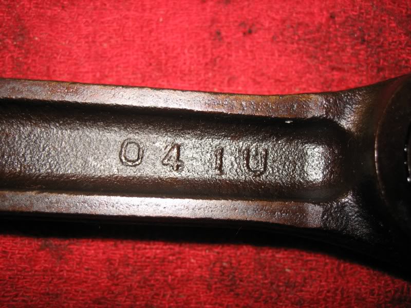

But after looking at these things after a little disassymbely, I notised 2 things...
First there one rod with a different marking than the other 3
Three of them have the number "041U" formed on it:
and just ONE of them has the number "041M" on it
Any idea what that's about?

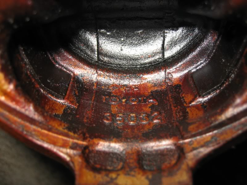

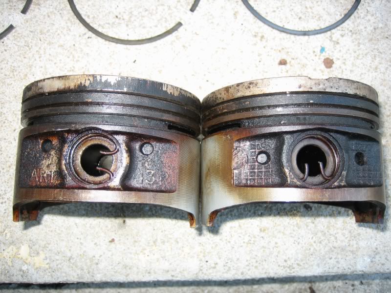

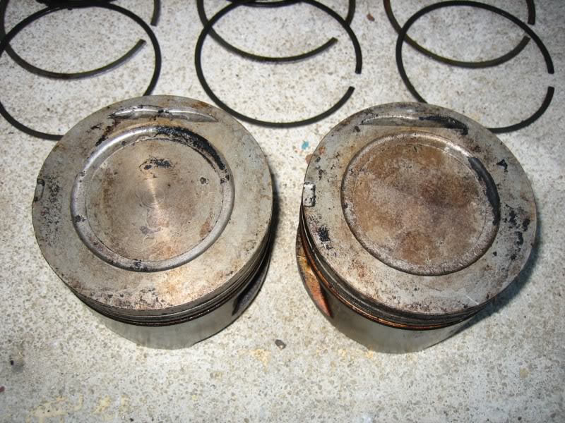

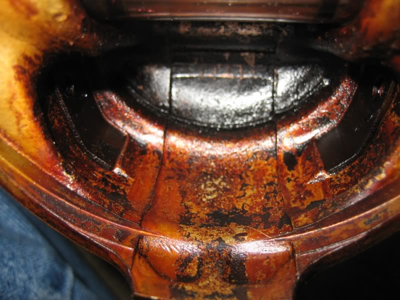

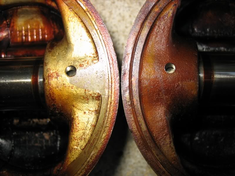

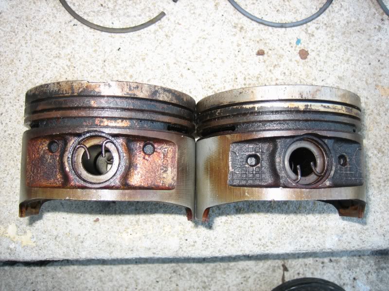

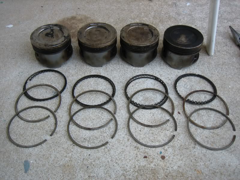

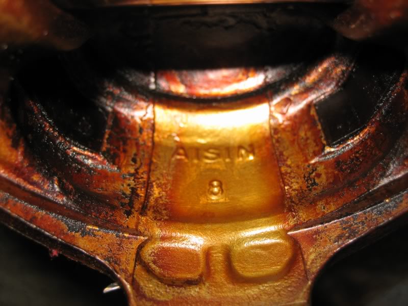

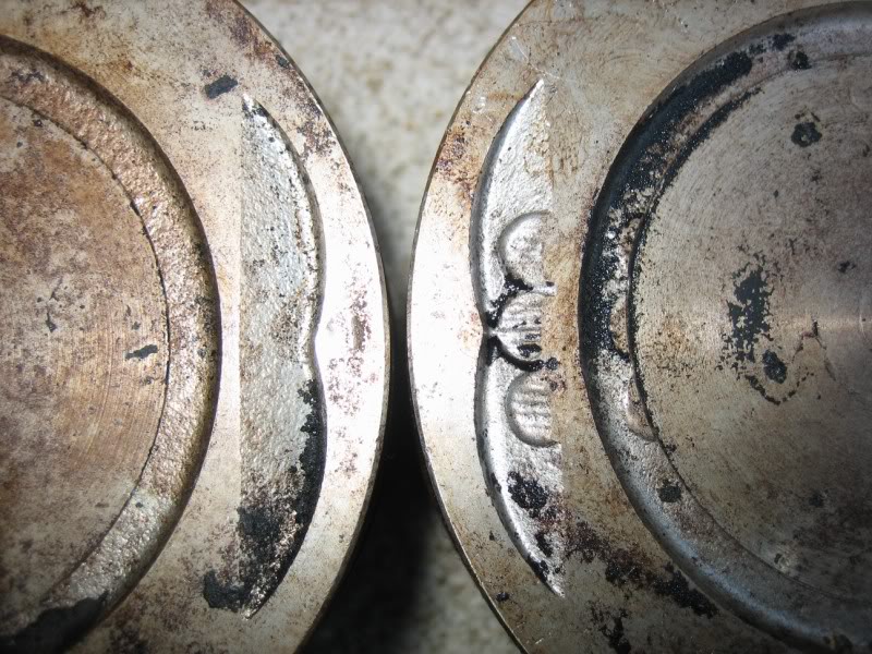

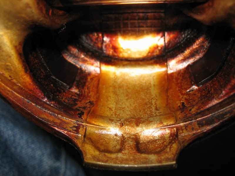

But that's not the strangest thing I noticed... the strangest thing was the pistons...
It looks like there's 2 of one type, and 2 of another! I'm not sure what to think of this... I'll let the pictures explain:
Maybe it's nothing, maybe it's more I have no idea, but it went 296k like that, so I guess no harm, lol

Wow great pics!! Hmmm shiny stuffs!! Weird about the pistons, I have now idea if mine had dissimilarities...I guess I didn't OBSESS over it!! LOL!!!

they both have Toyota in the cast, and one type has Aisin in the cast too, so they're definately original, it's just strange...
oh well, at least all the new ones match, even if they don't have "TOYOTA" casted into them

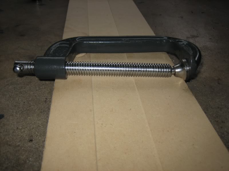

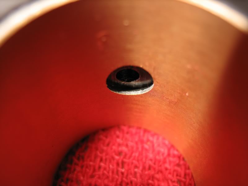

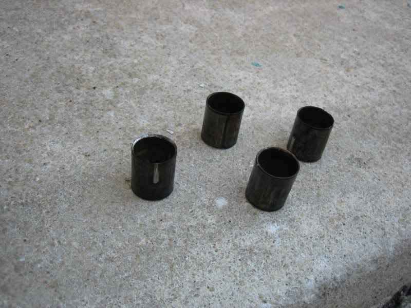

well, mission acomplished, mostly

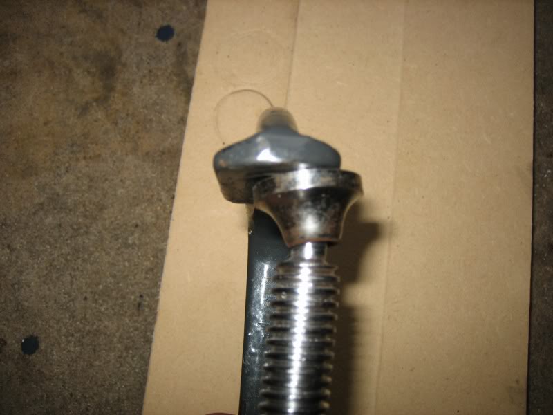

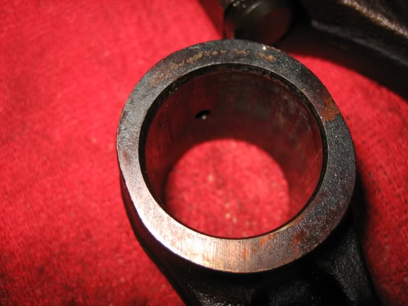

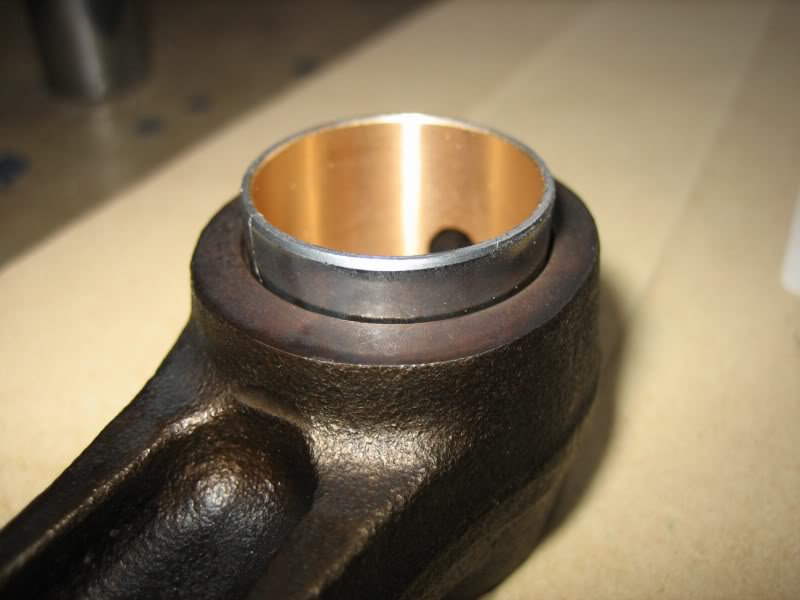

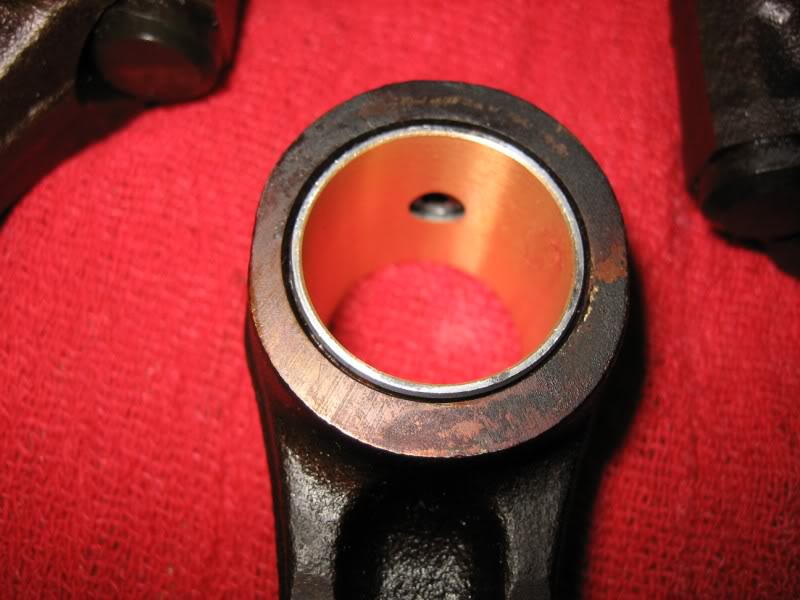

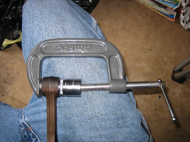

I got the new pin bushings into the rods, but without the heating technique. I tried the heating with a torch first, but that got me no where those little thin bushings heat up pretty much instantly once they come in contact with the heated rod, so it doesn't make that much of a difference, unless you could do it really fast, lol

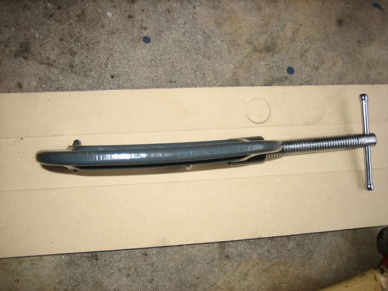

Instead, I tried a different approach:
Actually worked great! Untill when almost at the end of the first one, my clamp decided that it wasn't going to take it

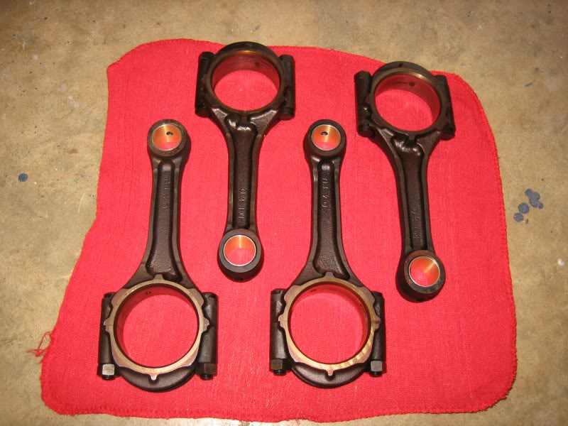

So, I stopped that before I fubared the bushing, and rode up to the parts store where I use to work, and where I'm still good friends with all the guys that work there, and used their press real fast, and knocked em all in under 5 minutes, lol
and yes I got all of the oiling holes lined up perfectly too
So I have the block strapped to a pallet in the back of the temp-truck with a tarp over it, and the crank, the new pistons, freeze plugs with wrist pins, rods, and main caps all in the floorboard, and providing I actually get off work on time tomorrow, I'll drop everything off at the machine shop
