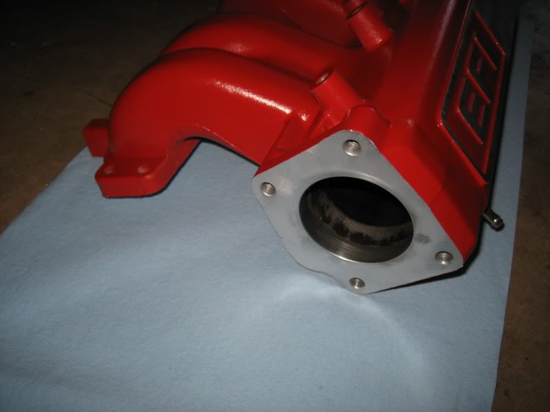

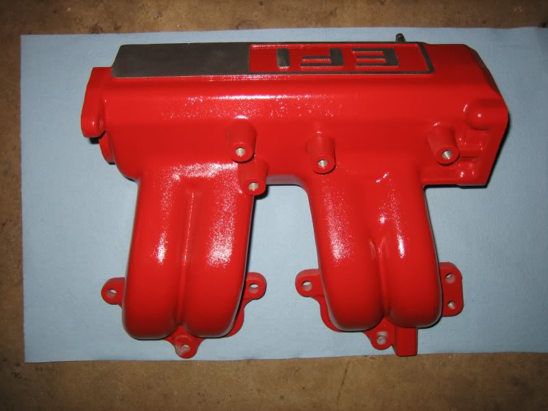

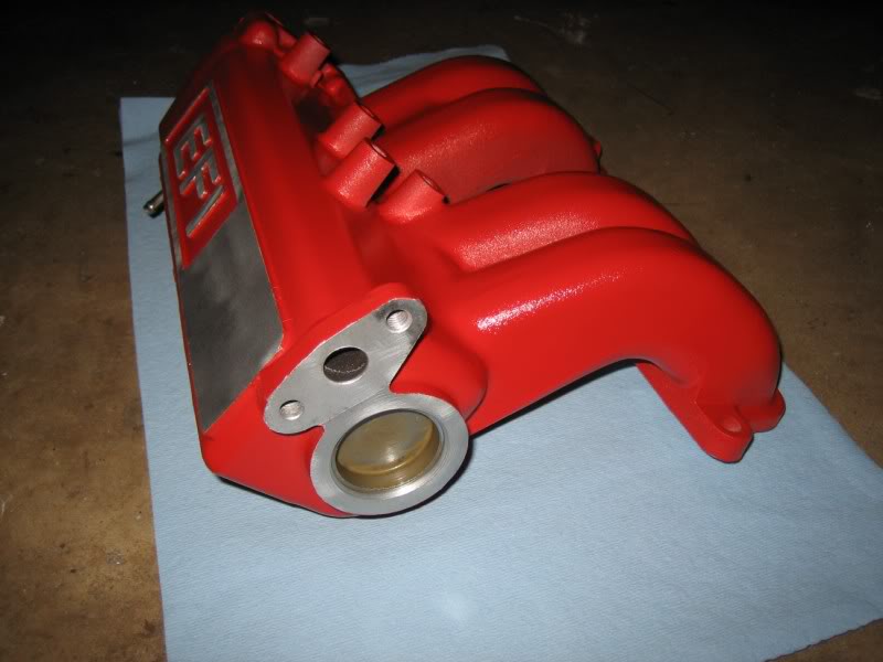

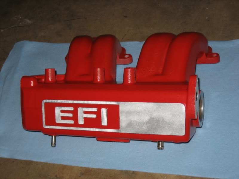

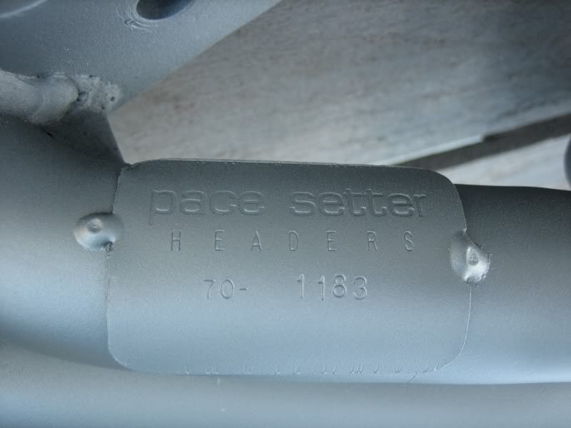

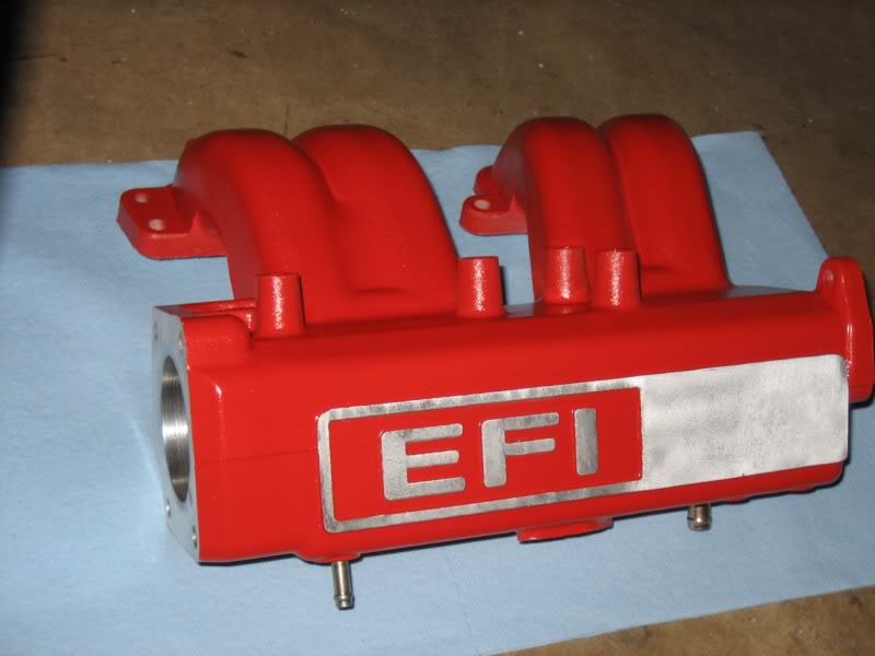

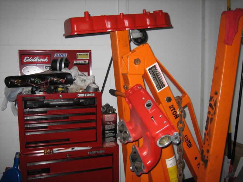

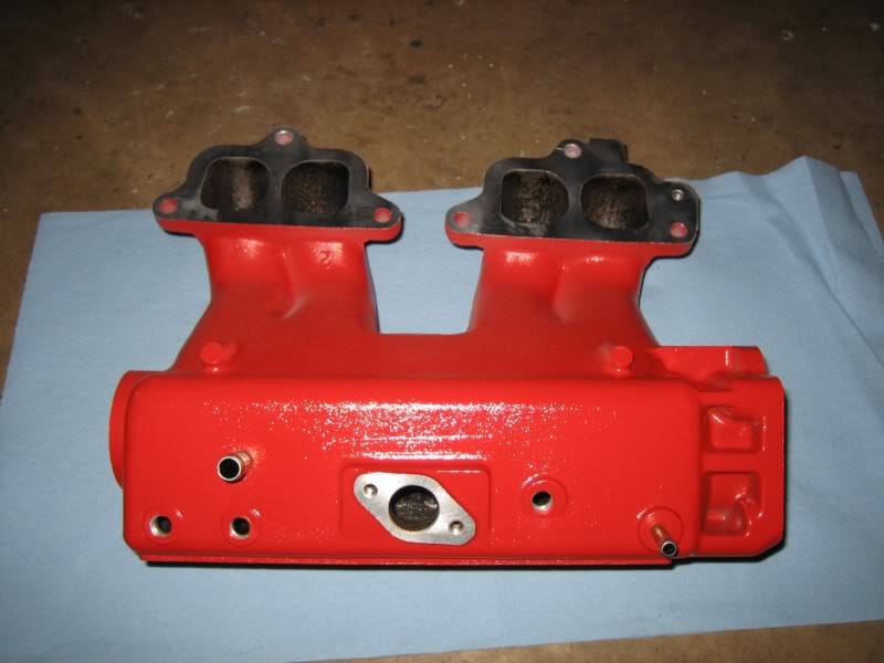

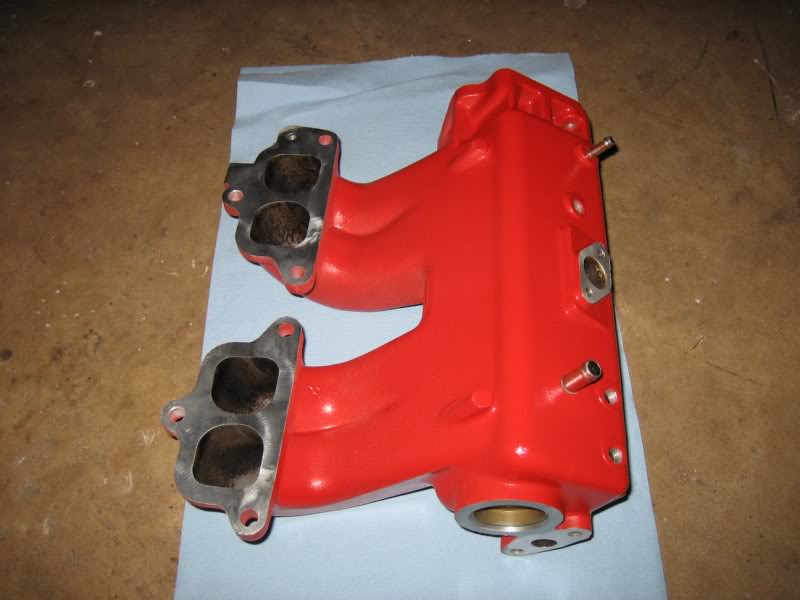

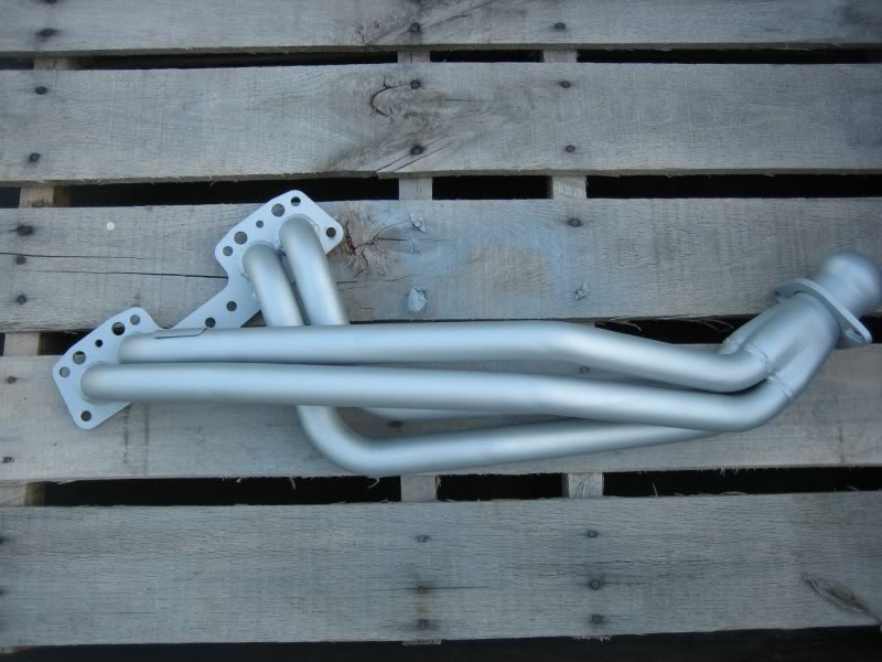

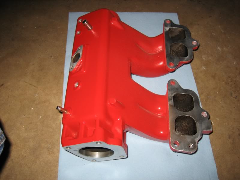

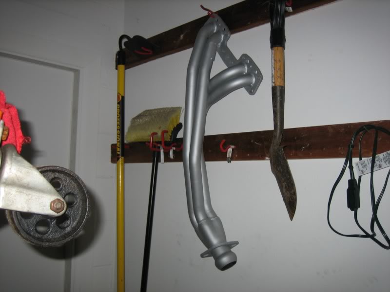

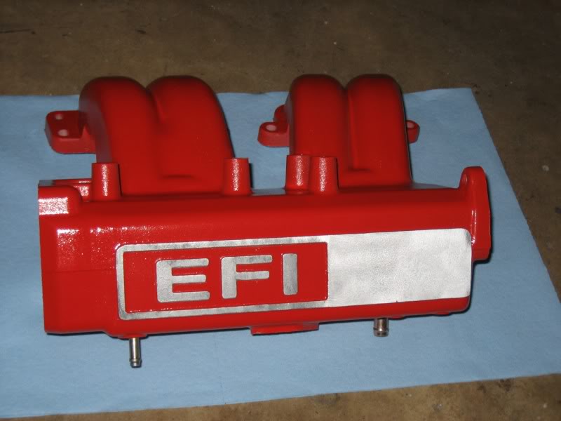

got a lil more cleaning and paint work done today
and so they shall "hang out" and cure for a little while
Not bad fer the ol right wrist and a rattle can eh?

Man that stuff sure is purty!!!
What did you use on the header?
Thank ya!
I used VHT Header Paint
The stuff lays on pretty good! I scrubbed the entire thing down with a red scotchbright pad, gave it a coat of brake cleaner to get any dust or residue off, loosely bolted it to my engine stand, and gave it about 5 light coats it should hold better than that crap Pacesetter puts on them
And the manifold; that consisted of a thorough cleaning with a degreaser-soaked scotchbright pad, a rinse off with water, wire-wheeling the "EFI" lettering and raised area on top, then a coating of brake cleaner to remove anything left. Then taped off all the openings I didn't want paint on, and masked off and cut out the "EFI" letters and raised area on the top, gave a few light coats of self-etching primer, them about 3 coats of the Chrystler Red engine paint (same as the valve cover), followed by 2 clear-coats for that extra shine and durability

HEY, not a bad idea... HAHA, no... It's going to look good, and it's going to perform good, but I'm not going to rice it out, lmao
Also, unlike most people apparently do, I plan on painting the lower intake too
