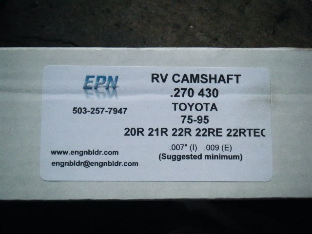

Got this in the mail today took less than 24 hours to be at my door:
I hope I dont always wonder and wish I went with the crawler 261 profile
have fun picking out your build goodies!
