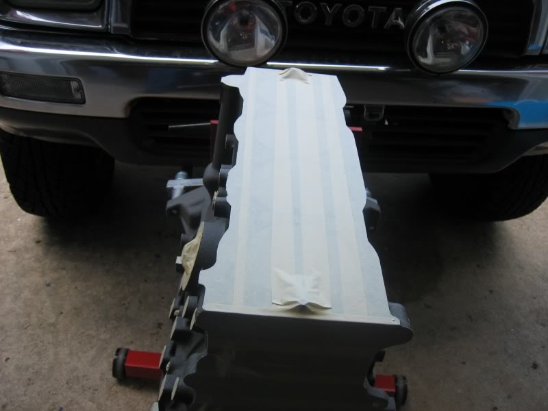

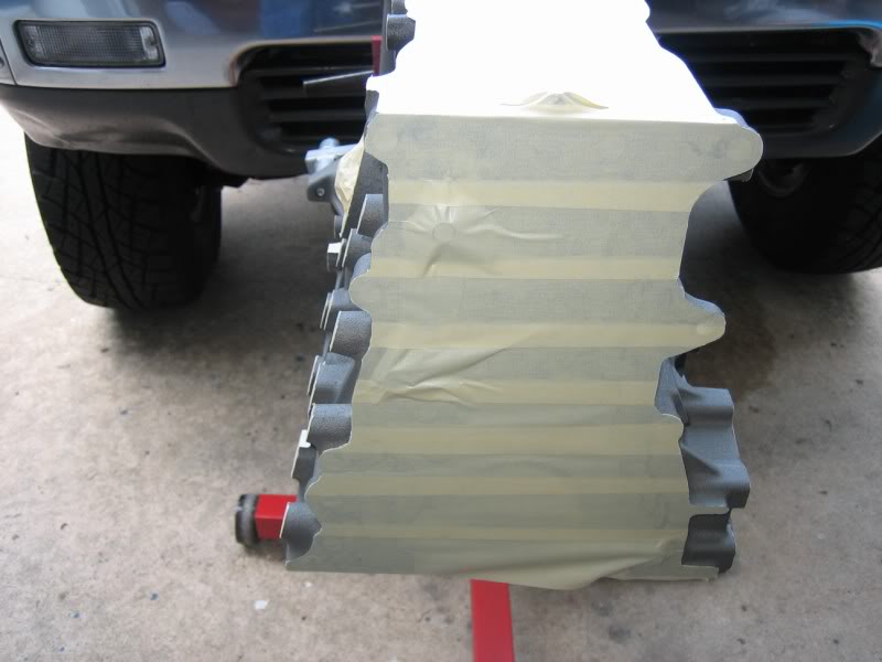

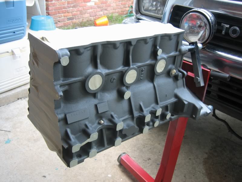

well, I started taping off the block (the head surface, the already installed brass freeze plugs, and all the points on the sides where any accesory or sencor bolts to it), and almost got done, and I noticed the wind picking up (looked like the tree in my front yard was about to up-root, lol), and then I heard some thunder... looked down the road, and here come's today's shower... I hate Florida this time of the year... it's either 120 degree and 90% humidity, or it's 100mph winds and 20 inches of rain
but I did run up to the store and order my main beaings, thrust washers, and rod bearings, so they'll be in Monday and I can begin assymbely, since the paint will get done tomorrow.
I thought that the lower intake was hard to prep for paint...huh, yeah, ok... nothing compared to the block, lol (and I'm a little OCD, so that makes things twice as hard, lol)

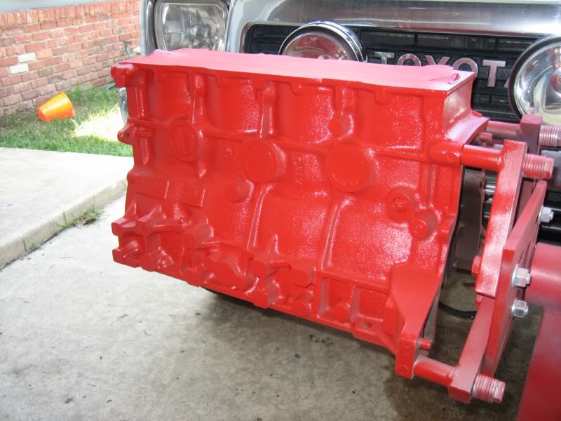

Well, after flipping through a Haynes manual I have, it actually does say to give the motor several WOT runs once the engine warms up for about a half hour IIRC, and then drive it easy for the next 500 miles, change the oil, then drive normal for the next 1000 or so, then change the oil again, and by then you can consider the engine fully broken in. To be honest, that sounds logical, because it combines both methods...
few more pics of progress today

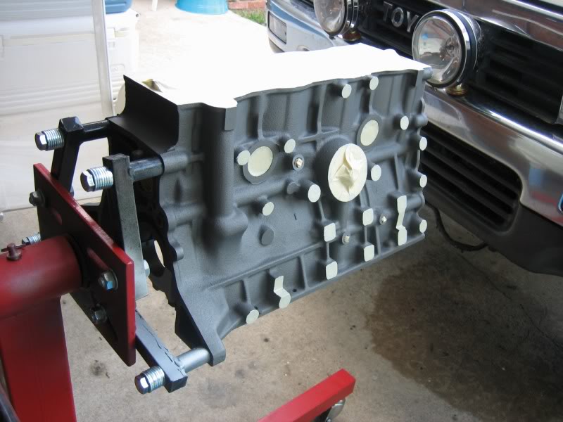

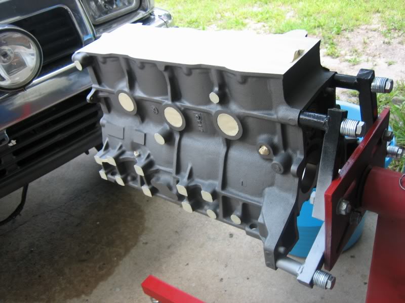

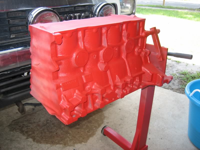

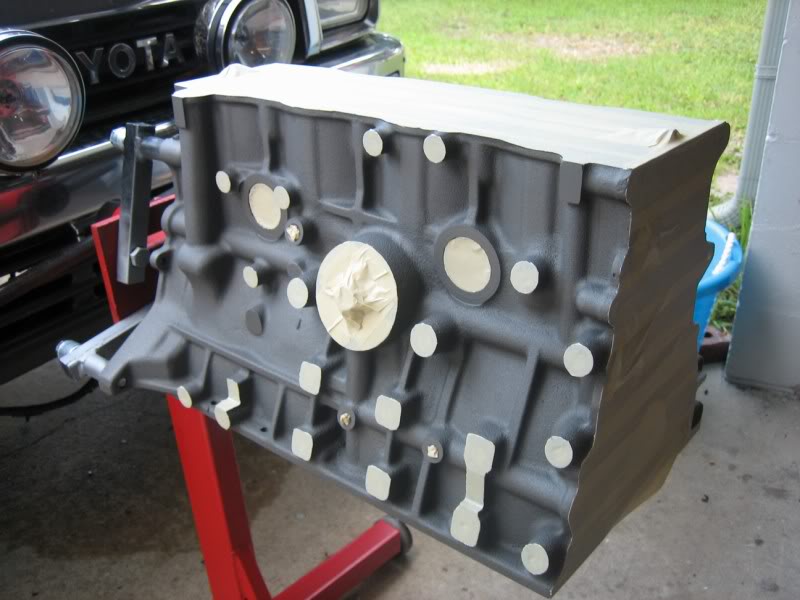

shot some primer and paint, and while waiting for it to dry, I went ahead and assymbled the pistons and rods
aaaaaaaaaaand, back to that block

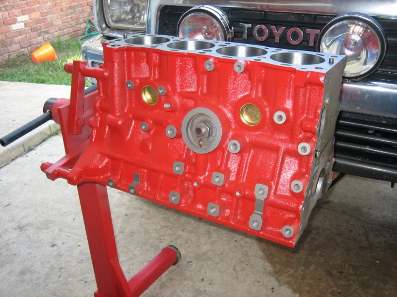

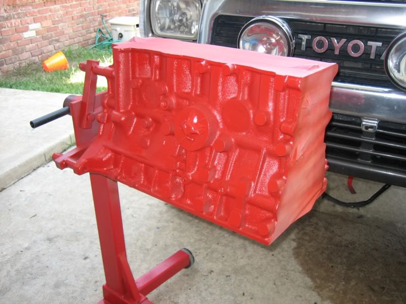

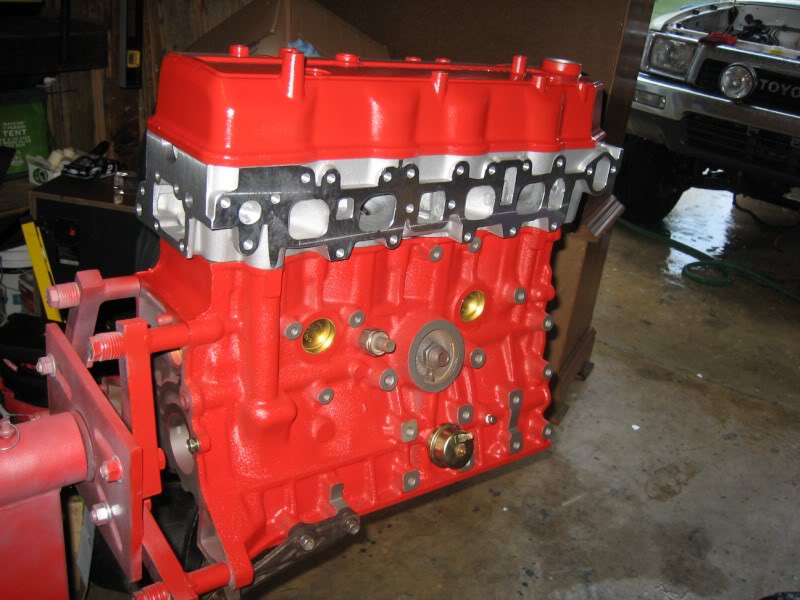

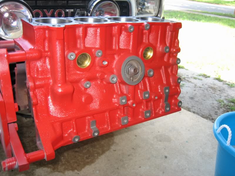

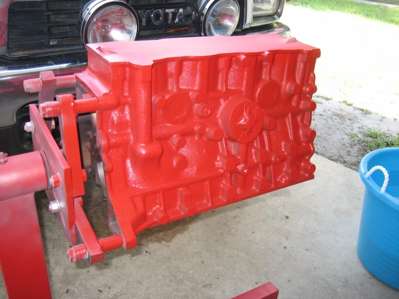

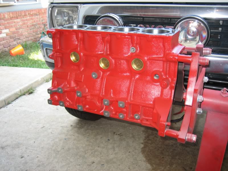

once I felt the paint was dry enough to start messing with, I removed all the taped off portions:

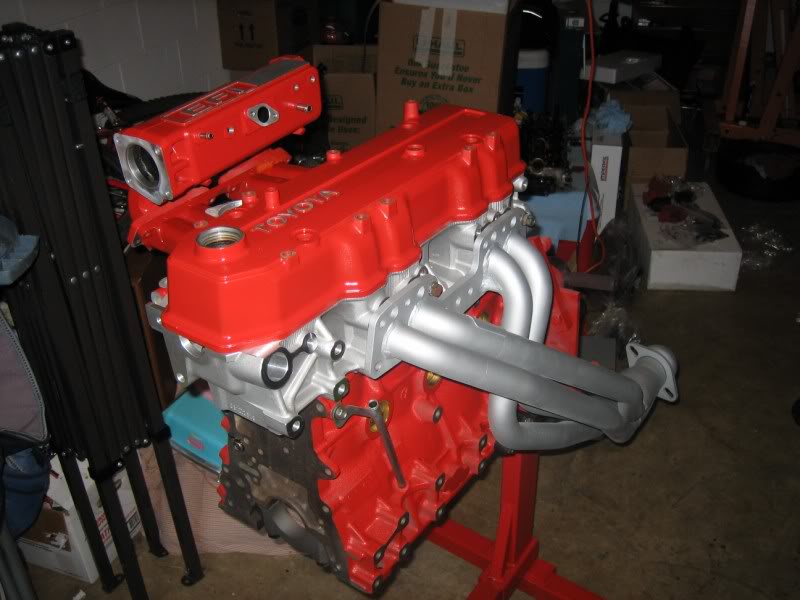

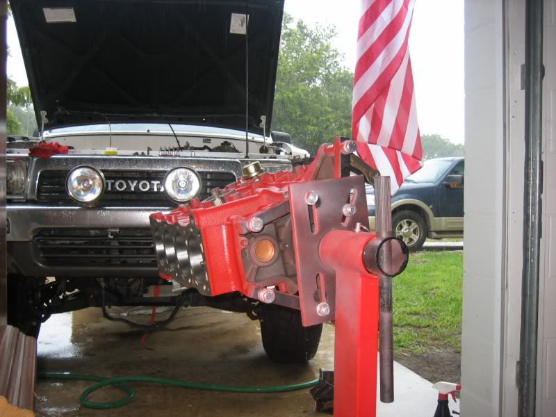

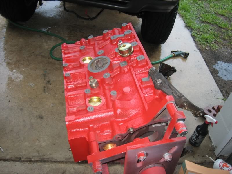

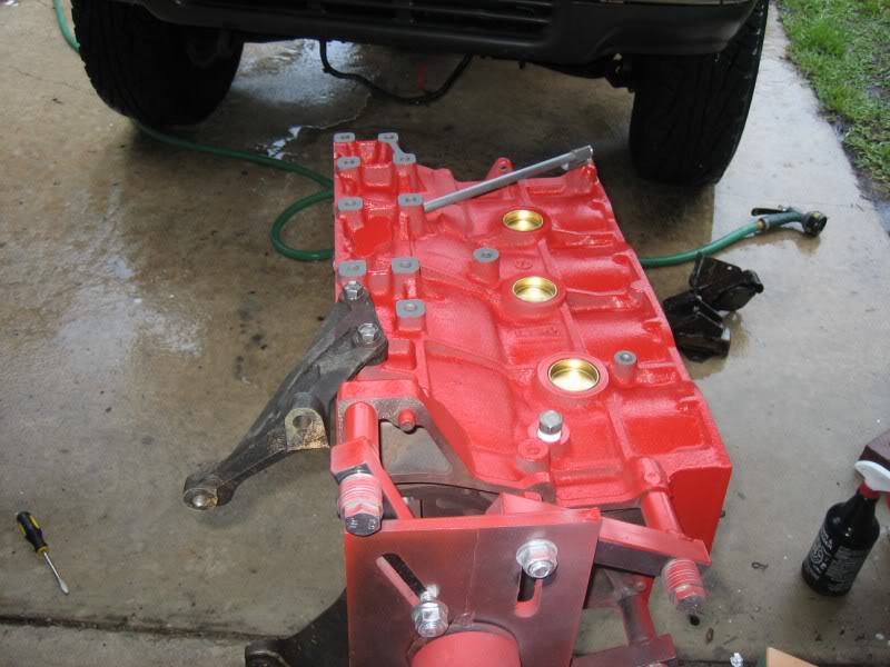

and I started to bolt a few things on, and again... IT STARTED RAINING...

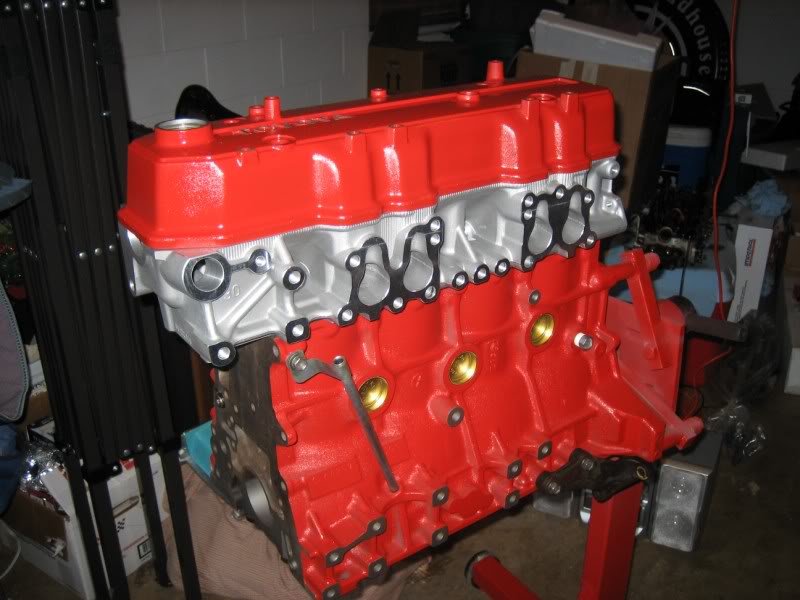

and because I see some of you are growing as impatient as I am, how's about a "Bored While It's Raining" mock-up
are you ready for this?

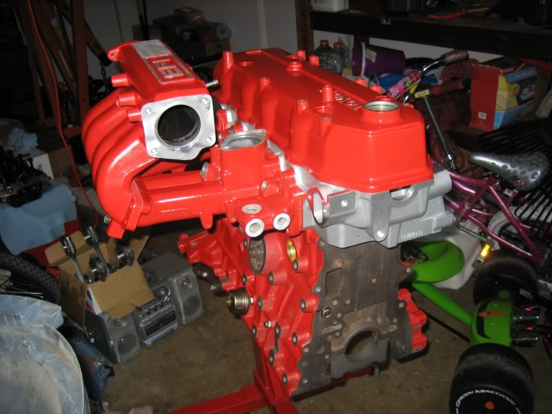

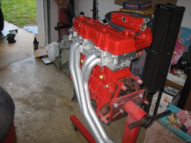

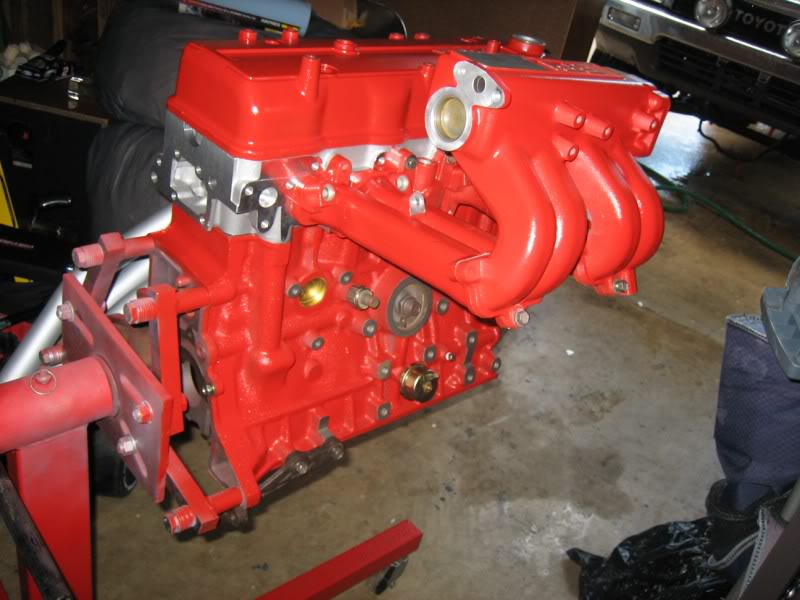

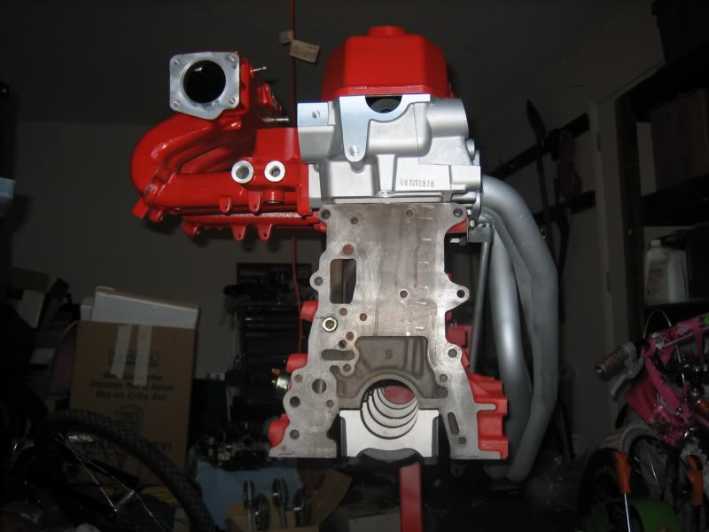

I had to mock it up real quick, just to see how things are going to turn out in the end; I must say, I was pleased with the result

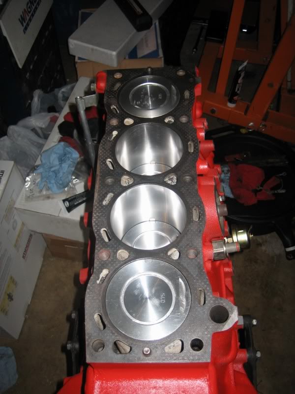

Are you planning on mocking up the crank w/ bearings, rods, and pistons to check deck-height? Since the aftermarket pistons are de-stroked a bit, my deck-height was .018 above the piston. EB says stock is .000 to -.006. I had my machinist shave the deck .018" but forgot to include the timing chain cover, so that had to be done later as a separate part. Just fyi, if you're going to try and get it back to zero deck-height, bolt on the cover when you send it in.
hmmm, good point, thanks!
we'll see where the pistons sit at TDC tomorrow when I pick up the bearings

haha, oh no, it wont be done by next weekend
I still have quite a few things on the list...
If not tomorrow, by Tuesday I'm getting the injectors sent out for rebuild.
I still have yet to buy a replacement updraded alt, but money's getting tight now, and I might put the original back on in the begining, because that a rather simple swap later.
The BIGGEST thing that's going to hold me back right now, is the order I'm placing with LCE, which includes the clutch kit, all th block-off plate for the emmission crap, intake and exhaust manifold stud kits, and a bunch of other little odds and ends...
My BEST estimate is one more month, if you can believe that...
remember, that pic was ONLY A MOCK-UP, just to see how the new and painted parts are going to look...

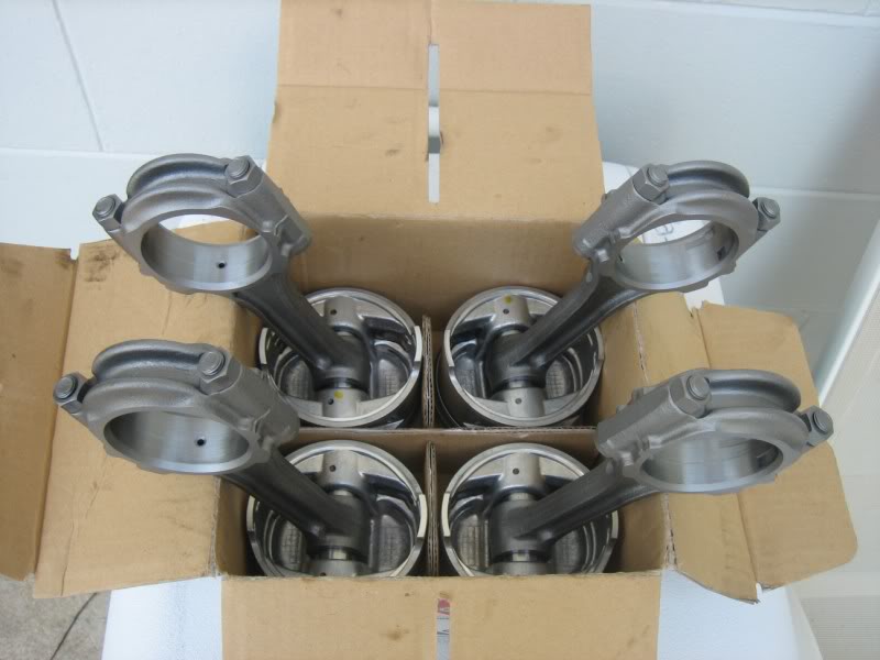

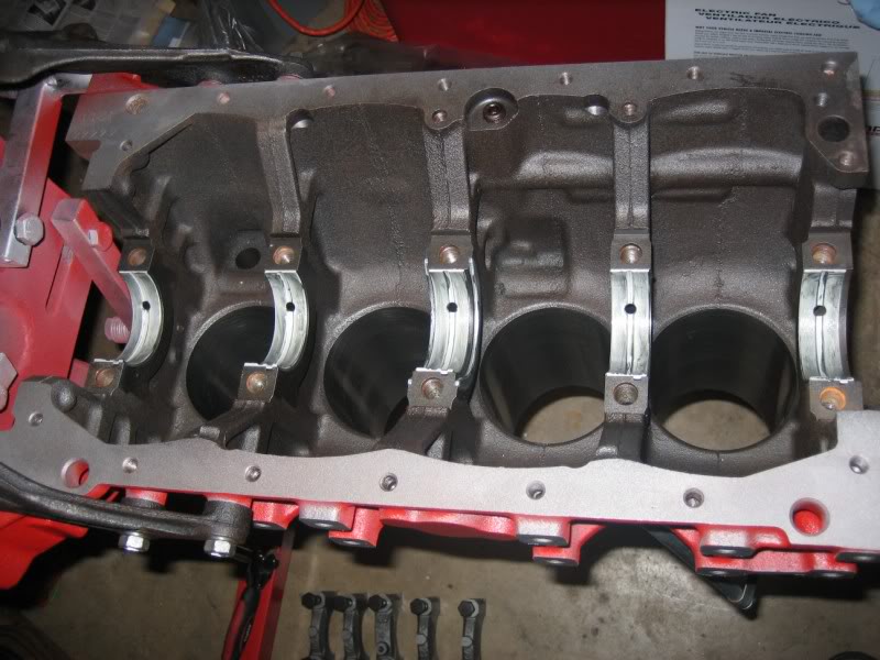

well, I didn't get home untill freek'n 7:00PM lucky little brother had to run his sister's rented table cloths for her wedding an hour and a half accross down to return while they're off on their get-away in Tenessee

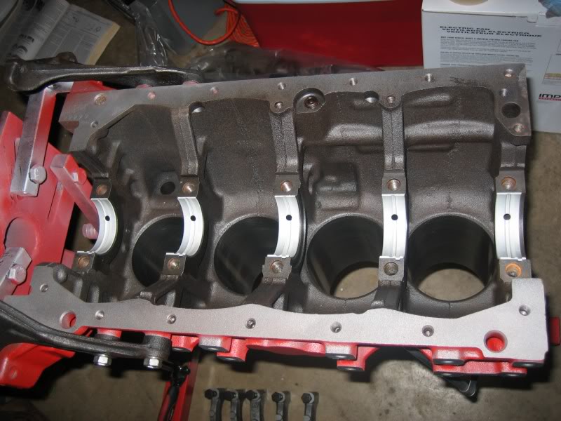

BUT, I stopped on my way home and picked up my mains, rods, and thrust washers

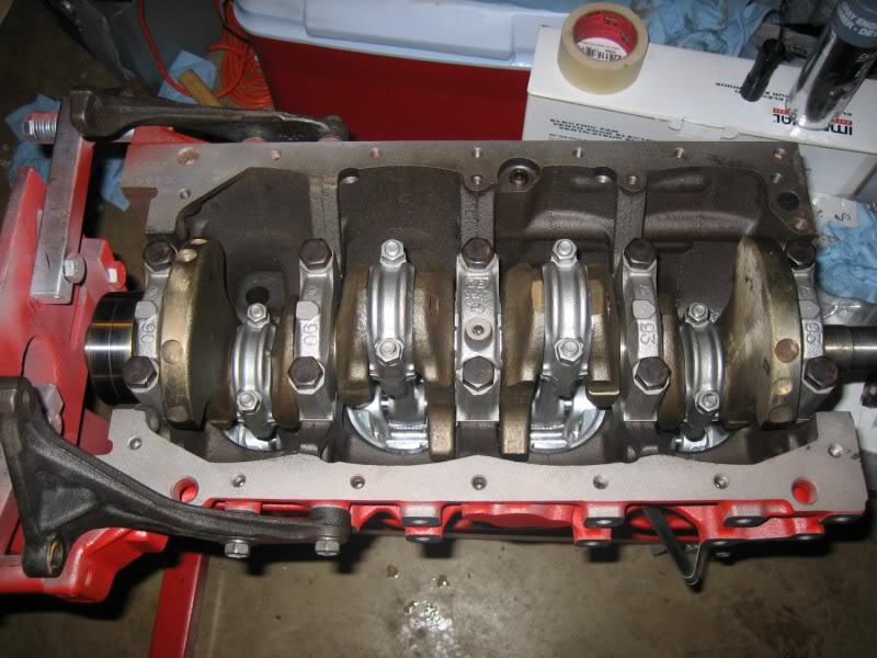

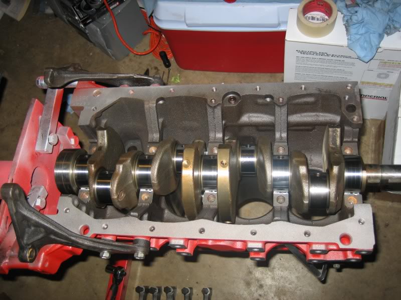

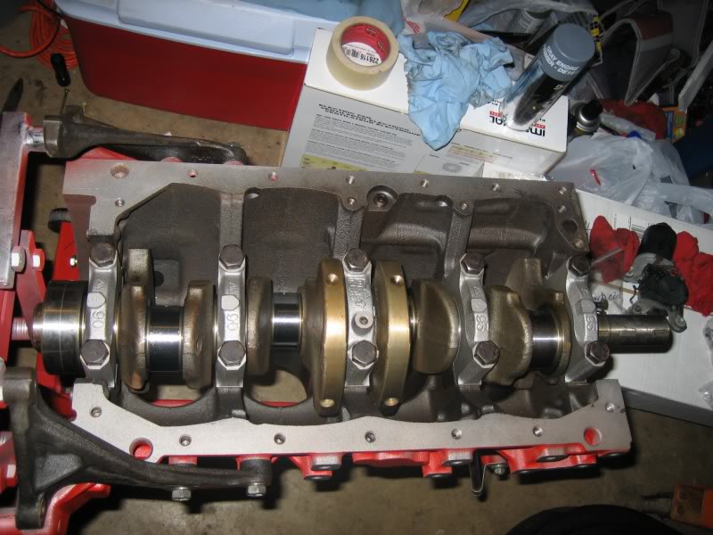

layed the block mains in
followed by the thrust washers and a good coating of moly lube
layed in the crank

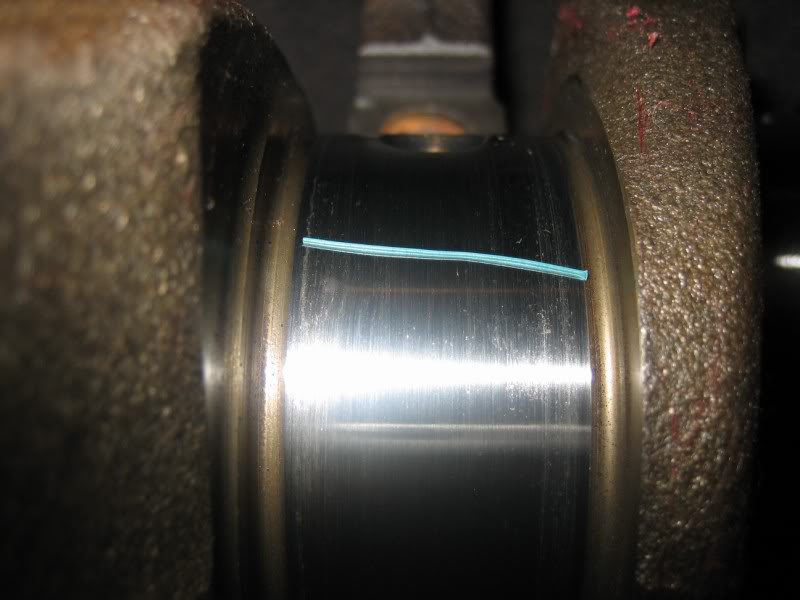

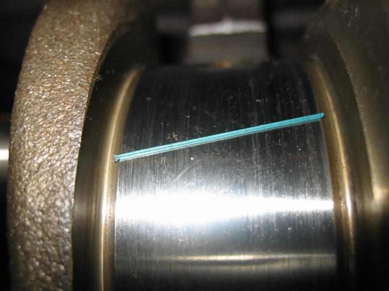

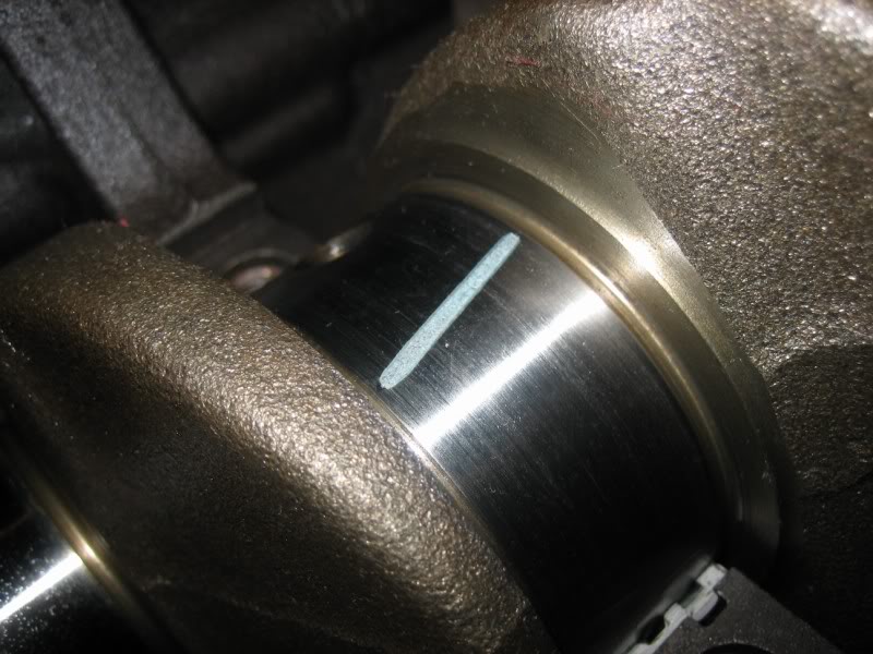

cut up and layed in some plastigauge
torqued er down, and came up perfectly within spec! don't have a picture to compare beside the plastigaue measurements though
but anywho, I cleaned off all the plastigauge, put the other half of the mains in the caps, layed the other two thrust washers in place, added plenty more moly lube, and torqued her back to 76ft/lbs, in the correct pattern, in 3 steps (35, 55, 76)
and then... the battery on my camera died I hadn't charged it since the wedding, lol

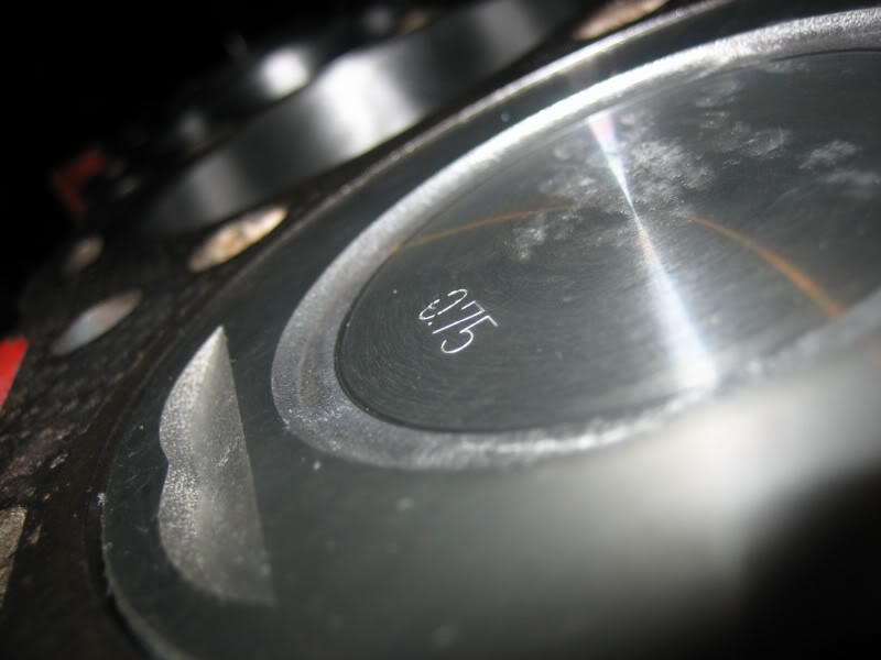

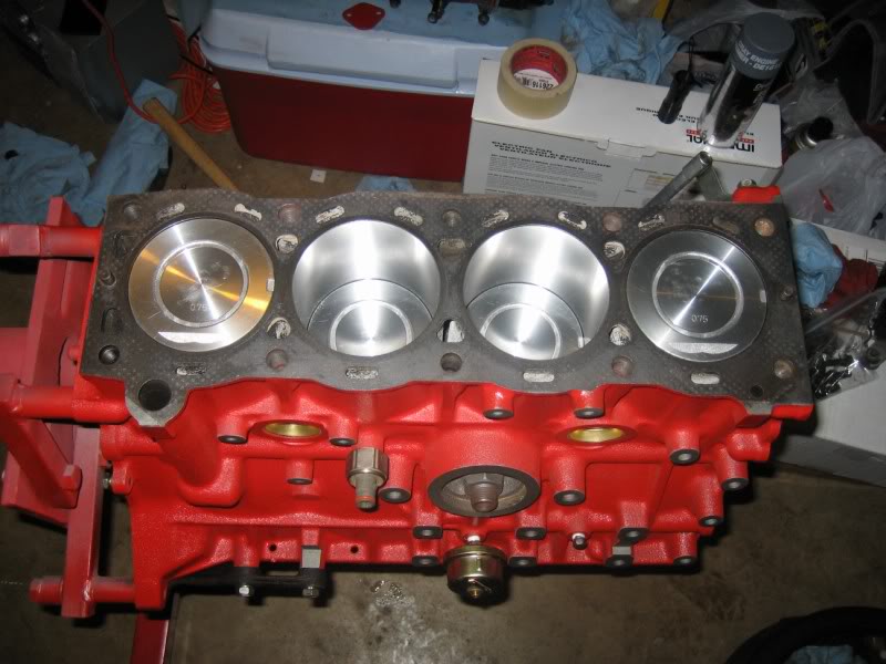

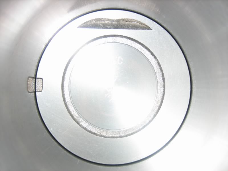

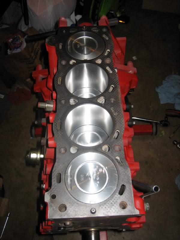

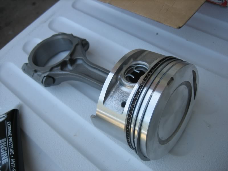

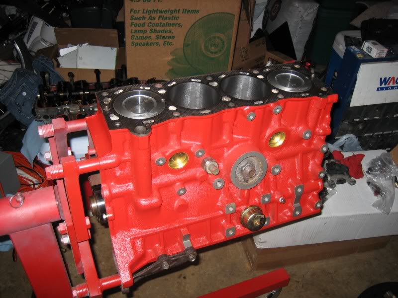

so while it was charging, I threw all the pistons in, and now WE'VE GOT AN ASSEMBLED SHORT BLOCK!!!
