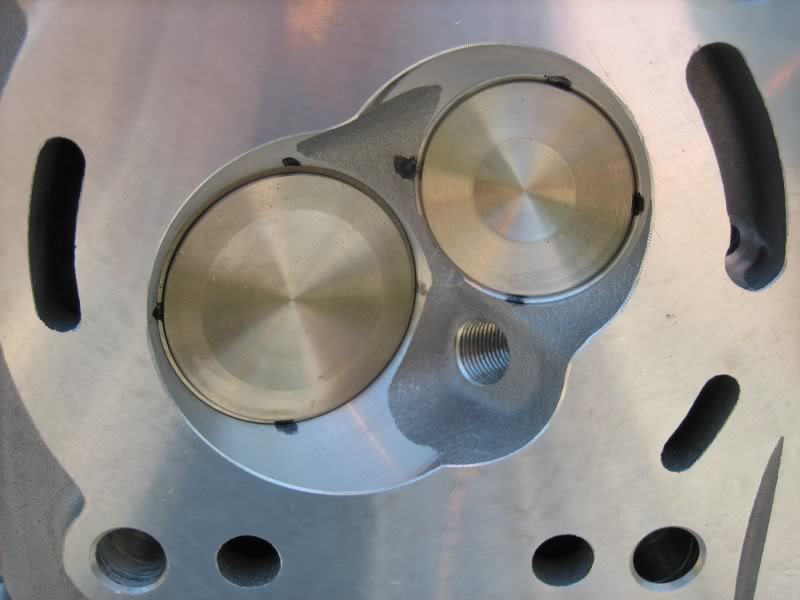

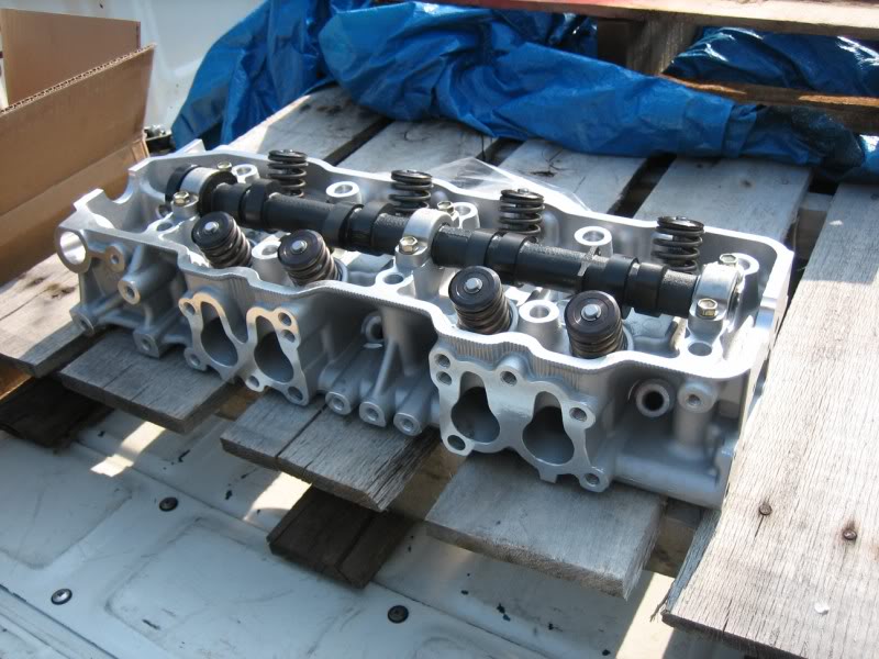

I came home and found a box at my front door today
DEFINATELY looks a lot better than the original, lmao

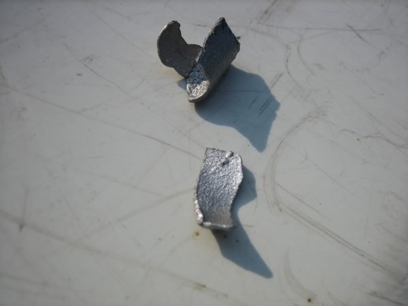

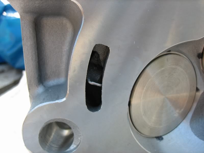

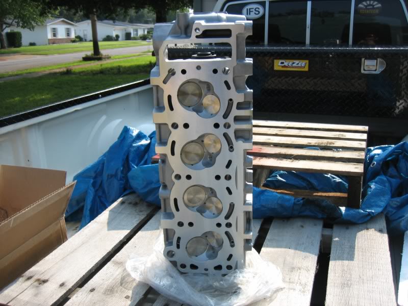

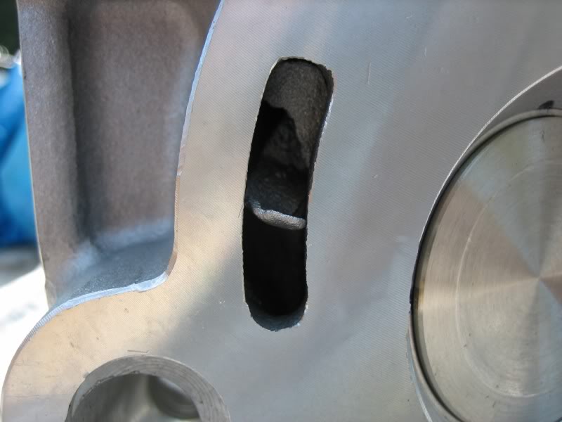

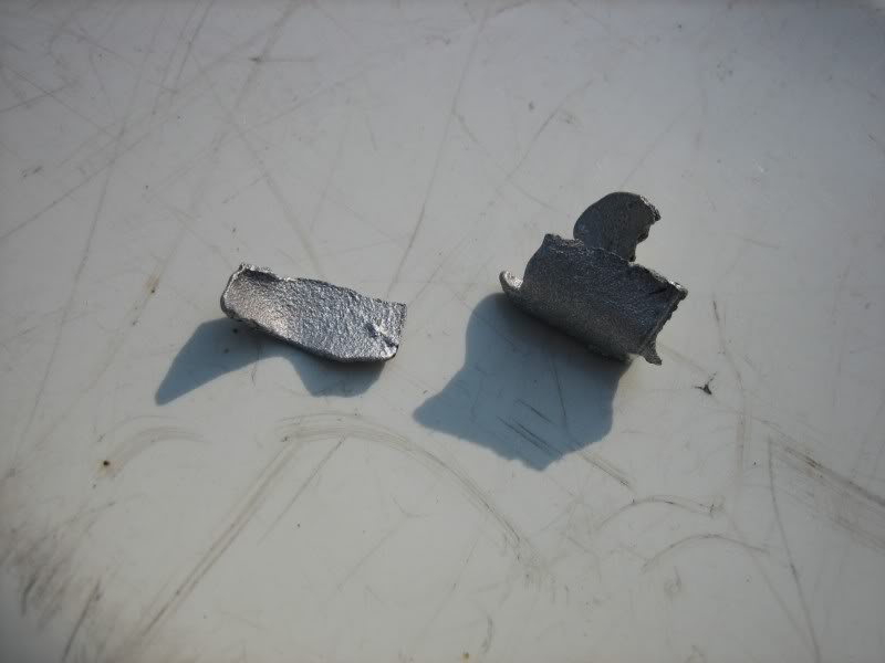

OH, and on a side note, if anyone purchases a NEW CASTING head for a replacement, be sure to check all the cavities in the head for any metal left over form the casting
it took me a good minute of two of flipping and roller the head around in the air to figure out where this rattling sound was coming from, lol

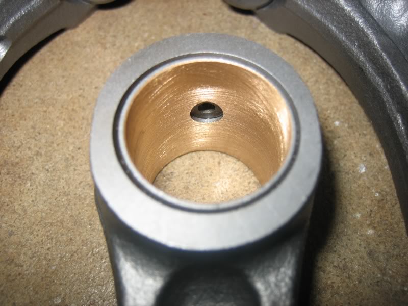

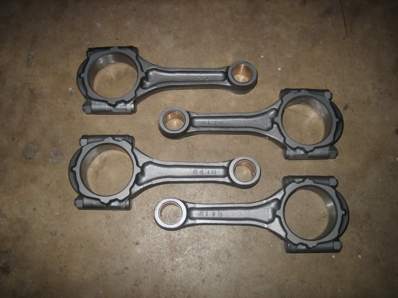

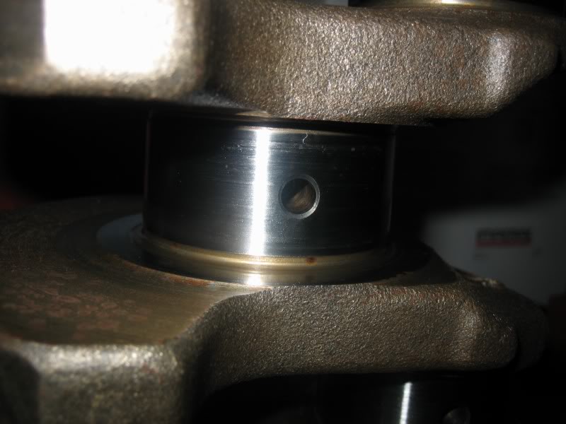

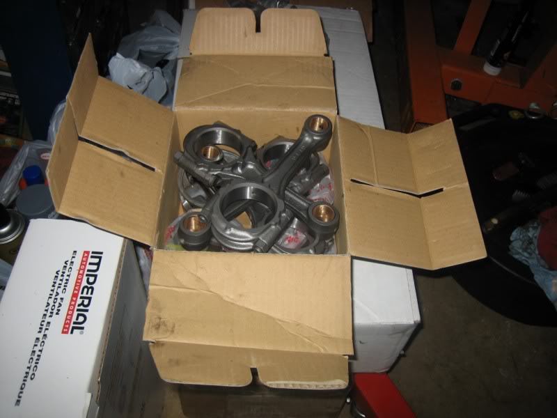

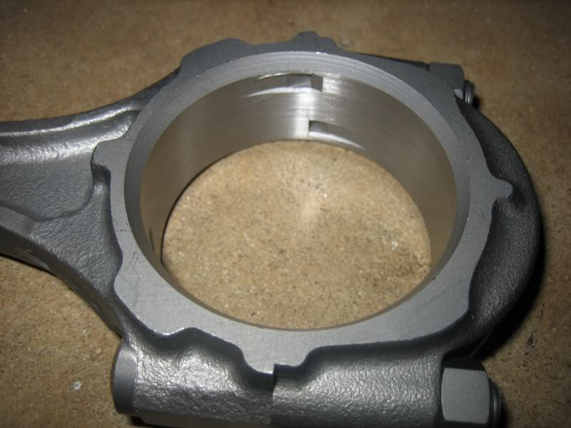

So the machine shop called me today; said the block got all finished up yesterday, and today he was finishing up on the crank and rods. He had to line-hone the crank end of the rods, because they were just slightly "egg" shaped, and he was in the process of honing the wrist pin bushings to fit the pins. Then he was going to get to the crank, and finally through the freeze plugs in for me. Should be read for pick-up tomorrow afternoon, BUT the only problem is he only can take cash, and well, I'm broke right now as my paycheck will deposite tomorrow night at about 2:00 am SO, I might have to wait and go to pick it up first thing Friday morning

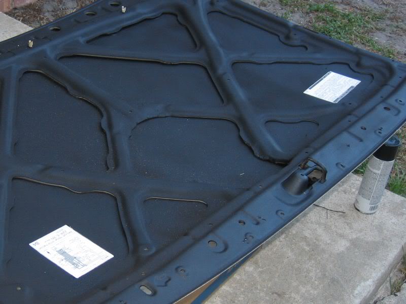

Been meaning to ask..
why did you spray the hood with undercoating?
Old Jun 10, 2009 | 06:41 PM
  #378
iamsuperbleeder's Avatar
Joined: Feb 2008
Posts: 12,248
Likes: 33
From: Lake City, Fl

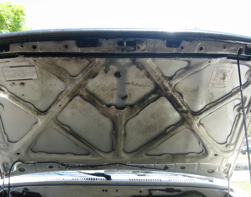

it was all discolored, and use to have a section of a hood support litterally ripped out, and looked pretty gnarley:
I removed a little metal to even it out, and tapped down the rest with a hammer, so it's almost not even something you would notice now

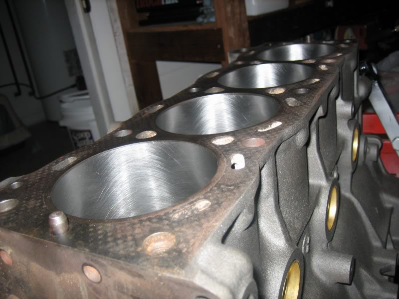

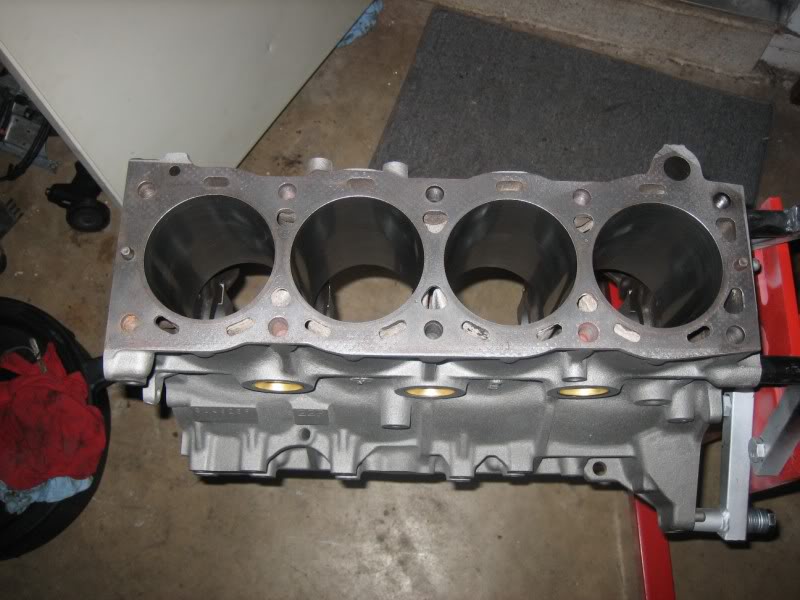

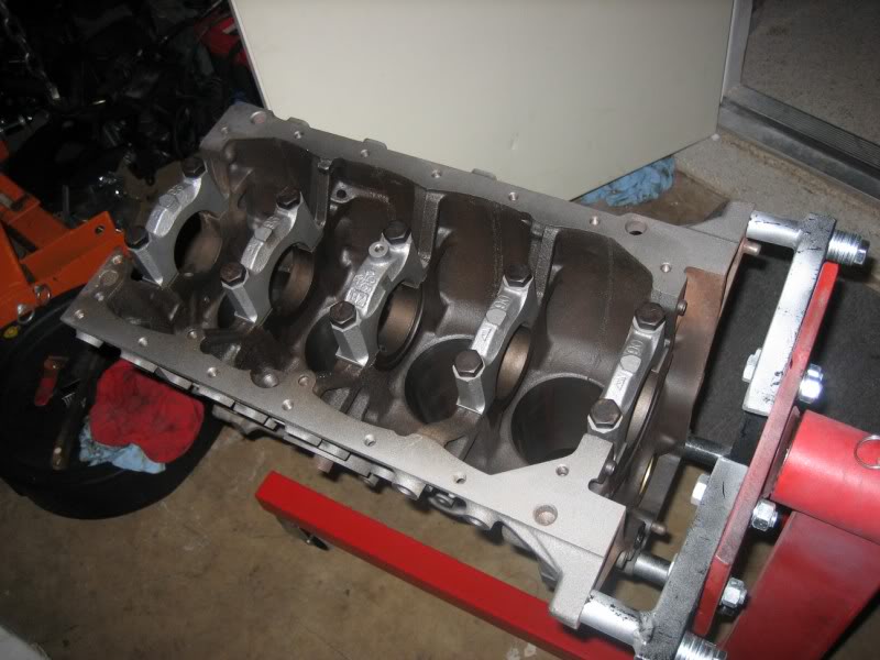

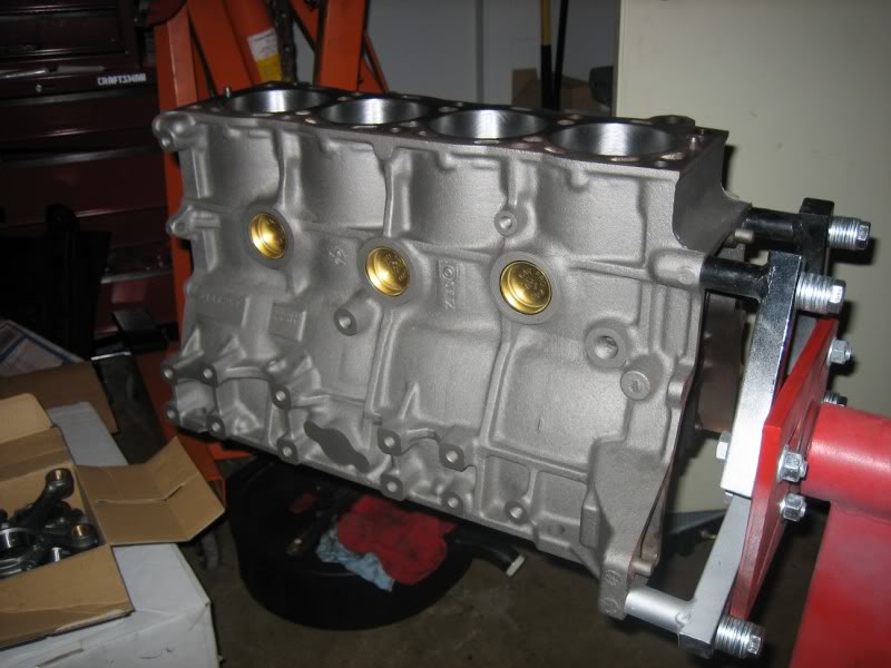

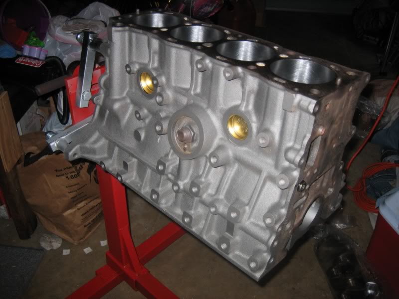

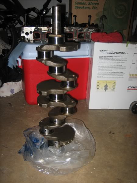

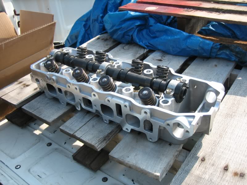

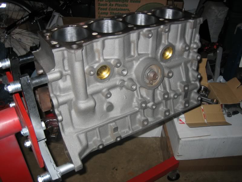

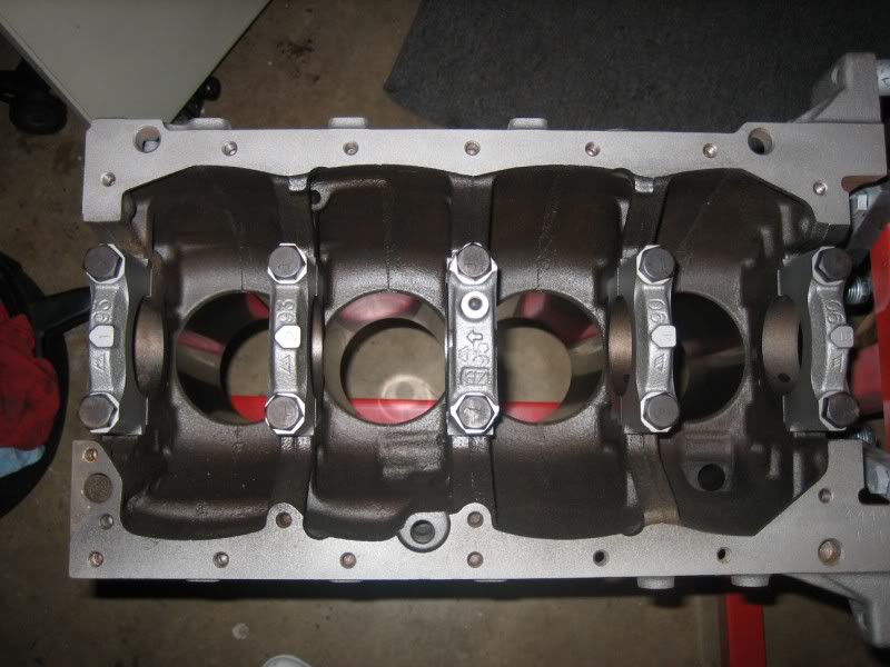

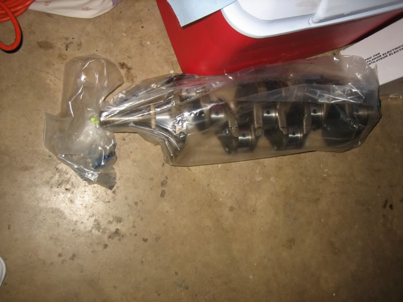

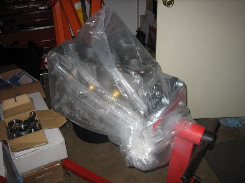

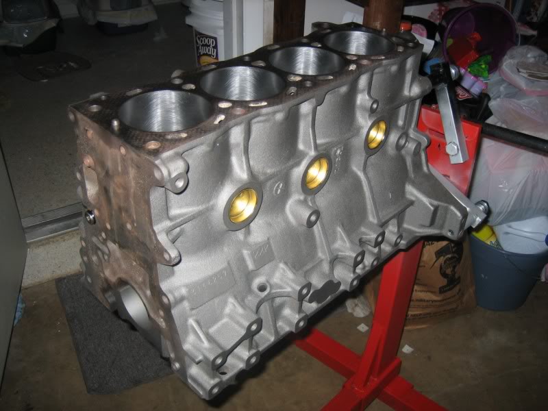

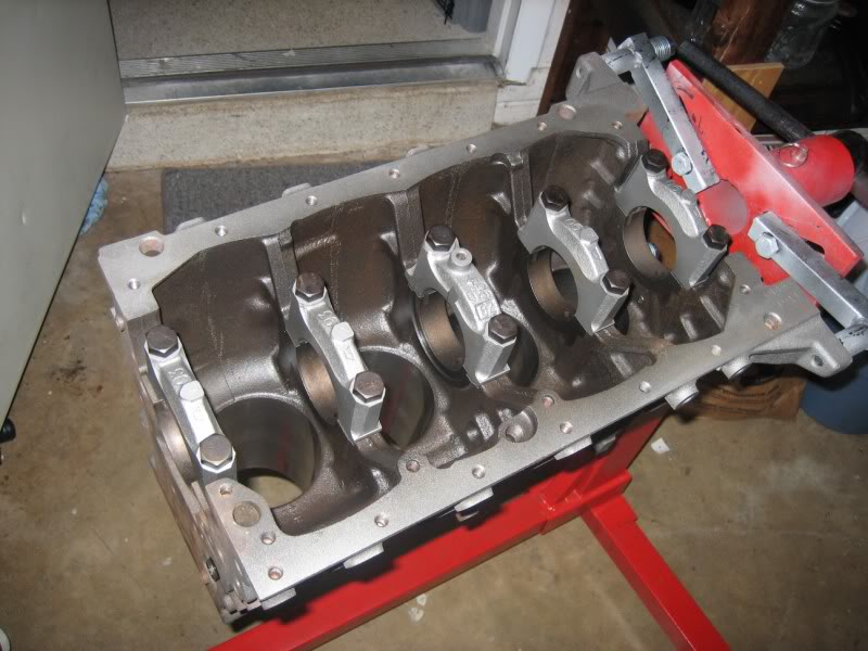

Weeeeee, we've got some freshly machined parts!
You'll notice a few things; 1) He gave the block a coat of sealer-primer to keep it from surface rusting and 2) he didn't have to TOUCH the head mating surface! He said it was freek'n flat as can be! After measuring, measuring again, and then checking it one last time, he found NO flaws in it! That's just one less service I had to pay for
