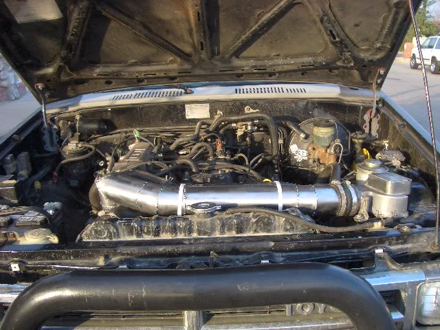

yeah gona bring this back!!!
hey stold your idea ha
how much were your intake tubes???
and what you do with the egr hose???
also your hp power and torque R on the floor man
how many miles on your 22re
i was doing 135 torque and about 109 on hp
but i also noticed you opened up your exhaust bad idea to trade power for growl from your tailpipe
eh your truck...
heres some pics of mind

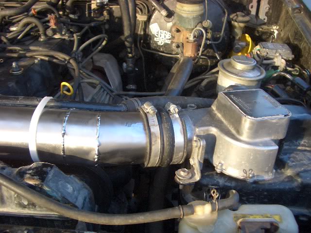

my Tb was aimed down word at an angle about 45 deg so this is what i did to get to it
The reason Y i did this was beacuse my 90 deg coupler ripped on me when i was offroading so this had no play in the couplings so hopefuly meaning no tears

My god the airflow inside that tube would be so disrupted you are probably better putting the stock intake back on....Grind those welds back too if you cant lay a good bead.

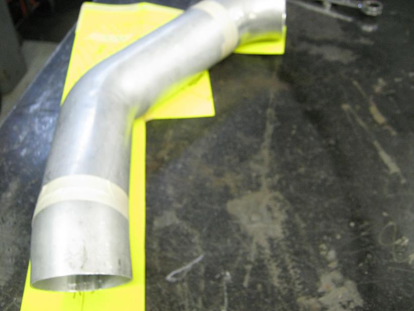

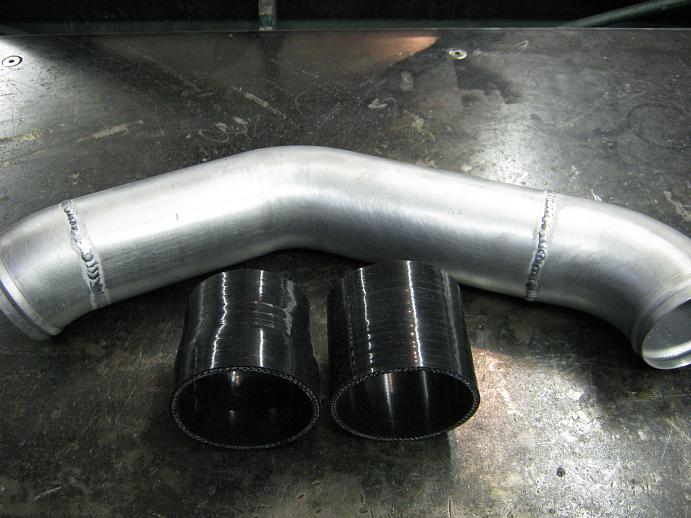

I had this made for my Supra AFM swap as well. $110.

OP, your intake looks great! I think you may be on to something. And that last intake posted by "peach", dude that thing is disgusting.... Awful looking and I can't imagine the airflow being very good at all....

Guys it's an 88 so the TB is at an angle so I realy coud not figure a way to get to it so I did 45 deg cuts any Ideasi to improve this distortaion
plus I made it beacuse my coupler riped and well I was not going to spnd a bill or more for a new one
the welds yes Bad but first time welding

would watch your top radiator hose to. looks like it is rubbing on your intake. wold fix that your you will have a pretty good mess going on.

do a late model 22re upper intake manifold swap and viola straight throttle body......

Even easier...relocate your battery and run your intake to the other side. Then you can keep the down angle as you have nothing to clear.
Unless the pipes are holding pressure (forced induction) there is no harm in grinding back welds. Even the worst welder in the world can make a seamless join with enough patience and grinding.

looks better than stock..
