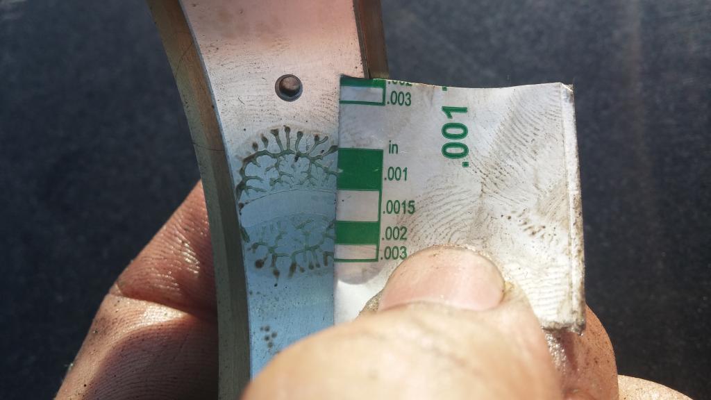

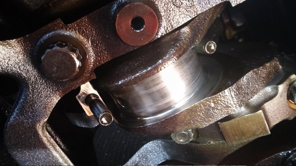

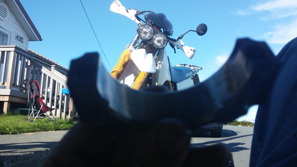

Well the bearings probably arent going to work. Once I got everything pulled off, the bearing on #5 were worn thin and spun. Gouging on the crankshaft has occurred. I checked all the other bearings, 1,2,3,4,6 and they all were non-spun, although #6 was worn pretty thin. I installed new bearings on all 6 cylinders and emasured oil clearance with plastigauge. All 5 non-spun were about .0015-.0019" clearance. Which is in spec:
(j)Measure the Plastigage at its widest point.
Standard oil clearance:
STD
0.024 – 0.053 mm (0.0009 – 0.0021 in.)
U/S 0.25 and U/S 0.50
0.023 – 0.069 mm (0.0009 – 0.0027 in.)
Maximum oil clearance:
0.08 mm (0.0031 in.)

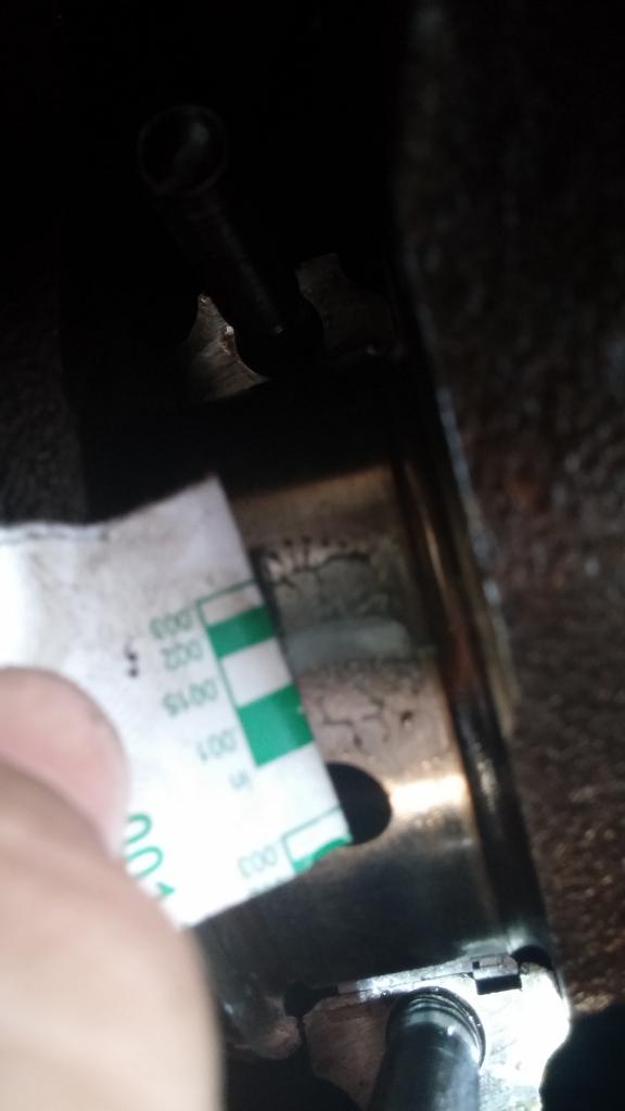

Unfortunately #5 with a enw bearing still had way to much vertical slop, and would either not touch the plastigauge or barely mash it around .003 or .004ish. No good and outside of limits.
So at this point traditional wisdom and advice would say "trash the crank or get it machined and reinstalled with undersized bearings, or better yet, trash teh whole motor and install a 3.4" (yes I know how yall operate)
However I am a stubborn and cheap SOB and refuse to give up on this idea, so I ordered a set of .010" undersized bearing from napa. Going to put them on and see how they fit, I assume they are going to be tight and im going to go against traditional wisdom, and guidance (most people are probably cringing now and yelling at their computers at me). but I am going to grind down the crank by hand with some sand paper, emry cloth, and corcus cloth, using my micrometer to ensure I get the right dimensions and attempt to keep it in round. Then throw on the undersized bearing, cross my fingers and say a prayer.
If that fails and still knocks, I just came across a deal on a free 93 runner with blown headgasket, going to pull that motor, put it on stand and rebuild it. Or possibly buy a beat up 99 on the island that has a runing 3.4, $1000obo, but auto tranny is failing and rear diff is shot. Might be able to make something together out of these 2 maybe 3 runners.
Some photgraphic evidence of my craziness....
Good journals:
Good journals again:

#5 spun bearing, you can see the edges of the bearing only, both halves were sitting on top:
Rod End cap pic:
Spun Bearing pulled out #1:
Spun bearing pulled out #2:
Spun bearing pulled out #3:
#5 Journal pic #1:
#5 Journal pic #2:
Unreliable plastigauge reading on the #5, it had vertical slop, it would be not touching the journal or I could pull it down and seat it.
Please refrain from the comments of "just pull it and put in a 3.4" or "you better pull the crank and have it machined 10/10 and throw on some .010" undersized bearign on all 6" I know both of these statements already to be true, at this point im taking it on as a personal challenge to TRY to get this motor running without a knock, without removing the crank, I realize I am likely to fail, but im having fun toying with it and I cant break this motor anymore then it already is.
