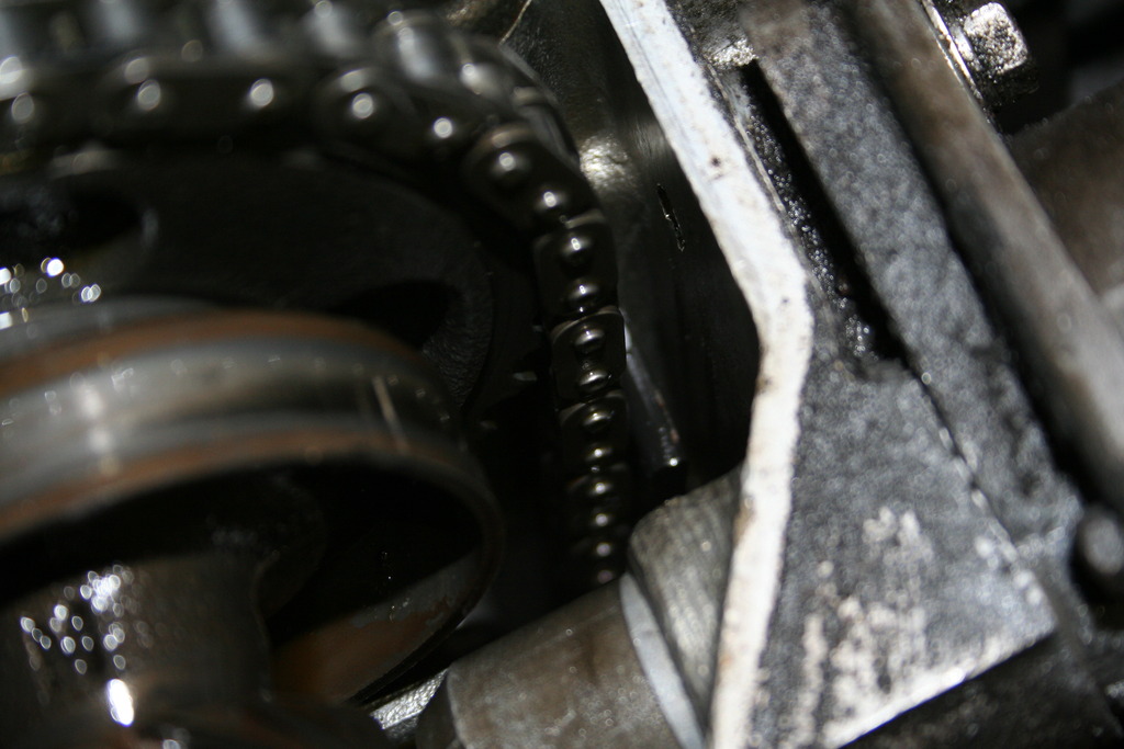

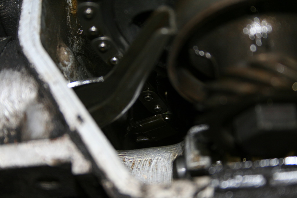

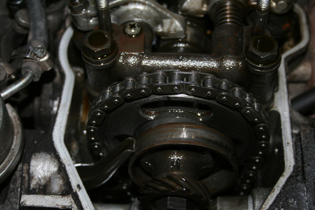

I pulled the valve cover, I rotated the engine clockwise and set the balancer mark to "0" on the timing tab, and looked at the timing chain. Everything look ok here (pics below)? my understanding is the cam gear dot should be around 11:30. Also took a shot of the distributor because it seems really far one way. Maybe ignition timing is off, or distributor off a gear? Do the chain guides look ok? I marked the gear with a sharpie because the dot was under the chain.

I don't see the right side timing chain guide which is the one that normally breaks. I suspect it is broken.
Most but not all timing chains have a bright link. Your chain may not have the bright link or you do not have the number one piston at TDC on the compression stroke.
Your distributor should be more centered but looks to me it is to far counter clockwise.

I just pulled the cap and its pointing to #1, so that should be TDC on compression stroke. Want to make sure it hasn't jumped timing
The right side guide, is that the driver side? It looks like its there to me, its the pass side that I question, but very hard to get pics of.

So the timing chain looks fine, I can rule out a jumped tooth?
