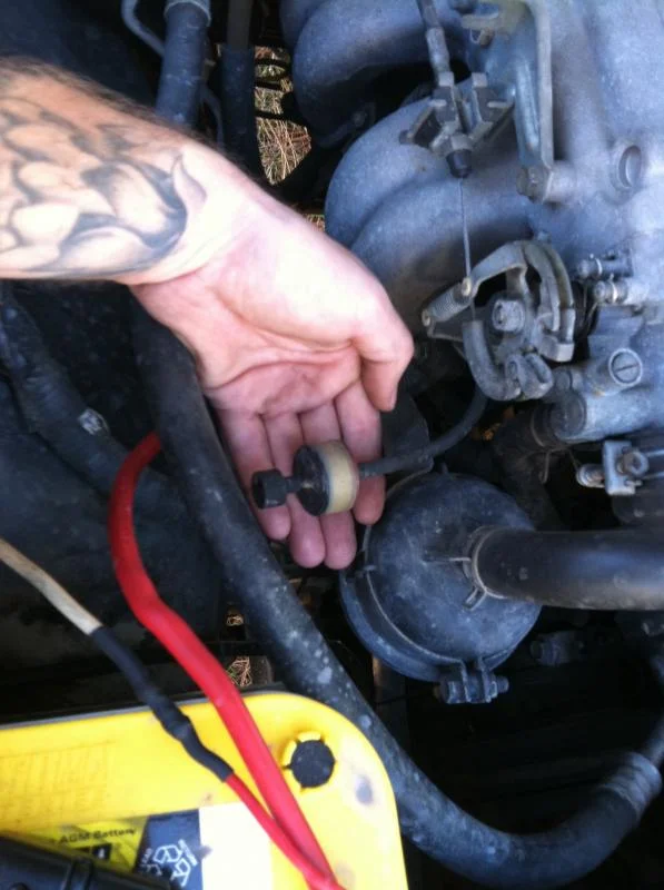

Did you clean the dashpot?

I cleaned it.
I ran a couple of tests. Like what philbert said. I unscrewed it completely and did not have any issues. I drove down the street giving the truck light revs to try to get it stick.
It seems the more screw I have on the dashpot the more likely it gets stuck. So whats the reason for the dashpot? To reduce the drop in rpms?
Do I just drive with the screw no touching the dashpot????

I'm willing to bet your VTV is clogged. Have you cleaned that out with some IPA and then compressed air?

The dashpot is there to prevent backfires when you let off the gas. If it weren't there, and you were on the throttle and then quickly let off the gas, the throttle plate would snap closed quickly - this could cause some backfiring. The DP acts as a buffer to slow down the throttle closing, if just breifly, to avoid backfiring.
It's OK to have the DP screw not touching - same as not having a DP altogether since it's not doing anything at that point. I just thought by eliminating it from the equation you could see if it was indeed the stuck DP that was causing your idle issues, versus aybe the TPS, like Swadoosh was suggesting.

I shot this with some brake cleaner. Thats it. I'll have to go get some compressed air to re do the process.
Last night I was driving the truck around the block with the screw completely up and while I was coasting I was lightly tapping on the gas (in neutral) to get the idle to stick. It did not. However I will be doing it again since today is a new day.
For giggles I went to the dealership. That dashopt (diaphragm) is 130 bucks. I laughed. It's also discontinued. I laughed again.

She's been burped since we put her back together. I will do it again.
Since I cleaned the VTV I'm getting the same thing. This time I've been loosening the screw less and less. Right now I have a couple of turns left before there is no contact.
During this I've been getting less stickage.

It hangs at a thousand RPM's however if I give the gas a little tap it will bring the idle to the 800 range.

Sounds like you have found your problem then. I had to adjust my screw to achieve a good 800 idle as well.

I'm not sure if I'm liking this.
Letting off the gas at times I get fed back from the motor. This is because the rpms are dropping too fast when I shift.
I guess it is what it is for now ... until I find a replacement.

I kind if like it on mine but to each his own.
Maybe remove the dashpot and give it a thorough cleaning?

Ugggh, again!?
It seemed functional when I had it off and working that spring but I dunno. Instead of brake cleaner, what do you recommend?
Maybe next weekend I will try soaking the dashpot. Tomorrow I start my new job, so I will be occupied with that.

Nothing in particular.
Soak in solvent, then use lithium grease to really live it up. Also, like Sqwadoosh said, make sure the filter on it is clean.
