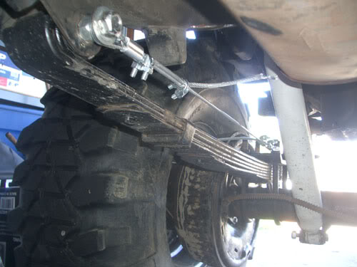

In regards to axle wrap, I recall seeing something once online about using a piece of steel braided cable to help with axle wrap. I thought it was a very clever redneck solution for only like $10 in parts. Cable was mounted on the spring hanger and the top of the axle on the ubolt, when axle tries to twist it pulls the cable taught and it can't move - so kinda similar to how the single traction bar works (the kind that's not a trailing arm/A-shaped design)
Edit: found it --
http://www.pirate4x4.com/forum/jeep-...than-10-a.html
