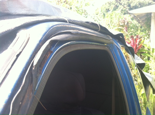

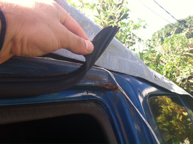

Install and removal is simple enough,
pull out the old weatherstrip
maybe clean the lip of the roof rail so you have a clean surface to work with (and repair any rust while your at it)
Then apply some adhesive to the new weatherstrip and push it onto the lip.
It's not rocket science, should be self explanatory.
I've added some pictures to show the piece I am referring to.
The first picture shows the weatherstrip that runs just above the door seal
The second and third pictures so both ends of it starting about where the side mirrors are and ending in the upper rear corner of the door. As you can see its pretty easy to just pull off, might just be that mine is so rotten that it seems easier though.
