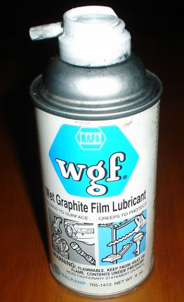

My 95 Has the mechanical gauge cable and this is what I used and Ive only used it once in 4yrs. Pulled the cluster out and unhooked the cable and sprayed a lot of this in it.

Tragic Drive
Thanks for chiming in before the "cable on 95's " doubters burned me at the stake, I'm kidding. Out of curiosity did you yank the cluster on your own or did you find a tutorial on here to show you how to get to it?
