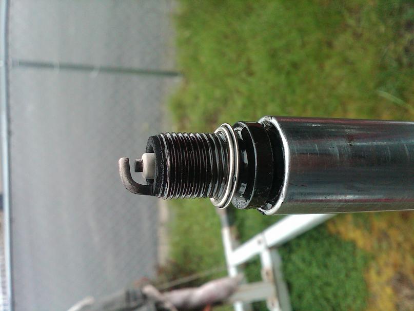

so I did a compression check on my 4runner today, I got 120psi on all the pistons on the driver side. where I think I have a stuck or burn valve....here is a pics of the spark plugs. I dont like how 4, 6, looks with stuff around but from 2 looks cleaner....can someone tell me what is the stuff on the spark plugs
Attached Thumbnails another blown head gasket!-img00024-20100421-0948-1-.jpg   another blown head gasket!-img00027-20100421-1000-1-.jpg
Old Apr 21, 2010 | 05:50 PM
1990yota-pickup's Avatar
Joined: Jul 2009
Posts: 1,151
From: hubert nc
ya, thats not a good sign..
