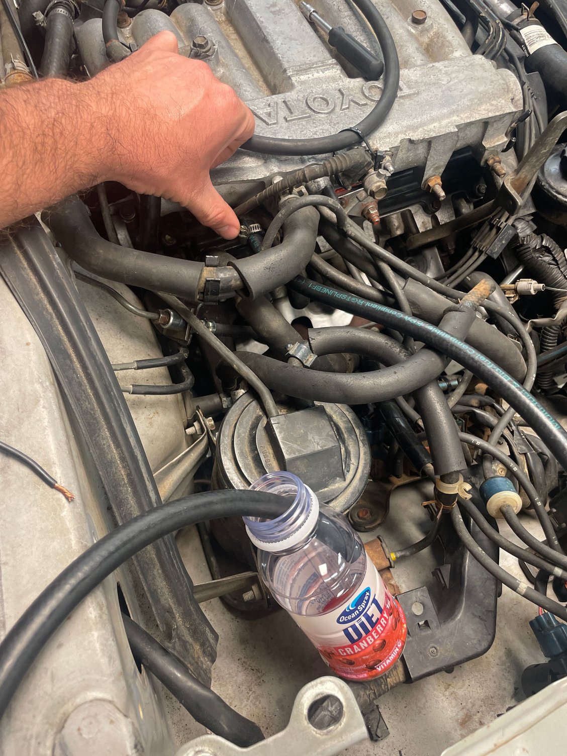

Quick update. I ran a line from the fuel return to see how much flow I had. I jumped the fuel pump in the diag box and let it run for 2 minutes. I had zero fuel come out of the line.
I knew I had fuel before the fuel filer on the frame rail, but hadn’t tested up to the injectors.

Well… it did had fuel at the filter. It must have clogged shortly after it started pushing fuel.
I had a clog somewhere in the pump/tank lines. Pulled the pump out and cleared it. Dropped it back in, primed the lines and she took right off.
