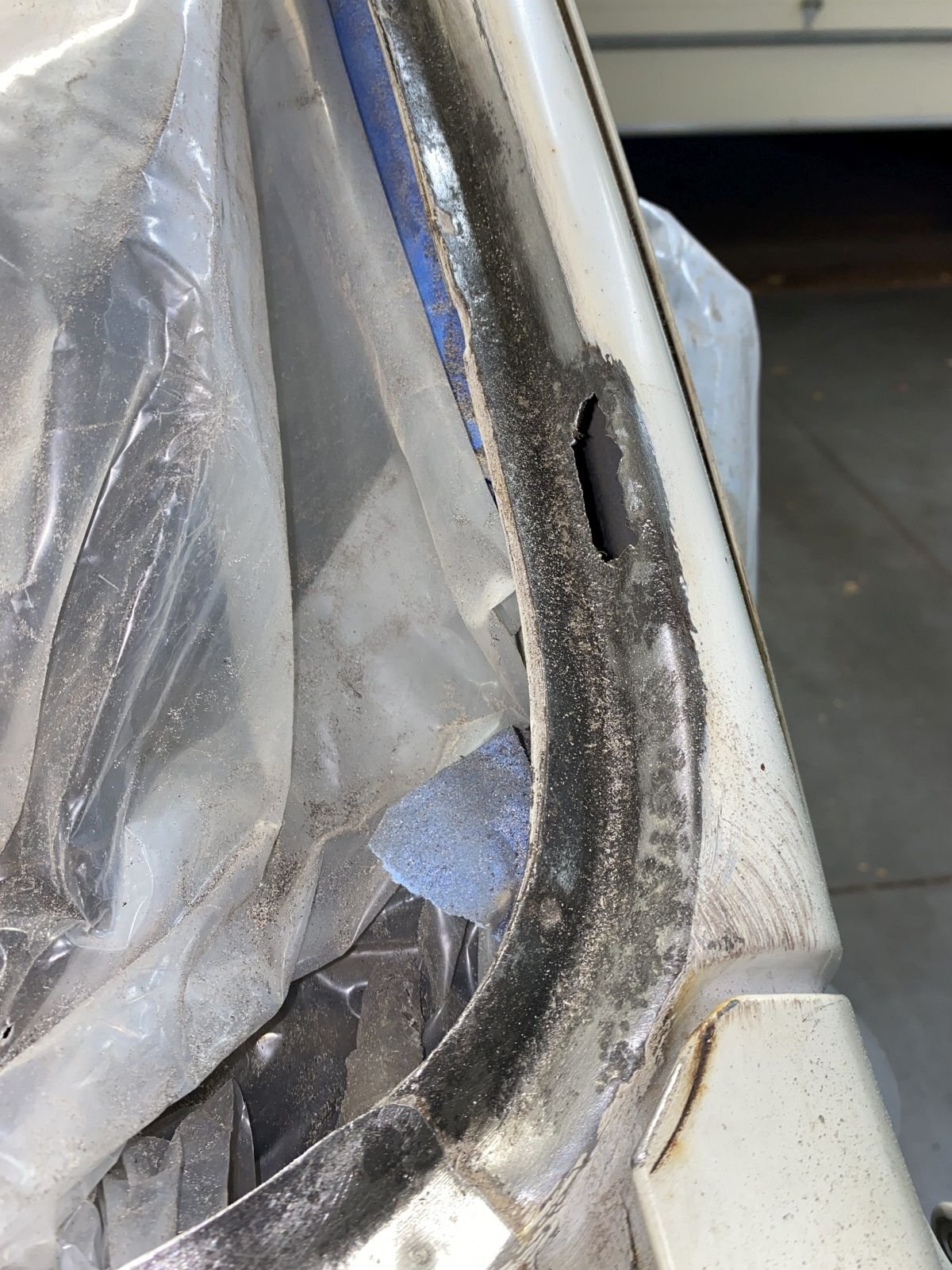

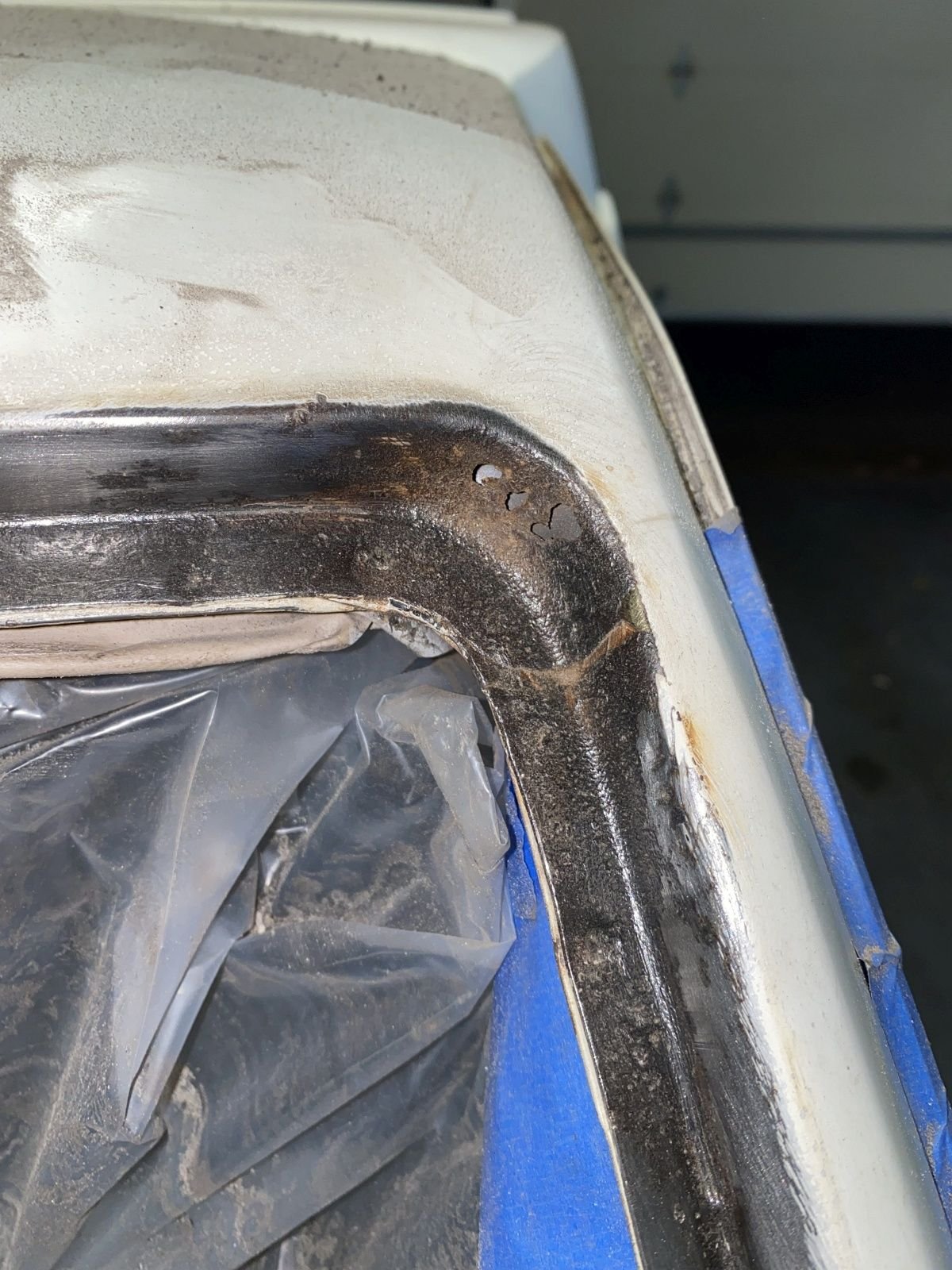

I am working on the windshield frame on my 1986 4WD pickup. While grinding off rust I found holes in three corners that had been filled with body filler at some point in the past. After I finish removing the rust I will use Ospho to treat the metal and then prime, paint, and install the windshield using the OEM Toyota rubber gasket referenced in other threads.
My question is, do you guys think I should refill the holes with body filler, or cut them out and weld in sheet metal? I know welding in sheet metal is probably a better approach, but I don't have the equipment or skill to form sheet metal to fit the rounded corners. Let me know what you think, thanks.

Best option is weld
second best option is extremely well prepped metal and epoxy resin (us epoxies is a good source for resin, thickener and fiberglass) Fill on any uneven spots with thickened epoxy to the consistency of of peanut butter. Epoxy resin is not the polyester resin you purchase at Walmart/AutoZone/Lowe's.
Last is a body filler.

Thanks PickleRick. I am getting some 20 ga sheet metal pieces and basic sheet metal tools, will try to do it right by welding pieces in place.

I bit off more than I can chew, I don't have the welding skill to repair these windshield frame rust spots. I know @slacker in BC does this kind of work, but can anyone recommend a person or shop in Oregon? Thanks.

If I was closer I could get it done for you, what problem are you having with welding it?
if it’s forming a piece to go around the bend I would recommend going to harbor freight and buying a shrinker/stretcher for cheap and just playing with it until you figure it out or you could just weld pieces trim out rusted part and form a piece with a pair pliers or whatever you got. I consider this kind of a good place to learn how to weld because nobody else is going to see it once the windshield is installed

I have a cheap Harbor Freight line feed welder set on the lowest setting and it still burns through sheet metal. I practiced on scrap for a while, then tried one small section of the windshield frame and it burned through there too. Pretty sure I need someone with a better welder who also has more welding skill than me
