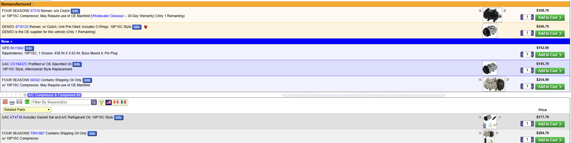

@scope103 Have you noticed any quality issues with the kit you ordered given it is not a Denso compressor but rather all UAC branded? The RockAuto options are below. Seems like the option you chose is the most affordable. If I want to go closest to OE I can do Denso reman for ~$247 and then get a Denso R/D for $50 and OEM TXV for $62 from YotaShop. eBay has 4Seasons branded o-rings for about $20.
Of course, that is a couple hundred more in parts. Not sure it is worth it if you have had a good experience with the more affordable kit.
Separately, does "shipping oil only" mean the compressor does not come pre-filled with the spec amount of PAG oil? I see a few compressors are marked "shipping oil only" and just wasnt sure what that meant.

The system will need 100 cc of PAG oil. Just take the new compressor, remove the shipping plates they installed where the service manifolds go, and pour the oil into a graduated measuring cup and see how much they put in.
