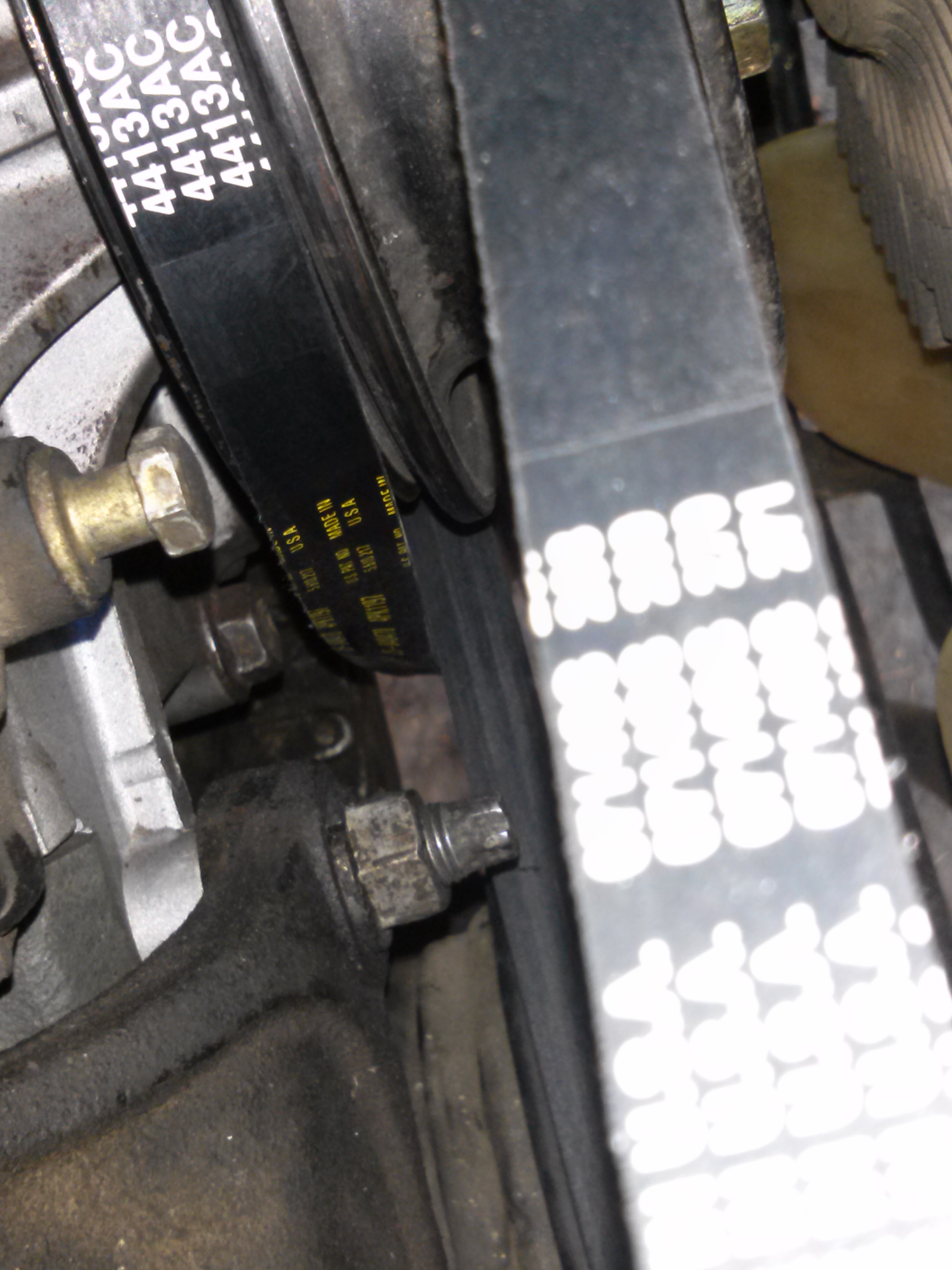

Tried taking some car porn pics, hard as a self made producer.
So yeah, I don't know why but it seems like the fan is pulling out. The picture shows the deflection from the PSP. Tried also taking a top down but yeah. Will attempt clearer pictures soon.

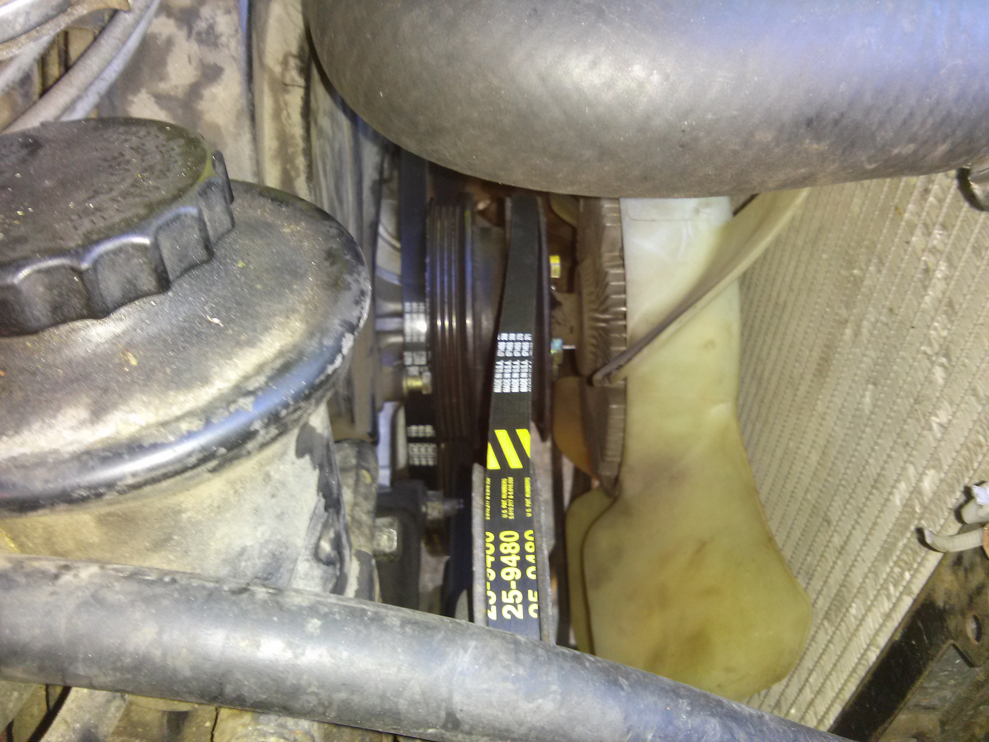

Better Shots
Got some better pictures now, you see if i was to tension the alternator again it would just pop the belt right off once i start it up. No clue why it is happening.
The bracket that holds the fan assembly is new, bought for 278$ at napa. The old one exploded out. I also replaced the timing belt and water pump. Again the truck ran fine the last 3 days, no squealing no problems. And to the best of my knowledge the belts lined up initially.

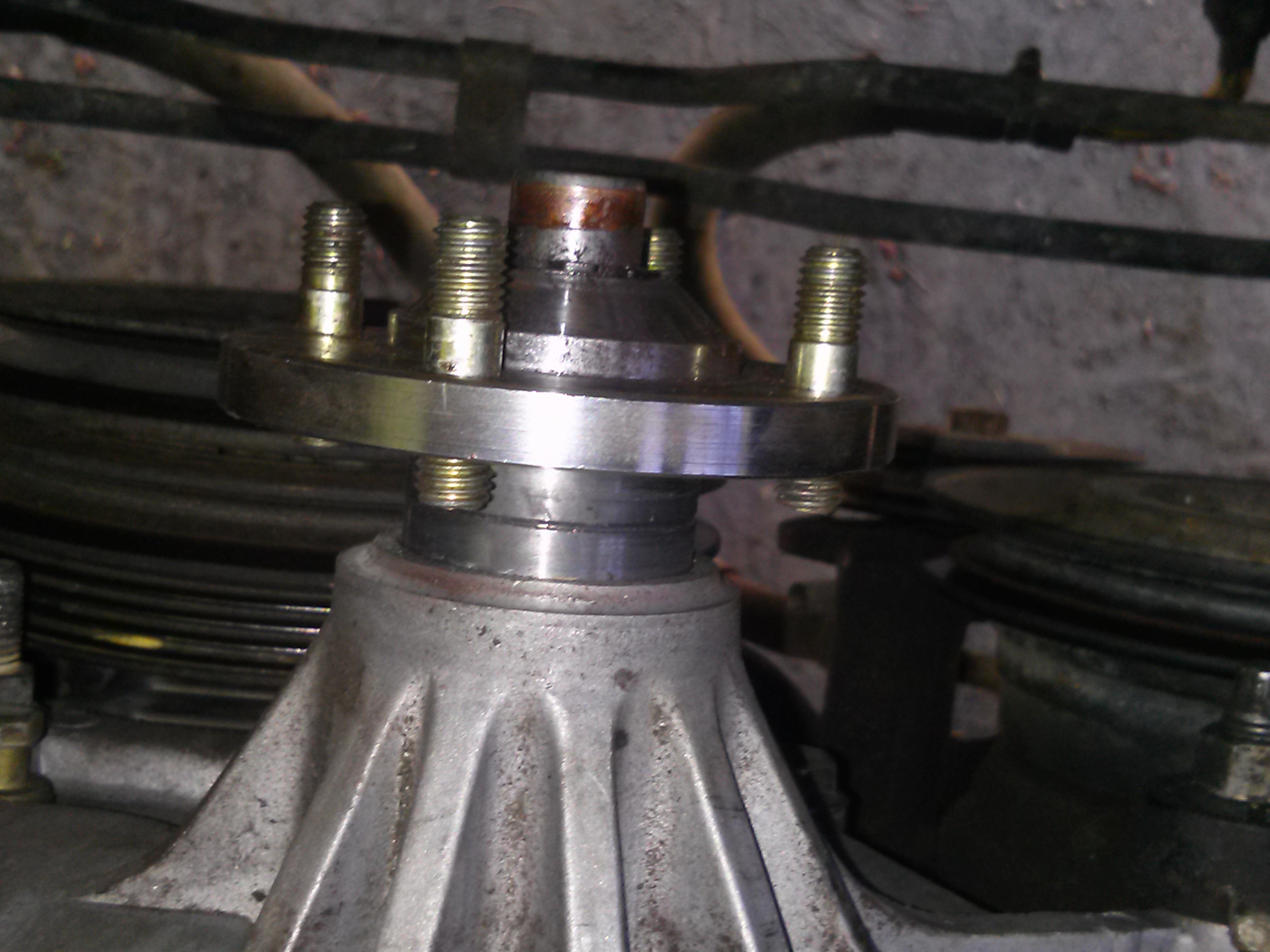

So why would the fan assembly bracket be getting pulled out. This would be the 2nd time it is happening. The power steering pump and the alternator are aligned perfectly with the crank, so I don't know how it could be getting pulled out.
Any tips or thoughts. I am at a loss.

That bracket is either not installed correctly, or is the wrong one.

The bracket matched up perfectly to the one that was one the truck, and there is really no other way to install it. I had it flush to the engine and torqued to spec. I appreciate the responses man, I really do.
