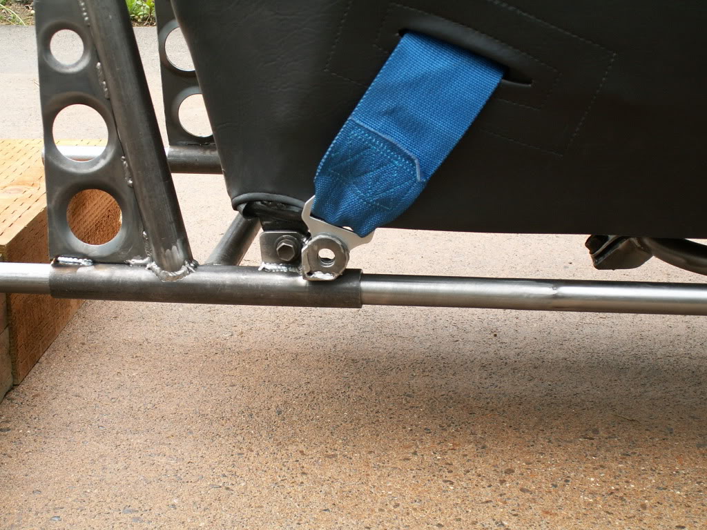

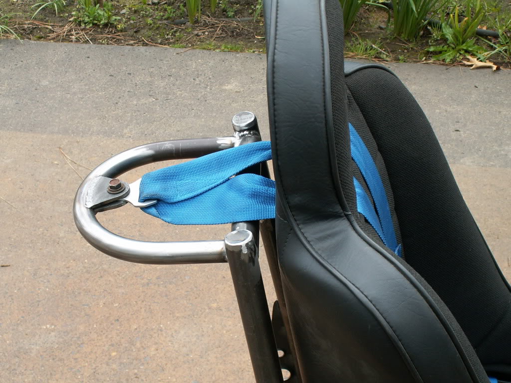

another option is to make a new mounting system for your seat that includes harness mounting points like this:
