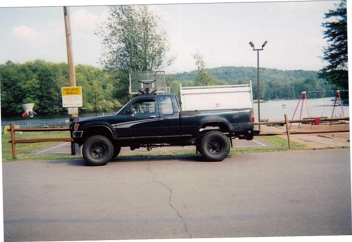

here is my 94 x-cab with contractors cap
