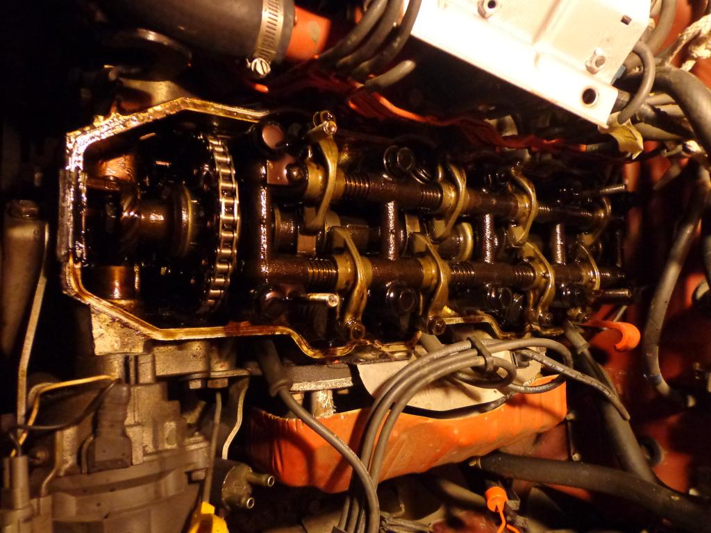

well, being that I had to run into town (23 miles one-way) to get the valve cover gasket kit (felpro), I didn't actually get started on this until after 8pm. but we buttoned everything back up by 915pm, and then I ate supper etc etc etc. so, that's why I didn't post much up.
a few observations:
-only had to remove the vacuum lines off the power steering, otherwise everything was able to stay in place, of course, with the exceptions being whatever was attached to the valve cover.
-oil looked good, rockers looked good.
I am questioning myself in that I am wondering if I should have loosened all the head bolts first and then done the tightening sequence. I was more worried about mixing the vacuum lines up (no worries, since they did not get unplugged) than I was worried about the actual head bolts.
I was satisfied when I set the wrench to 58 and Joe was there calling out the sequence and the wrench would click on the 1st attempt, but then when we got to #6, I got, at least, a 1/4 turn before it clicked. so not really sure what that means.
in my little brain, I want to say #6 was the culprit. but, after Lord knows how many heat cycles, does that mean my head is now warped? why would one be loose?
also, when I set the wrench to 63, I got almost NO movement out of any of the bolts, exception being the #6 again. I am shakey enough about this that I feel like I should open it back up, loosen everything up and tighten it again. but, in my pea brain, I am afraid that this will spell certain doom for my head gasket by breaking any seal it has and contaminating it.

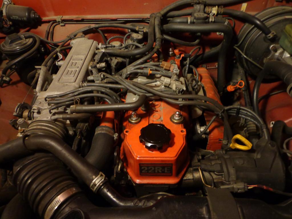

alrighty. some pics;
after 22,000 miles, I would say the motor still looks good....if nothing else.

this is a pic of the box (I love boxes) that we used as a guide for the torque sequence. Joe put an arrow by #6 to show that it was loose and the several marks near every number, show how many times we actually went over these bolts.
