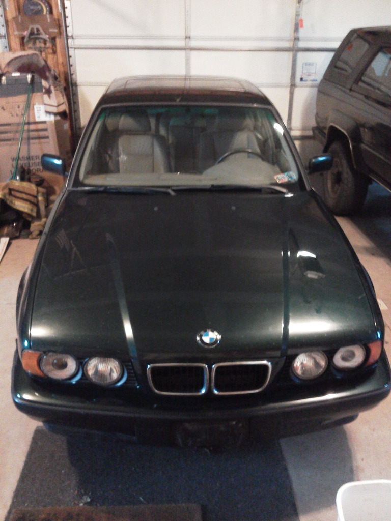

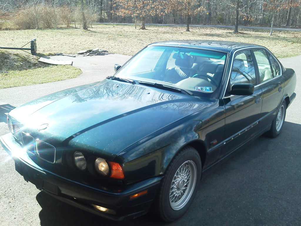

Joe bought his car. a 1995 BMW 525i. found it about 2 miles away and for $1500. runs well, was inspected and current and the purchase went well. nice car. hopefully we get some good miles out of it.
his 4runner is currently mothballed because I am still, for now, still buzzing around in my truck (which I will show in a later pic, almost was no more)
1st of all, Joe's car

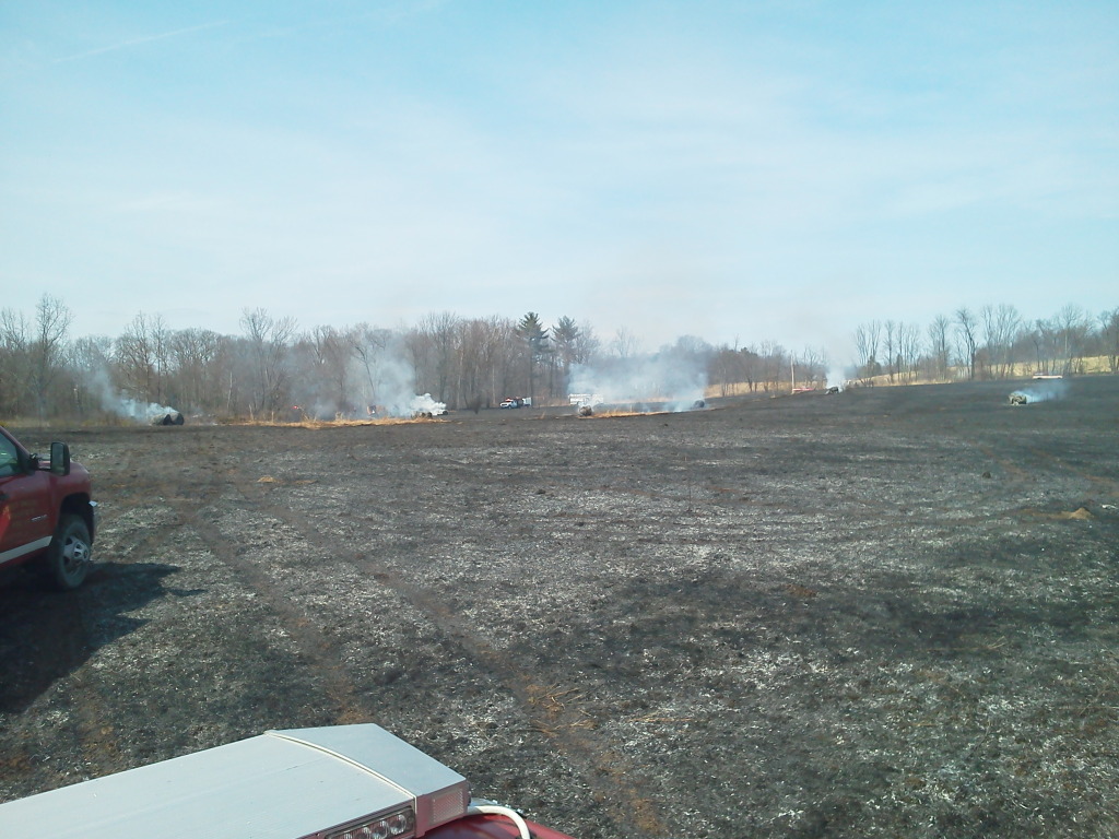

aaaand.....did my duty 2 days ago, for what was to be the largest brush / wildfire I have ever been at. this thing spread so violently fast it was very dangerous. I had parked, at least, several hundred yards away from a garage where the fire (part of it) was near and got picked up by a piece of apparatus enroute to the scene. little did i know, my truck almost became a scene itself. the fire ended up being several acres and had started when a farmer's tractor caught fire in the field and quickly spread in all directions. came within about 30 feet of a garage and house (you're welcome) and was overall at least a thousand feet wide and at least twice as long. the pic you see will be where it jumped the road. I don't know, but would love to find out, who protected my truck....definitely prevented tragedy.
anyways, hope all is well with everyone, gotta do some running around and the do some fab-work on our brush truck.

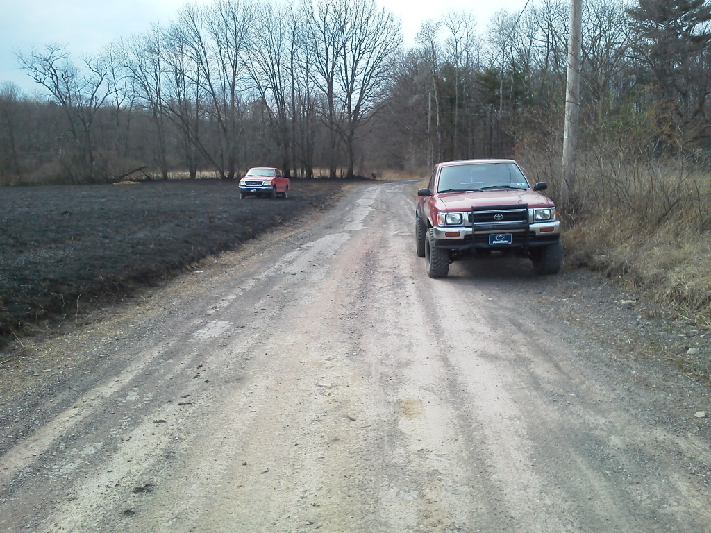

here's the pic.from where I am taking the pic, to about a 10 foot perimeter of my truck, is the only spot that did not burn. so someone made a good effort to protect my truck.
and the back of my truck

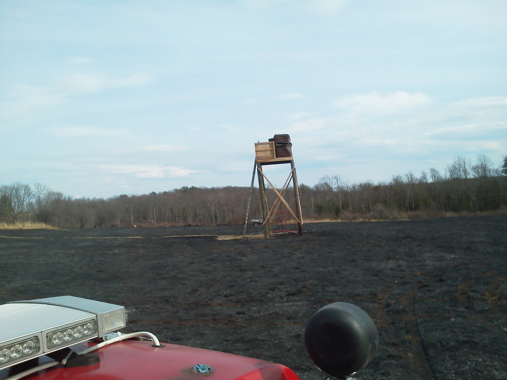

my view from up on top of our brush truck...this is a hunting stand. pretty heavy-duty contruction using utility poles as support. the top is melted.
whoops

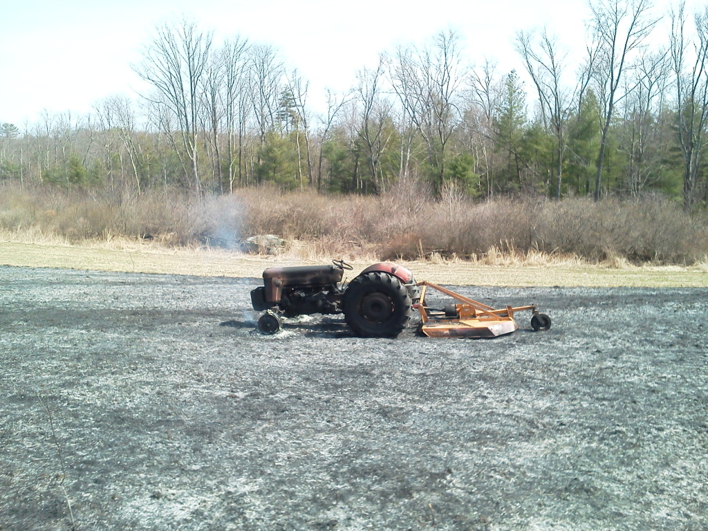

and 1 more
showing some additional apparatus and smoldering hay-rolls
whoops
and 1 more
