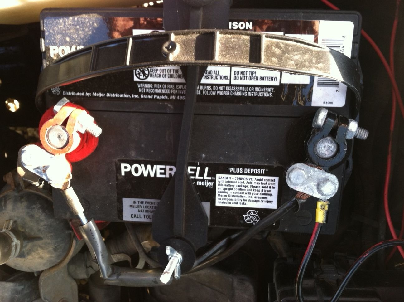

It happened again today where I turned the key and got a "click" instead of trying to start. It happened a couple times, then it seemed hesitant to start, but I did get it started.
The battery read 12.6v when off, and 14.14v when started, so it didn't seem to be run down.
I apparently have something other than a battery issue, but there's a picture of the terminals just the same.

Carry your multimeter with you. Next time you get a "click," measure the voltage right at the battery terminals. If the voltage drops below 12.3 or so, your battery doesn't have enough charge to turn the starter. If it stays about 12.3v, your connection to the starter (cables, relay, solenoid) has enough resistance to keep that 12.3v from GETTING TO the starter.
While you're at it, you can move the multimeter probes off the battery terminals to the exposed copper of the wires. Your problem could be anywhere, but those terminals don't look too well-made to me.
He's right, that type of connector should only be used as a Temporary Fix, not as a permanent solution. However many use those clamps as a standard fix only to have problems with corroded wires further on down the road.
Ultimately you do not want any bare wire exposed to the elements or corrosion WILL eventually start.
