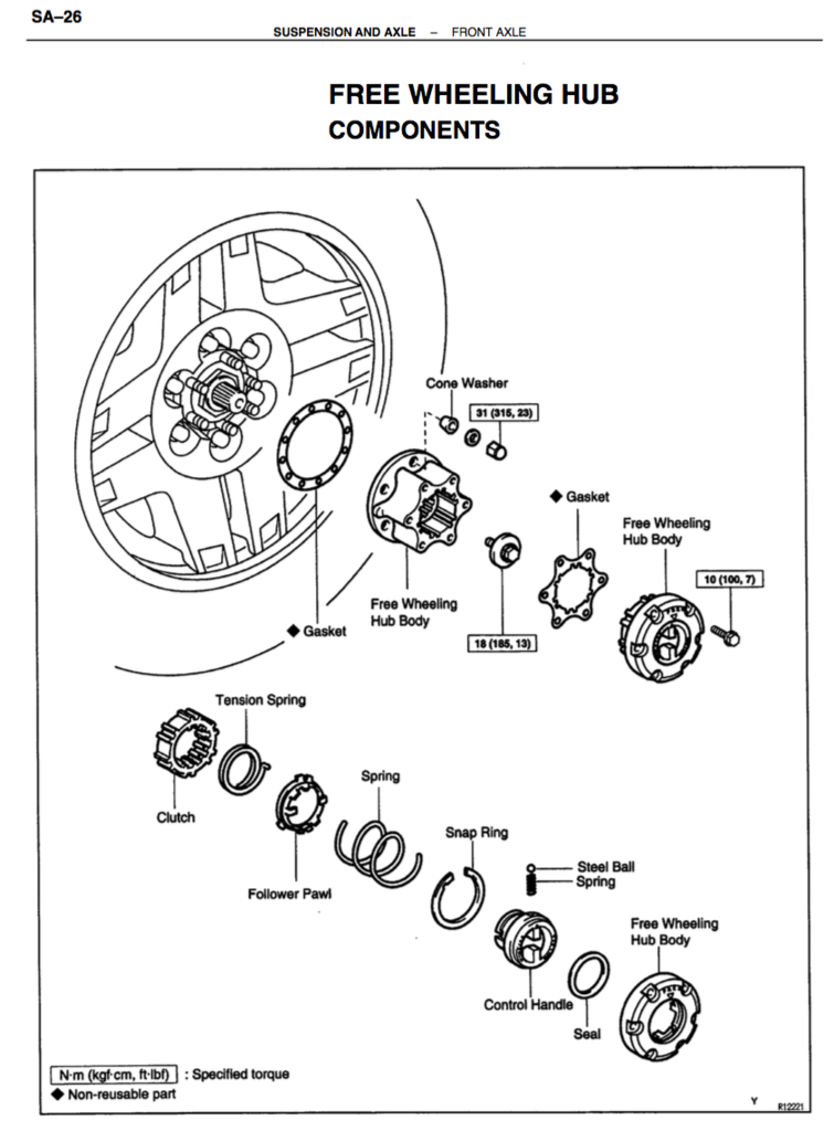

the word 'CLUTCH' throws people off, so see photo below

Always seen them as hub gears. Inner and outer (well at least on SFA) been years since I had IFS. But if memory serves they should both be the same, no left or right. Did you pull them from donor?

Sounds like he bought these Hubs in a box in pieces .
Maybe a do it yourself rebuild your hubs kit from a place in Alabama that will remain unnamed !!!
I would not call a hub gear a clutch either but Toyota has some different names.

Originally Posted by MudHippy
Weird. This shows that the slide gear should be the same in all versions. Now I have no idea where this one came from. I contacted the seller, he's sending me another one so I guess problem solved. Except the mystery about what vehicle it came from.
