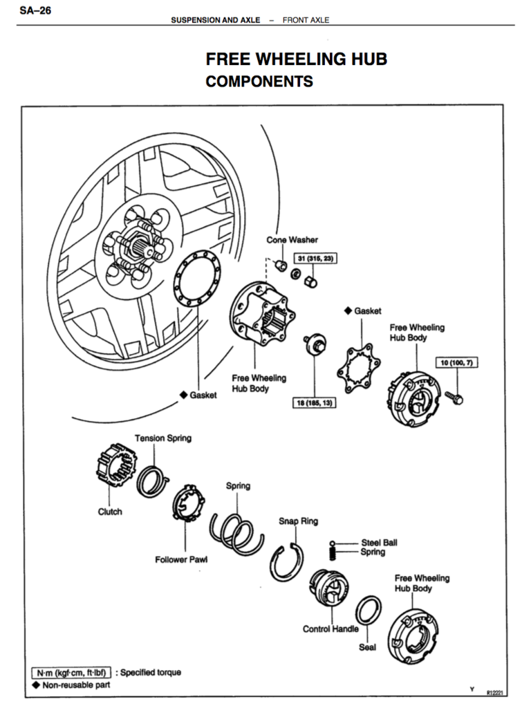

Its not really a clutch, but thats what the FSM calls it.
