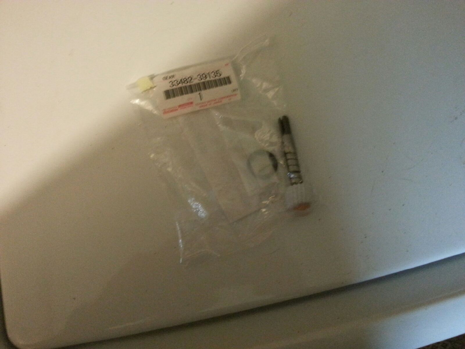

LOL true. The Toyota part number is 33482-39135
