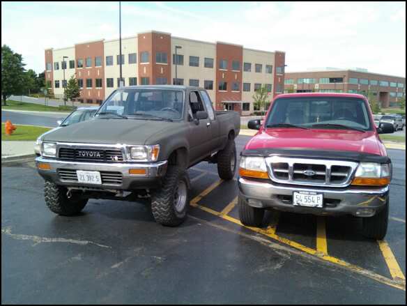

Check out my pics. I have a 3" BL on with 31x10.50x15's on it. Im currently waiting until these burn up to get 33's but the body lift will work fine. Some people like them some hate them. I just opted not to do a torsion bar crank because doing that will put alot of added stress on the T-bar and other suspension components. And Sometimes can give you problems later on down the line and possibly be changing out parts frequently. But do what you can afford and what makes you happy. There are enough people on here that will be willing to help you out. Let me know if you need any pics or advice installing the BL.

Right on man. Your pix convinced me to go ahead with the lift. I'll do the same and keep my tires until they go out and grab some bigger. I was going to ask. Does your truck sit level or is the rear slightly higher because my truck now sits higher in the rear and I'm not too sure if it already has had some work done to raise just the rear. I'm going to check it out a little better this weekend when I start on my lift
The rear sits slightly higher because I installed an add a leaf because of a little sag. But it really doesnt sit that much higher in the back. I say go for it man. Ill help any way I can.

Here it is sitting next to a stock ranger.
Here is was before the lift.
Let me know if theres anything else I can help with
